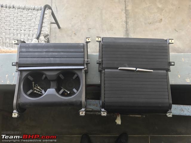

Life with a 2009 BMW X5 4.8is (E70)-imageuploadedbyteambhp1493219972.089531.jpg
The shutter for the drinks holder and ashtray
Was broken since I got the car . Found one on
Ebay . Changing it required a bit more work than I thought it would be
Life with a 2009 BMW X5 4.8is (E70)-imageuploadedbyteambhp1493220142.586992.jpg
Life with a 2009 BMW X5 4.8is (E70)-imageuploadedbyteambhp1493220166.821908.jpg
Life with a 2009 BMW X5 4.8is (E70)-imageuploadedbyteambhp1493220195.223795.jpg
The broken one and the good one
Life with a 2009 BMW X5 4.8is (E70)-imageuploadedbyteambhp1493220227.224121.jpg
Life with a 2009 BMW X5 4.8is (E70)-imageuploadedbyteambhp1493220247.138664.jpg
Tools , are very important if you do not want to get stuck in between
Life with a 2009 BMW X5 4.8is (E70)-imageuploadedbyteambhp1493220266.217895.jpg
Magnet tool for when you drop that screw
Life with a 2009 BMW X5 4.8is (E70)-imageuploadedbyteambhp1493220358.666829.jpg
Finally , all back in place and no screws left over
Life with a 2009 BMW X5 4.8is (E70)-imageuploadedbyteambhp1493220411.566524.jpg
