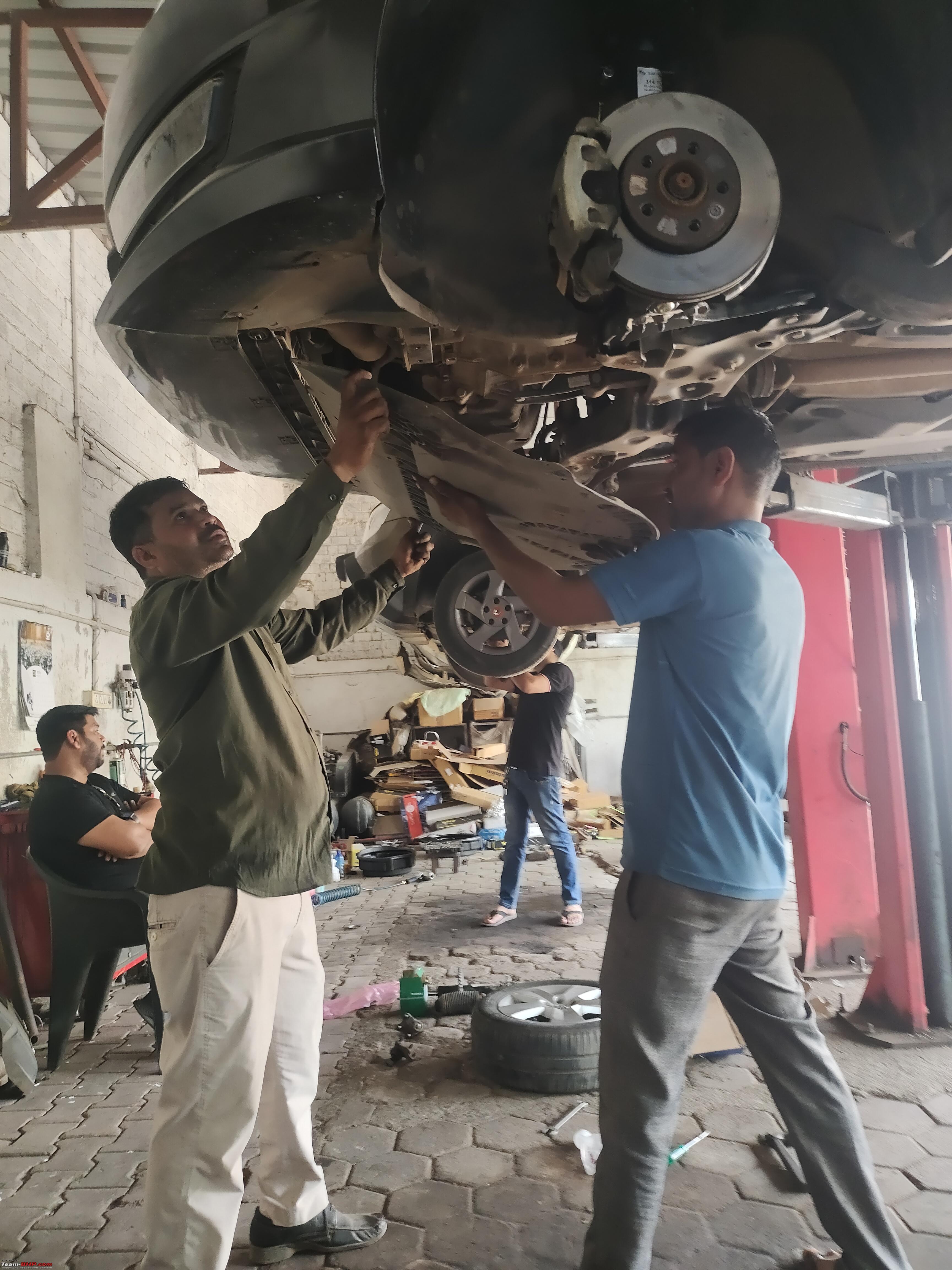

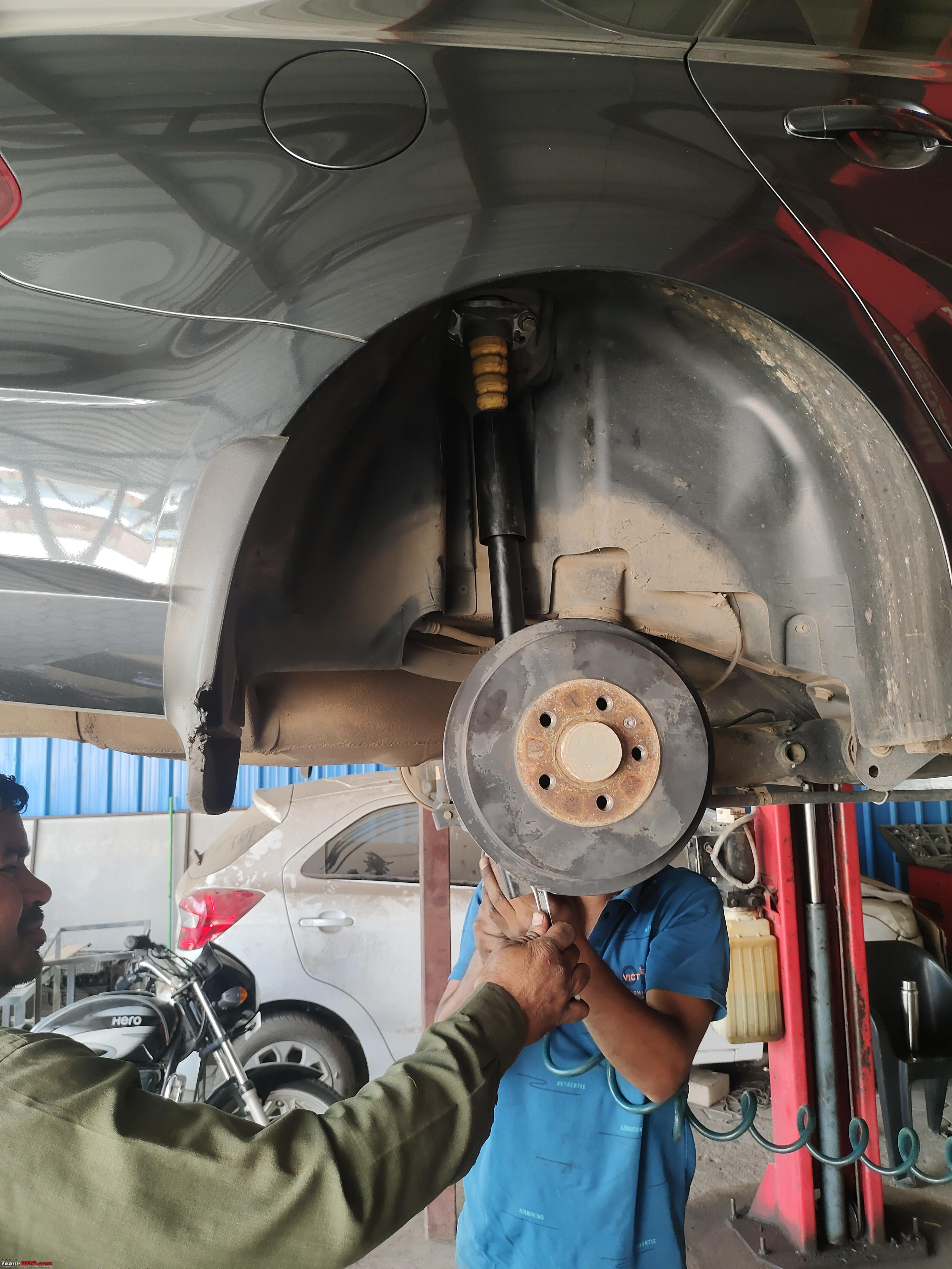

Life with a Skoda Rapid DSG | 6 years & 110,000 km review-4-shocker-removal.jpg
Removing the shocker
