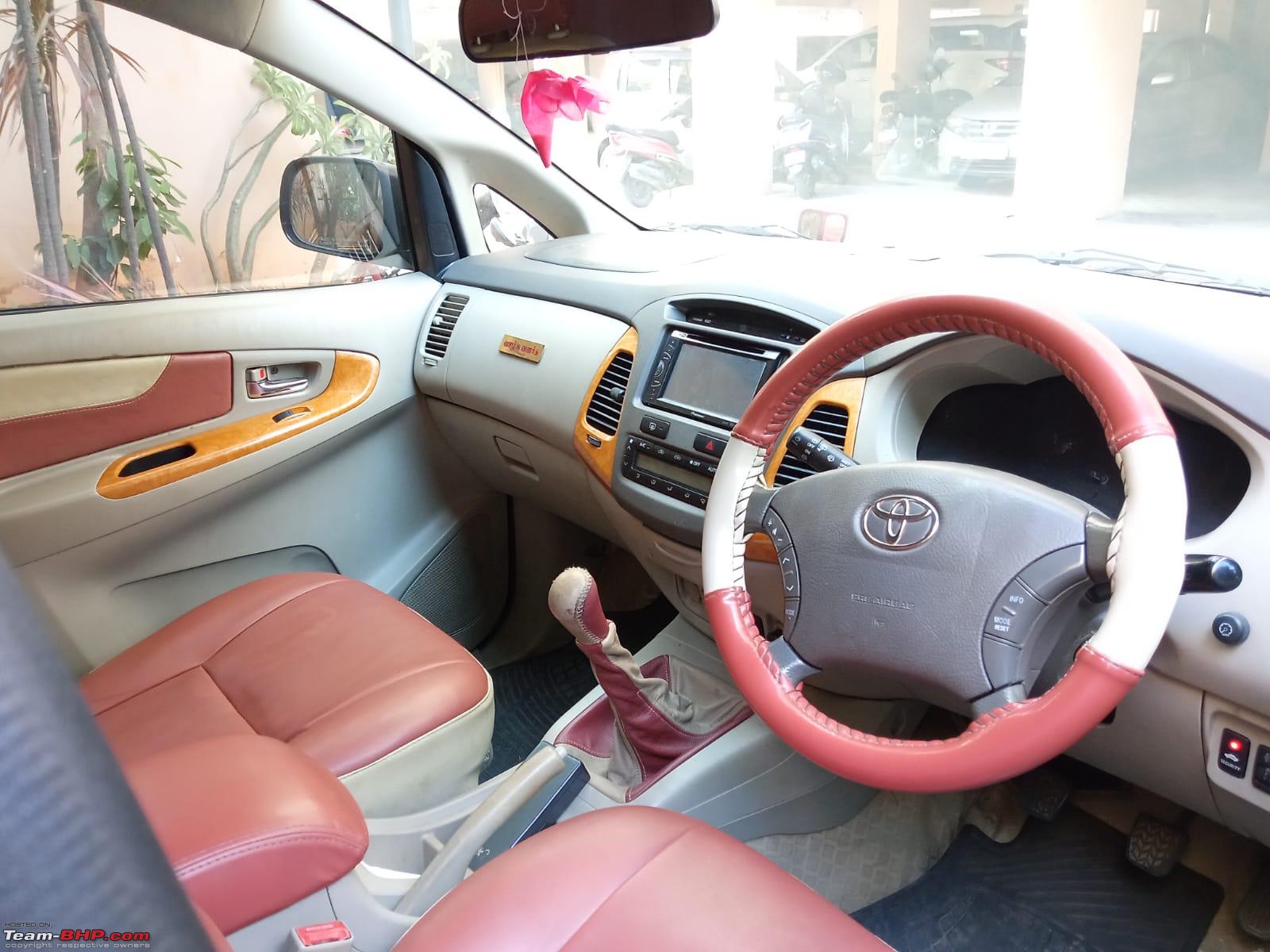

Inside view from the driver door
Bought a Used Toyota Innova with 232,000 km | Withstanding the test of time-innovared_driverdoorview.jpg
Inside view from the rear right door
Bought a Used Toyota Innova with 232,000 km | Withstanding the test of time-innovared_rearrightdoorview.jpg
Cabin views
Bought a Used Toyota Innova with 232,000 km | Withstanding the test of time-innovared_cabinview.jpg
Bought a Used Toyota Innova with 232,000 km | Withstanding the test of time-innovared_viewfrom2ndrow.jpg
