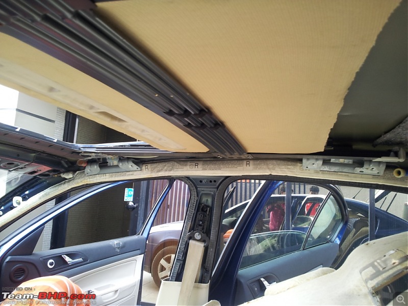

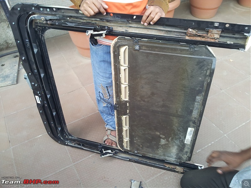

The snaps for the sunroof repairs
The Sunroof had stropped working; basically a metal clamp (or rather two - one on each side) had rusted and that caused the mechanism that opened and closed the roof to not work in the right manner.
Authorized centre solution - Replace the Sun Roof (entire glass roof and mechanism)
Got my local electrician to remove the entire top roof interior fittings and repair the mechanism using salvage parts from another Laura (the superb and octavia mechanisms did not fit) - Cost Rs. 12500.
The Snaps sadly do not show the refitted roof but that is as in a normal Laura and what they do show is the kind of open heart type operations one ends up doing to the vehicle, with the various cylinders and pistons of the Airbags being visible. The guy took almost a week to source and complete the job and getting the roof to fit correctly once the part was available itself took them 3 days. I guess a new factory fitted part comes perfectly alligned and one would need an expert mechanic to get this to work properly.
