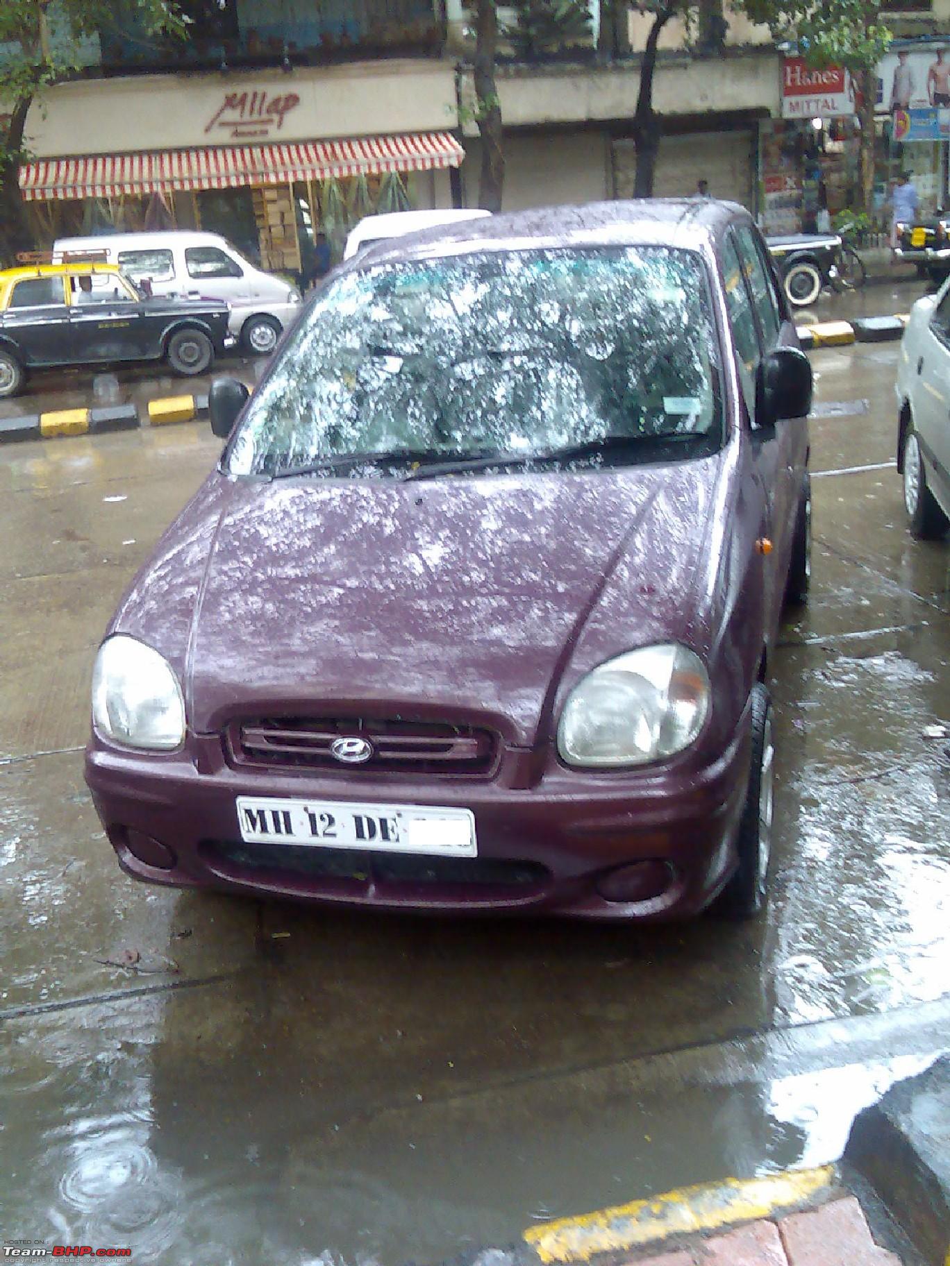

Missed this thread, great review. I have a 2000 model Santro LS ZipDrive (1 lit) at 76500 kms. Superb car, and engine is at its peak now. Changed shocks and did supension/steering/clutch overhaul at 58000 kms. My stock S322 tubetype tyres lasted 5.5 years and 34000 kms. For past 30000 kms I am on 5J alloy wheels, and also switched to S322 stock-size tubeless tyres (at 35 psi) 10000 kms later. My car is a Speed 97 addict for the past 20000 kms, and boy, does this car move! Yesterday hit 120-130 kmph in heavy rain from Pune to Mumbai and after exit toll gate of Expressway the car was consistently at 140-150 kmph, and not even in full throttle. Terrific pickup, superb handling.
Actually engine overheated yesterday, for the first time in 8 years, just after I had parked in Sion, Mumbai after driving from Pune (could see the temperature gauge shoot up, and hear the coolant boiling). Initially I feared the worst, for I thought that the overspeeding had finally bust the engine. But then I saw that the radiator fan was not coming on and kept the engine in idling (after checking oil level) with AC blower on and set to maximum heating (AC off). Temp indication came down to normal in 5 mts. This morning drove 6 kms to Hyundai Service with AC blower kept at full heating and speed at 40-50 kmph in 4th gear. Engine did not overheat. Found the cooling fan relay to have failed and replaced it for Rs 600.
I have asked the service guys to thoroughly check the engine cooling system, service the AC and also repair the one ugly dent on my rear right panel (over the tyre). Should get the car back tomorrow and looking forward to ripping her to Pune. I love to really pamper this car. Whenever the service guys suggested carbon cleaning/engine flush and throttle body/injector cleaning, I never objected. For the full life of the car I used mainly premium petrol (Speed). Here is a picture of my car, taken near King's Circle Garden (Matunga) in Mumbai, in the rain.
Is she a gleaming beauty at 76500 kms and 8 years, or what. Whoever said that the old Santro is an ugly duckling? Take a good look at her now, for you won't get much of a chance on the highway as she zooms past you.

Yes, I asked them to check everything and there was no problem with radiator. The cooling fan relay had failed and was replaced. I suspected that the AC was overloading the engine when car was idling and asked them to check that also. Car looks fine now and is back to its old self.
Regarding the timing belt, pulley et al, a thorough examination was doen and they belie their age. So is the case with the rubbers like the radiator hoses, the 'V' Belts etc., They still are supple and not hardened up or cracked, or show wear in any way. I was surprised to see the quality of components put in by Hyundai. Even on my insistence, I was advised against a change.
That is interesting. In my case the car has been pushed very hard every week on the Mumbai-Pune route and I might be better off with timing belt replacement at next service (now car has done about 77000 kms). Recommended replacement is at 80000 kms.
Overall, the suspension/steering components and every other individual component that went on to build this car was closely inspected for any wear, but fortunately didn't warrant a change and were as good as new even after 6 odd long years and 76,500kms on the ODO.
In my case shocks were replaced at 58000 kms. Steering column and clutch overhaul was also done then. But that is because I used to push this car to its limit around corners and also drove on very bad roads during the last 3 years (now they are much better). Right now the suspension/steering are in very good shape and I am careful not to corner too hard or hit potholes. Need to ask service guys to take a close look at wheel bearings, for I don't want to risk a failure on the highway.
Oh how I love this car for not making me pay through the pores of my body. So giving but less demanding.
I love this car too for saving my neck a number of times on the highway (superb handling and maneuverability) and for being so reliable and trouble-free. And absolutely superb engine, seems to be as good as new at 77000 kms and ever eager to rip at 140+ speeds on the Expressway.
