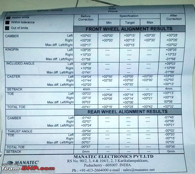

Sometime last month I noticed that, the tires were eating up asymmetrically and had feather wears. Mechanics at A.S.S said, it cant be done it cant be properly aligned.. i have set the toe.. 300rs please.
The same story with outside alignment guys, only work around, no diagnosis of the root cause with saying that camber caster is out and A.S.S is only place you can get it corrected, but it never used to happen at A.S.S. Someone also said, gaadi accident, chassis bent, upper arm bushes gone, bent and other crap and not possible. I guess i must have paid almost 3000 bucks on the alignment shops.
But then enough was enough. I had to get to the bottom of it because why would tata make a vehicle which cant have proper alignment.. Something was wrong. Some one is making jackass out of us. Hey, i am in mid 30's not old to have a weak shoulder cmon..
Managed to find the correct factory specs of Safari alignment from manual which are below (PS: This holds true for Storme as well. Saw it in mannual)
Camber 0° + 30´
Caster 3° ± 30´
Toe – in total 2 – 5 mm
LH to RH variation of caster to be within 45'
LH to RH variation of camber to be within 30'
If caster is off, vehicle pulling is the symptom
If camber is off, then it eats your tires.
PS: The tire pressure and the vehicle height needs to be as prescribed while during alignment
Anything out it is bad and has to be in specs for proper tracking of the safari.
Armed with information, went to A.S.S and insisted again I am paying for alignment, please get the specs in line to TML specs change the damn things whatever is bent and lets see.
Usual brouhaha but then slowly it took two-three hours to correct the specs in order. (Thanks to A.S.S Concorde to be patiently insisting the alignment guy at their workshop to get the specs correct)
A short test drive.. voila.. all in order. the safari goes straight like arrow.. no pulling, no longing, steers good. 200 km run, the tires when felt with hand feel smooth no nicks nothing on the tread.
So dear friends, please insist on getting alignment in order should they even deviate from the setting prescribed by Tata.
The guys want to work shortcut and make easy money without labor at our cost which makes me wonder that TML cars are kinda OK, its often the wrong diagnosis of alignment at A.S.S and elsewhere which screws up.
For reference i am posting the alignment details after correcting it on my vehicle. Note the correct camber/caster/toe readings. This requires correct shims placements and is a skilled labor intensive work
Perhaps i should have heeded to HVK advice and climbed on top of A.S.S to get the work done. Thanks to Nikhil @ blr too for helping out with much needed information.
Its almost 1 month now and few thousand kms and the alignment holds good.I have a happy shoulder now.
