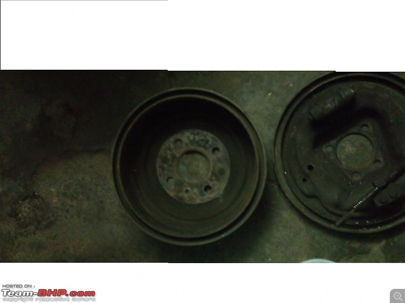

(.) A problem that one was unable to discern , had been gradually building itself up for quite some time. I had problems with braking for more than a month now. Whenever, the brake pedal was pressed; the braking in effect only came after pedal pressed more than half its depth. Initially, I thought it had be related with air in brake lines.Perhaps, bleeding the lines and change of brake fluid would do the trick. My preferred mechanic too concurred that perhaps bleeding would solve it. It did solve it, but only for some time.
Nevertheless,The problem came back on its own in the begginning of this month, but this time came at a moment when one was doing 80+kmph speeds on highway. There were 3 instances at that time when one required consistent braking and each and every instance it was inconsistent. Moreover, at one particular instance ,instant braking was required and all one could get was nothing even though the brake pedal was pressed up 3/4 its depth, one pressed harder on the pedal, then it came as if it[brake force] was stored to release at one given point. Result :the front wheels locked , the car came to stop accompanied with 'screeching' noise, and the 3 other occupants with me in the car at that time were a bit startled. Even though I maintained my composure, not to add to the fears of my fellow occupants that perhaps the car brakes had failed or were failing. I continued along the way back to delhi, but with speeds below 60 kmph and using engine braking most of the time. But, that instance highlighted to me that the real problem was the rear drum braking! It seems it wasn't adding anything--the rear drum brakes--when ever brake pedal was pressed. This conjecture of mine will be confirmed by my preffered mechanic with whom the car will be kept for repairs, next day.
The following day, my prefered mechanic said that not only the rear drum brake would require complete O/H, the rear bearings too would require replacement. He wasn't inclined to believe that I never realised that whenever car braked or car moving there was consistent noise from the rear wheels which would increase at braking. I think this time, I should be blamed for it since its negligence on my part. The instances have taught me ,well to be a bit circumspect in the future.
The repair job for rear-drum brake replacement and rear bearings:
Cost of pair of rear drum[outer concentric that houses brake cyclinder+adjuster+others] = 4800/-
Cost of pair of rear drum[inner concentric] = 5600/-;
Cost of pair of brake shoes + pads= 950/-;
Add brake oil cost = 150/-;
Cost of Pair of rear wheel bearrings= 4400/-;
Labour charges for rear brake O/H= 1500/-;
Labour charges for rear wheel bearrings change = 600/-;
The car had been with my mechanic for past 10 days, recieved it yesterday and one has driven it for 120 k.m since the repair. Seems to me all problems have been done away with, waiting for more to come in future!!!???
Photos of old parts, last photo of the car.
