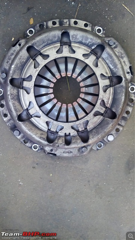

^^ A brief maintenance update for the white Corolla MT
Clutch replaced at 1,16,000kms after 13.5 years; OEM replacement clutch cover plus disc plus release bearing was 9k.
There were no scoring marks on the flywheel.
Posting images of the old cover plate and disc here.
