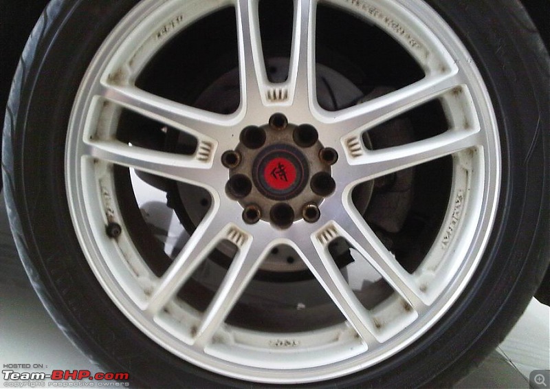

The exhaust is a custom 2.5" setup with a xforce Varex muffler. Flyhweel is clutchmasters and pulleys NST. I'm going to be upgrading the rotors to a better alloy, cant bother spending on bigger brakes as of now. Present rotors are: And I guess the camera had some auto volume leveling which decreased the sound at high background noise. The growl is indeed to die for at high rpms, especially from the outside.

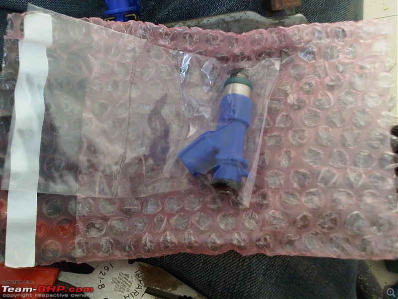

Bigger Injectors

Now, the injectors are in and so is the intake manifold.
I didn't get time to go for a spin except the distance I drove from my workshop to back home. The intake manifold requires tuning, so cant really comment on it to the point yet. However, the initial observation was WHAT THE ....!
At low rpms, it doesn't really make much noticeable difference. However, when the rpms open up a bit, oh my! At redlines, it felt as if the car wanted to go on and on but was being forced to stop. I did 2-3 redline pulls and the intake manifolds given a new aspect to the engine. I never regretted a rev limiter in this car before, but now I think Ill have to think of an option.
The car idled for around 20 mins at my workshop before I drove away, and even after reaching home, I didn't find a CEL. This has been the case with many R18 intake manifold installers. I think that the problem owes to the correct assembly of the variable length runner motor. I coudln't find detailed instructions on the correct assembly of this motor while installing, and half of it was pure logic. So, I guess Weapon-R did make the correct product but forgot to include good paperwork with it. There is still a possibility of the CEL coming up later though. Scangauge would be to the rescue if it does. Tomorrow, or the day after is going to be the tuning day. Would be able to give more detailed reports after that.
