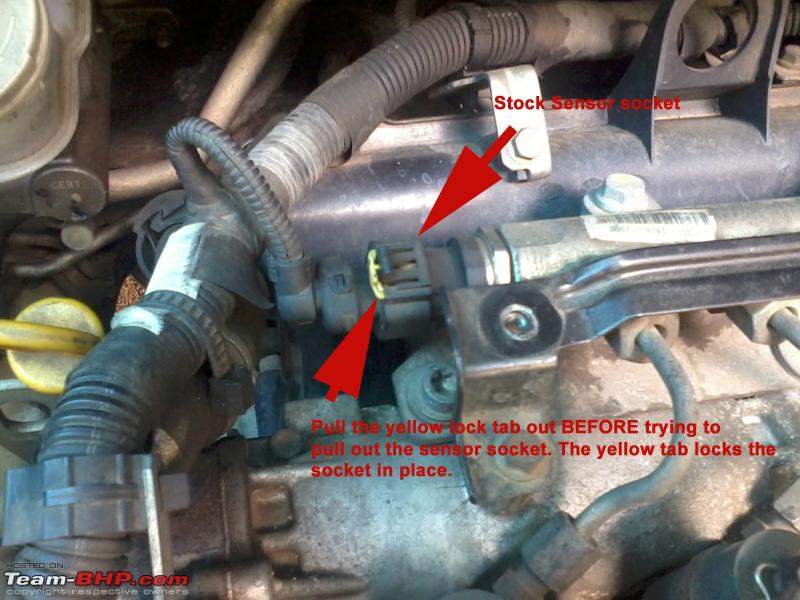

Engine cover removed and the common rail sensor location
Closeup of the common rail sensor and the stock connector. The stock connector has a lock which is the yellow piece indicated in the picture. Pull the lock out before attempting to pull out the sensor connector.

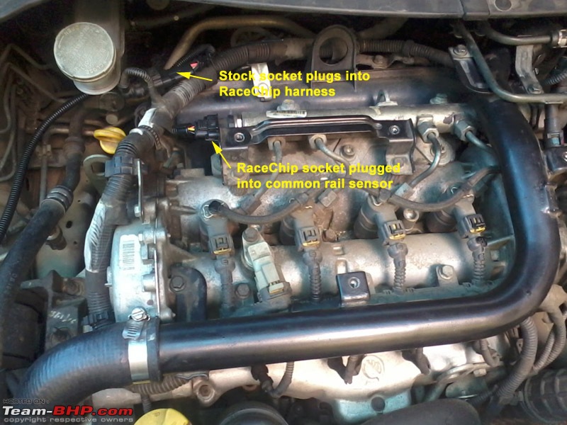

Here is the wiring harness supplied by RaceChip.
RaceChip wiring harness connected.

Routing of the wiring harness
