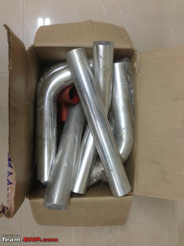

The entire charge piping will which is currently stainless steel is going to be swapped with Aluminium. Looking to cut down front end weight by atleast 3kgs.
Race Dynamics' Baleno Build-up: ITBs/Turbocharged - Re-dynoed @ 256 WHP!-image3946311398.jpg
2.5" Lightweight Aluminium plumbing
Race Dynamics' Baleno Build-up: ITBs/Turbocharged - Re-dynoed @ 256 WHP!-image1033717830.jpg
No cutting/welding required, pre-bent pipes replace existing stainless-steel ones.
