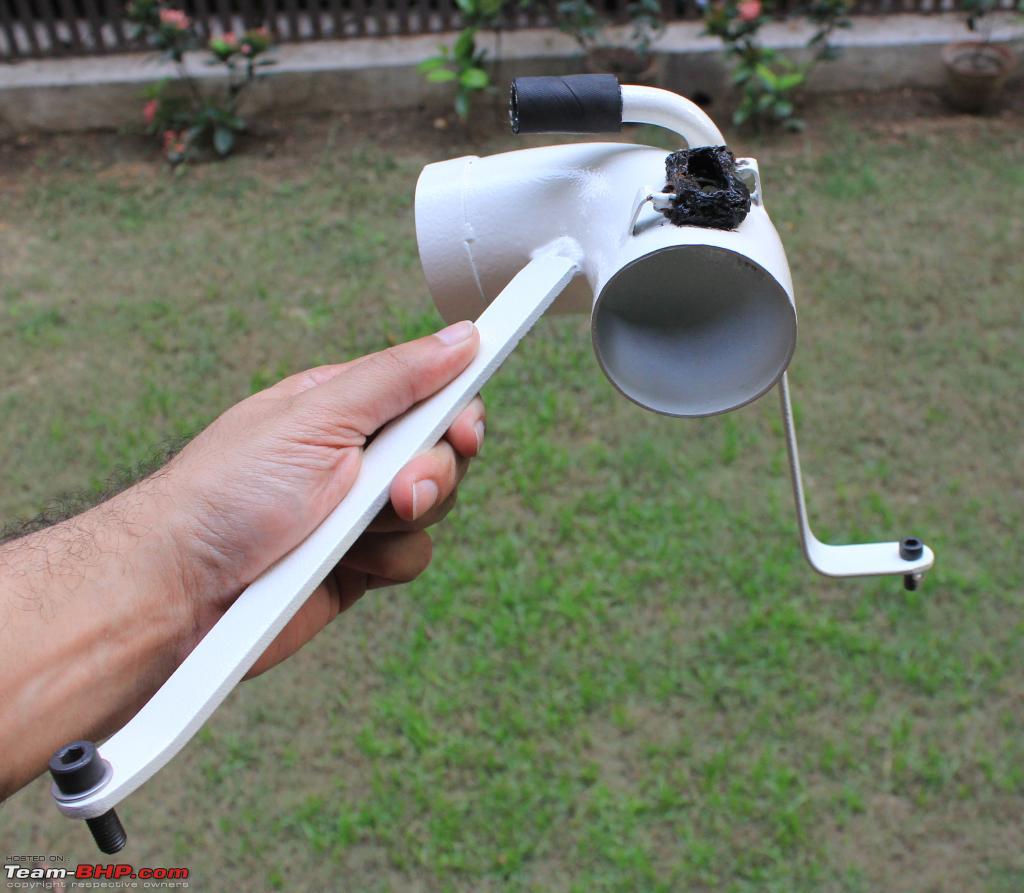

This is the custom piping – as you can see, it’s really a very short pipe which allows for the shortest possible route (with only one bend) from the air filter to the engine. There’s a slot for the MAF sensor. This piping is only for the Civic automatic – the manual one has slightly different mounting points. While the filter remains the same (universal, up to a certain engine size) – the piping is customised for each car.
Review: (Affordable) Performance Air Filter by G-EP-custom-piping.jpg

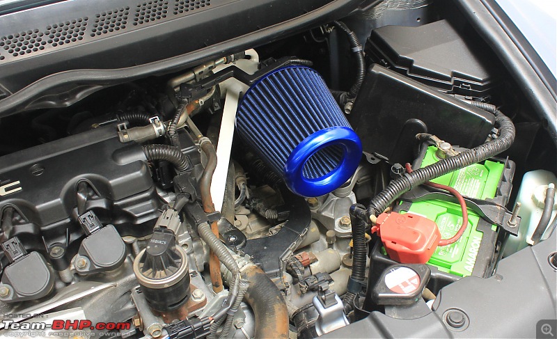

Finally, here's the filter installed on the car. The custom piping is held in place with new bolts (provided) and the existing hose clip (circlular clip) forms a tight seal. The existing breather hose also fits right into the custom piping.
Review: (Affordable) Performance Air Filter by G-EP-filter-installed.jpg
A close up of the filter. The filter element itself attaches to the custom piping with another hose clip (provided)
Review: (Affordable) Performance Air Filter by G-EP-filter-close-up.jpg
So - here's my initial feedback, soon as the filter was installed.
This was morning time, so it was a completely cold start. The engine sputtered and didn't start up on first crank (it never does that). I think it took a few seconds for it to adjust to the higher volume of air. Second try, it started up fine. Not much change in engine idle sound and there are no errors or warning lights.
Rev the car in place, and you get a more 'raspy' sound above 2500rpm. This is because the bonnet is open. Rev her above 4500rpm though and you can distinctly hear a roar and a new 'air suction' noise. Sweet!
First spin: it may be psychological to some extent, but the car instantly feels 'lighter' - as if I have to press the accelerator pedal less to achieve the same speed. Driving around normally, keeping it below 3000rpm, there is no sound. Not much of a perceptible performance improvement either - apart from the 'lightness'.
But put her in 'manual' mode and start revving past the 4500 or 5000rpm mark - that's where you can really feel and hear the difference. I think the price spent was well worth it.
I'll be putting up some videos soon.

Originally Posted by Ace F355 View Post
Nice Review Dynomite!
I think the only thing differentiating this filter and the Typhoon is the size and the heat shield that you get with the K&N. Seems like a good VFM if it really adds to the performance of the car.
With current condition of rupee, I have no doubt on Typhoon becoming a bit overpriced. I remember I got mine from around INR 8800 or so from the US.
Thanks Ace - though there is a slight difference between the K&N 69 Series Typhoon and this - this one is a dual cone (there is an outer and an inner cone). I've seen the K&N - the G-EP filter is also a bit larger in diameter (speaking only for the Civic of course).
If I remember correctly, the Typhoon is about Rs 18k (price from Indian K&N dealer). Your price was a steal!
