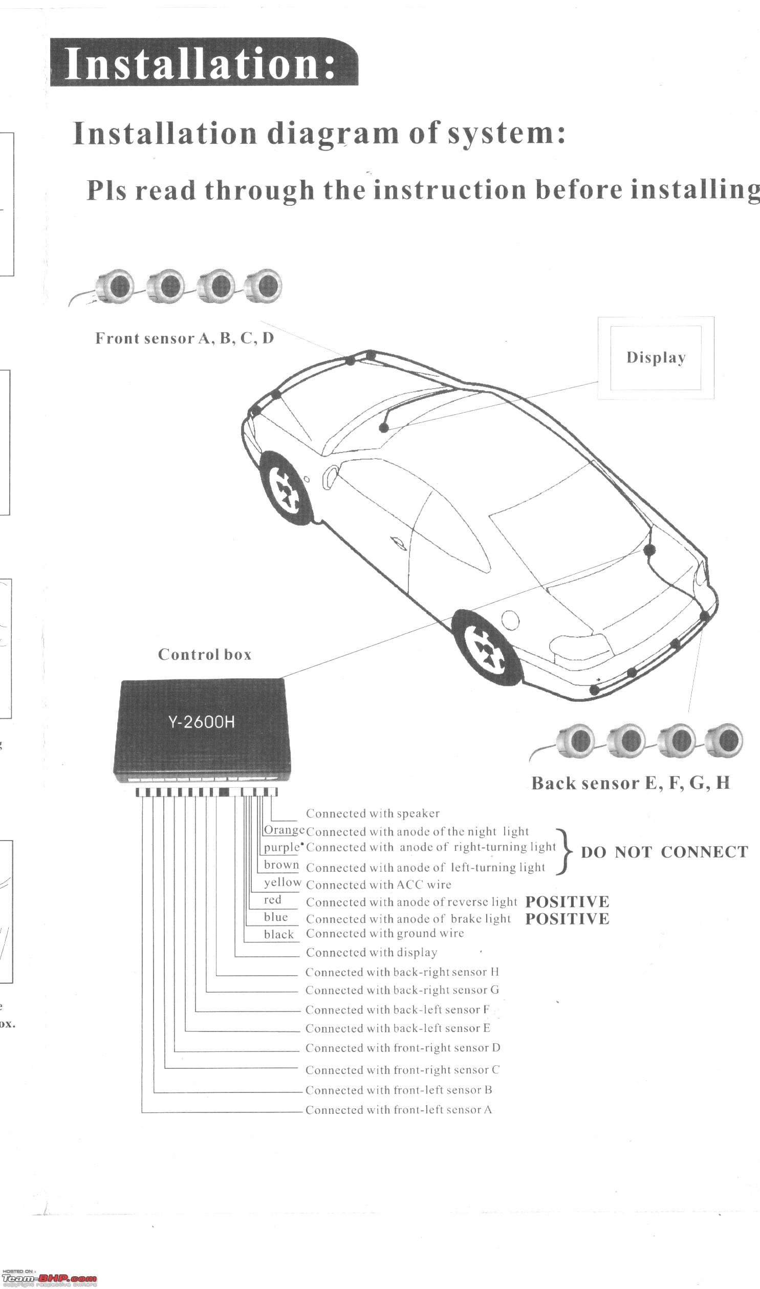

From what is seen here, this system supports 8 sensors (as per the booklet), but comes with only 6.
