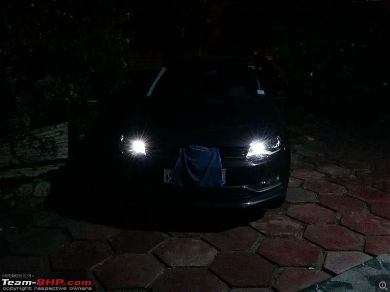

I did the front Park lights and also the Front Indicators on another day. As i was in a bit of a hurry i didn't take any detailed photos. For the front light install the headlight assembly has to come out. Its removed by unscrewing two Torx screws on top that hold the headlight to the car body and pulling the lights out at an angle. Use T25 torx bit for the screws. There are no screws for the bottom as the light assembly is held in place by a wedge clip at the bottom. For re-installing the headlight just align the lights to the body and push it in. The top screw holes have to line up and the bottom clip will wedge itself in.
For the park lights i used the Philips 4000K W5W LED exactly like the ones I have used in the rear light cluster for tail lamp. For the indicators i have used the Philips PY21W LED which is used at the rear tail light cluster.
Front park lights - 4000k Philips LED

Thanks Vik0728. Logged in after many days recently so apologies for the late reply.
The turn indicators on the outside do NOT flash vigorously (its called hyper flashing) when i put the LED bulbs in them and i am not using any resistors in the Polo.
However the turn signal indicator in the cluster does hyperflashing, by doing that its telling the driver that one of the bulbs could be blown. I have let it be because on the outside the indicators are working normally and i really don't mind the cluster indicator flashing twice as fast.
