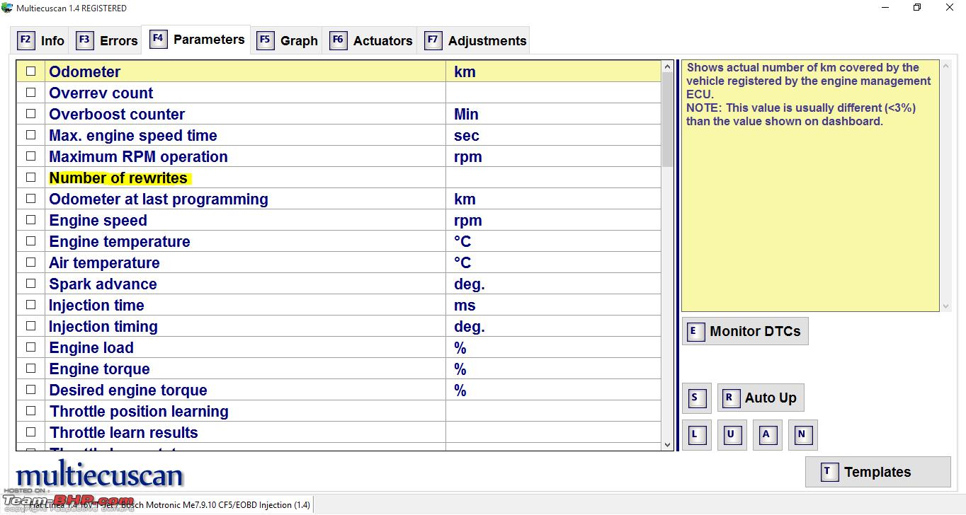

Originally Posted by amritpal2489 View Post
Technology sure is changing.
Can anybody confirm if this thing works on our National Engine (Fiat 1.3 MJD) used in Ciaz???
Originally Posted by mmridul View Post
@sankar, quick questions
1) Since you mention that warranty is such an important factor, is the remap not detectable at the workshop? (i.e. even when the stock map is loaded, doesn't the MD5/ SHA256 signature change to reflect the fact that the ECU has been tweaked/ played around with)
The national engine, FIAT 1.3 MJD has a counter, which increments with every flash. Unless there is code to reset this value, a remap is very easily traceable.

Just a peice of information on Remote Remap via cloud services and clearly a technical input from a nonIT person.
Iam on a board of angel invester for some startups.during last 2 years we have had about 9 startups come up with the services. And we have 2 ECU and Tuning experts on Technical Evaluation Board along with 3 people incharge of OEM Auto testing services.
Based on the below technical advice from our technical panel,we could not invest as the ROI is shaky and Risk Categorization was making it unfeasible due to OEM Auto warrenty rejection based on auto forensic patterning done by every Service Center,as these values are marked in logs and are self explanatory for any engine work to be done.This was confirmed by about 6 Car Mfg on about 52 models since 2012 manufactured vehicles.Below is a cut and paste of the inputs received. Sharing in good faith what could be shared without violating norms.
Every time a rewrite is done,this is marked by a counter update and a checksum rehash on EGCPL counter.There is also a register markup on FlashWrite TPNC running Flag.This is done on multiple register values based on manufacturer and model make.All of them are there on the Logs with obsifucated values.

Do you mean remote flashing of the ECU will be a highly risky and dangerous; i actually do not get your point from the report.
Also what if you reflash the stock map to the ECU and send it to the show room for warranty claims' e.g. to fix a bad fuel injector.
I cannot see any other parameters apart from the permanent flash count logged in the ECU that might help VW or another car maker know that the ECU was running a Remap.
