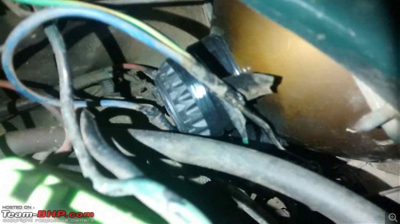

I was expecting a straight forward installation, but turned out to be a 2 hour work. Old M800 comes with a press type H4 base it seems. See pic below.
So we had to fabricate a special lock to keep the new bulb on to the reflector. I took help of my neighbourhood auto electrician as my lower back don't allow me to bend and do these jugads anymore. Since the bulb is waterproof, we left it with simple black insulation tape. At the end, bulb is attached to the reflector pretty tight.
In this picture you can see that the original connector
For normal H4 connectors, this should be a direct plug and play. Make sure that your car bulb backside clearances are measured and checked against these type of bulbs before you order. Also note that the rubber covering seen behind the H4 bulb clips cannot be fixed once these type of bulbs are put in.

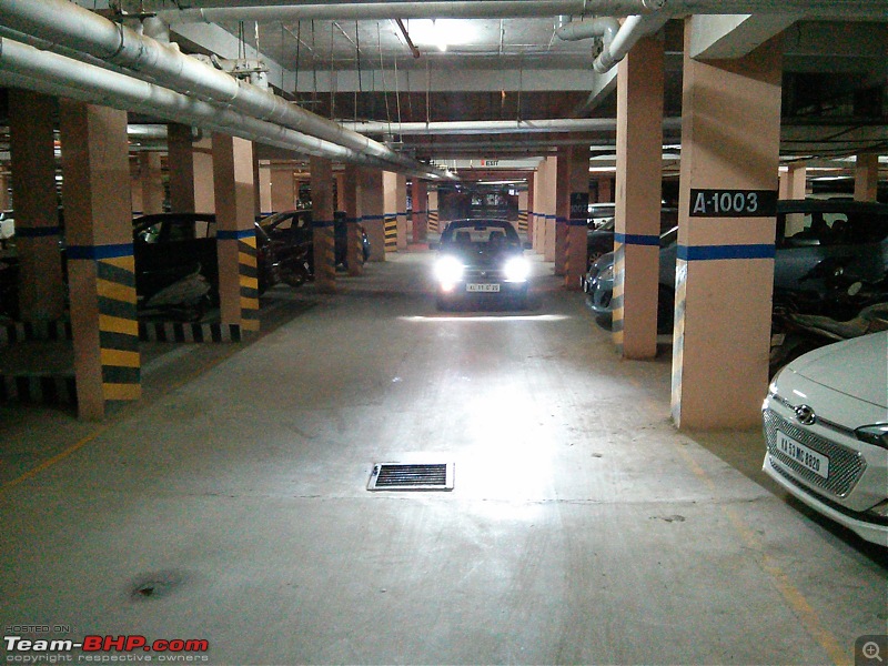

Output:
Light output is satisfactory at the most. There is an inherent design problem in the bulb I selected - It has LEDs only one side. This means that if the LEDs are pointing upwards ( as in my case) then only the top half of the reflector will have light to reflect. This means only half area of illumination in front. You can see from my pics that the area right in front of car is heavily illuminated, illumination at a bit forward (say 40-50 feet) is just enough.
So the ideal mounting position is to have the LEDs aligned in a vertical direction. Or buy a bulb which has LEDs on both sides.
Second problem is the weak highbeam. There are 3 LEDs on the bulb, each 10W. The two ones in a row are for low beam. They will be ON always. The third one will be lit only when highbeam is ON. What this means is that only 10W is used for lighting the road far ahead, which is not sufficient.( compare this to all 60W available for highbeam in traditional bulbs)
Since I plan to use this car only within city, that too on roads I know very well, I can manage with the problem. But I cannot take the car for high speed or highway driving with these bulbs. I plan to change the reflectors of my car shortly so that I can play around with the bulb mounting.
The below pics are taken with camera in -2 Exposure mode to show the beam pattern.
Low beam
High beam
Glare to oncoming traffic is similar or less than traditional bulbs. Focussing was pretty OK.

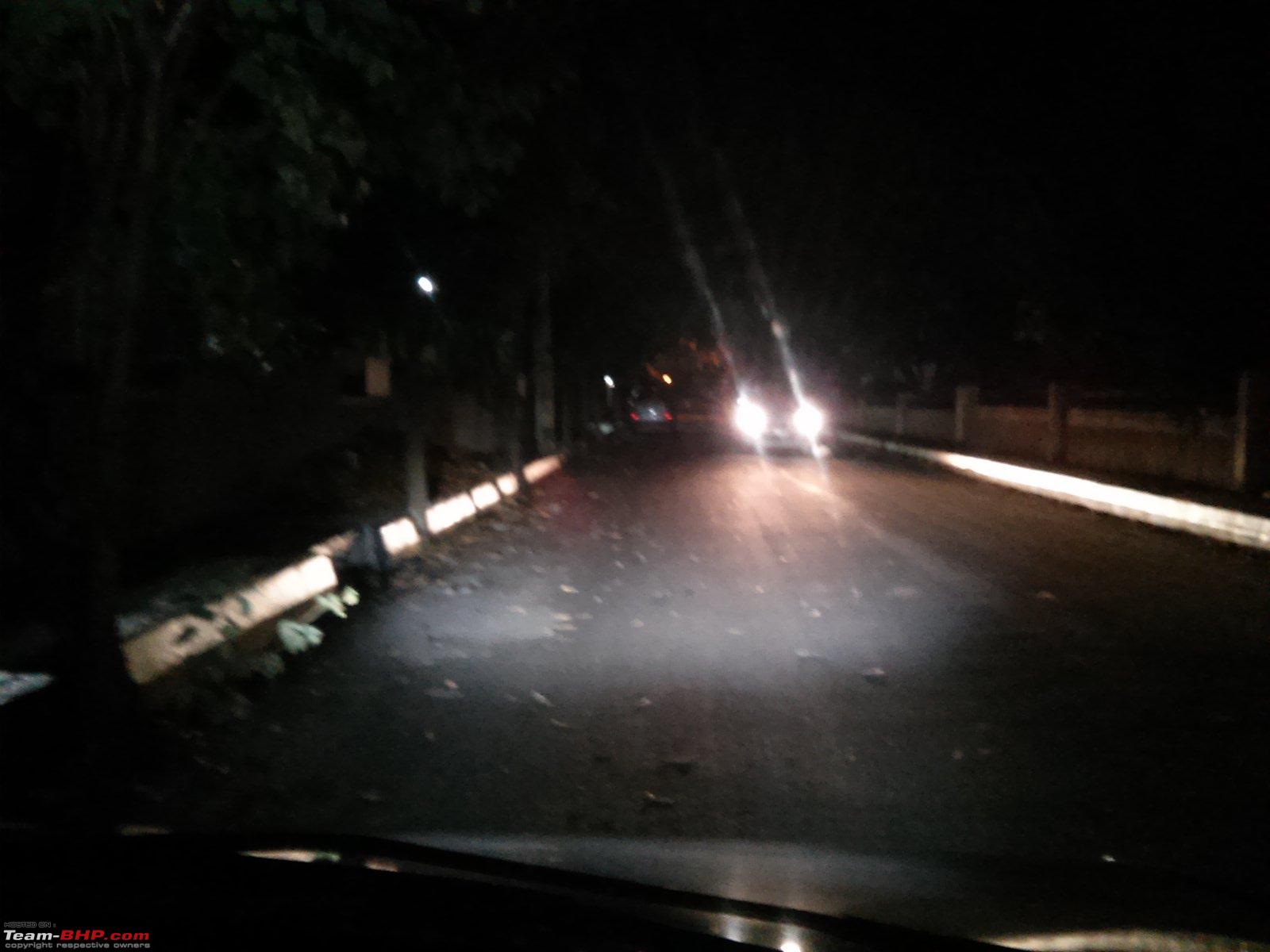

The below photos are for Indicative purpose only and taken with a low end phone in manual mode. Please dont use the photos to judge the light intensity
Low beam
High beam
High beam against an oncoming vehicle

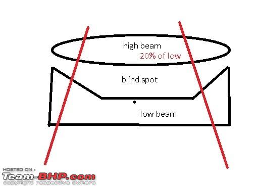

I have both Philips Ultitron in my brothers cruze and Chinese LED in my S-Cross
Philips Ultinon is way better in beam pattern - same as normal Halogen while giving light equal to 35W HID. Visibility is an issue during rains. Chinese one is almost twice as bright than Philips,rated at 80 watt
Visibility is never a issue but high beam is very weak, It has a fan at the back which causes radio interference and FM does not work when lights are on. But they have been going strong for the last 4 months and performing better than I expected at around 2000 INR. The beam pattern is very bad in high. It has a huge blind spot in main center, so Its only better for low beam.
I did a lot of research on LED bulbs before ordering Philips.
Now Chinese have much better options where design is copied from Philips and have Philips Lumiled LED. Where Ultinon are rated at 30 Watt, Chinese have option of 100watt. I believe that I will purchase those now if needed.
I have made a beam pattern graph for Chinese LED, will also try to take pics and post.
Cost wise Philips is very expensive, If Chinese LED are able to deliver the same beam pattern, They will be awesome.
@arjithin you need to cut the rear rubber cover from inside so that LED can fit. If you leave it without any cover dust will accumulate inside lights.
