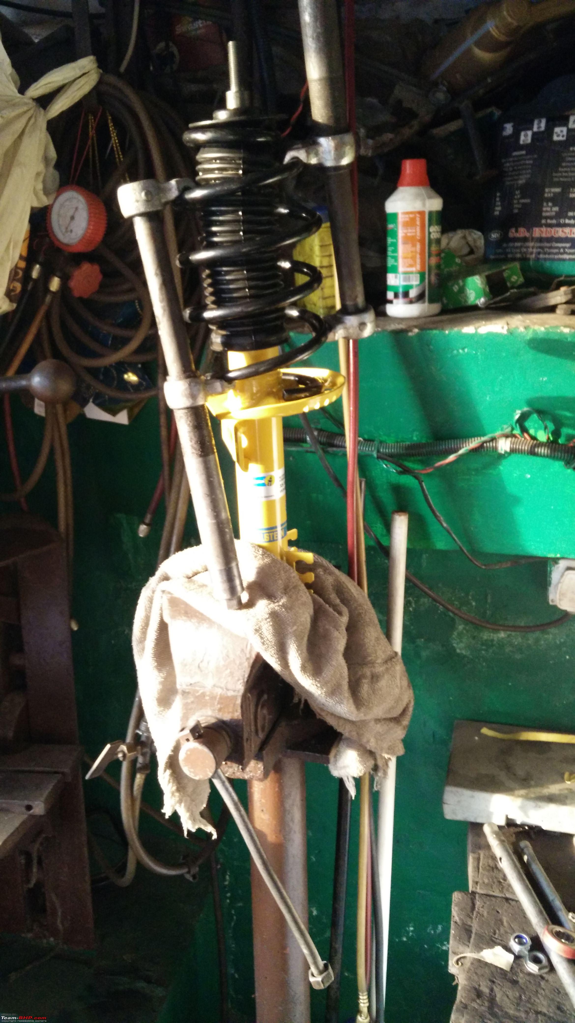

So, got a long pending modification done – the Bilstein B6s on stock springs.
Why B6s?
• Positive experience in an Octavia and the Saint’s Polo TSI and 320d
• I hate slowing down too much for potholes – wanted GC – so, no coilovers, no lowering springs
• I want ride quality AND handling AND peace of mind
• Tough, proven build
• Functionality paramount, looks secondary
Damage
• Rs.33.5k inclusive of shipping (seller in UK)
• Rs.4.5 k customs
• Rs. 2K installation at my local garage
A fun fact, my stock suspension had only 30% life remaining – the rebound damping was really slow. Just 2 years and 12.5k in Mumbai’s potholes roads can do this!
After 10 days of usage now, there’s only one overriding thought – why did I wait 2 years to get this done?
My observations:
Ride Quality:
• Medium/High Speed – no bobbing on undulations. Murders potholes, expansions joints – a true magic carpet feel.
• Low Speed – stiffer than stock below, say 30 kmph. You do feel the road a little more. However, it’s not trashy or harsh.
• By the way, the ‘phuss phuss’ stock suspension sound is now history!
Handling:
• Complete transformation. Very little roll. Car feels very, very eager to change direction. Having experienced KW coilovers in a GT TSI, I’d say, 75% of them. For absolutely ridiculous cornering limits, I felt the coil overs were better.
• What used to be hairy in stock is like a walk in the park with these.The handling threshold has been upped significantly. It’s ridiculous, how quickly extreme cornering becomes the new normal.
• I’m acutely aware now of the dimensions of the car – tough to explain this, but it feels you know exactly where every corner is. The car feels like a very controllable toy.
• I’m swerving and avoiding potholes much, much better!
Steering Feel:
• ‘Tighter’. Little movements of the steering wheel now result in a directional reaction – even off the ‘centre’
Negatives:
• The ride height I think has actually slightly increased! The wheel well gap has perhaps increased - it looks as bad, if not worse than stock! I have no idea how they do their magic with the same/increase GC!
• Some of the dashboard thuds over expansion joints, while they have softened, have not got completely eliminated. However, I hasten to say, it’s a vast improvement over stock.
• Carrying so much more speed into corners, that brakes have started to feel really insufficient, even with brake assist set to early.
Overall:
• A very sophisticated ‘Teutonic’ driving experience and feel.
I’ve only now begun to appreciate how rewarding great handling can be (loved my family’s Ikon 1.6 Sxi, but this is at another level). I feel for a city like Mumbai, it’s tough to find a better car for “city storming”. A combination of the right size, DSG, paddles, remap and B6s = sleeper magic. Potholes? Bring them on!
I’ve now resolved that for my future cars, the first modification I’ll do would be suspension. Everything else can wait.
VW Polo: Bilstein B6 dampers on stock springs-img20161122wa0020.jpeg
VW Polo: Bilstein B6 dampers on stock springs-img20161122wa0016.jpeg
VW Polo: Bilstein B6 dampers on stock springs-img_20161122_155847.jpg
