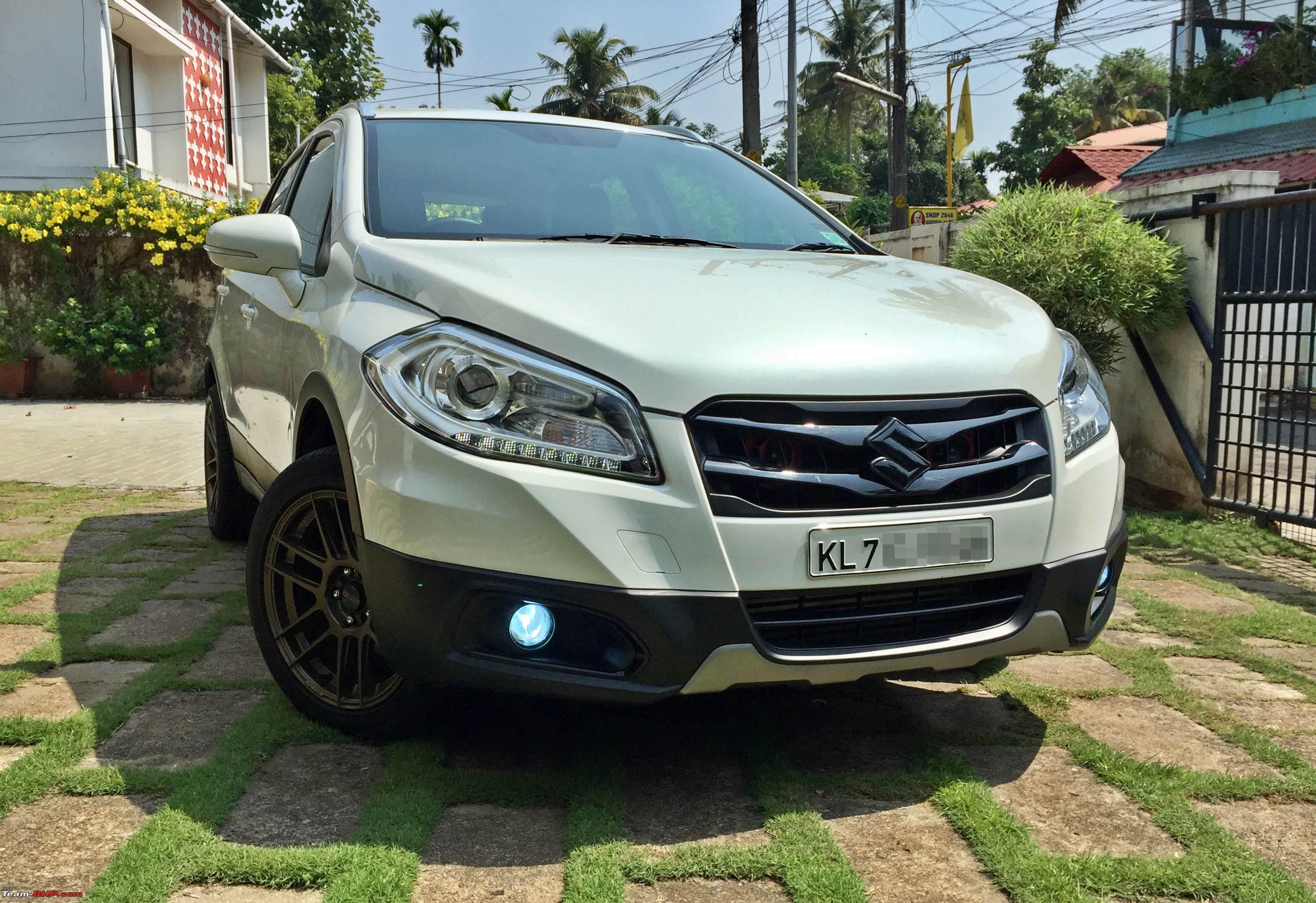

Mod 1 : De-Chromed Grille
The car was already looking funny with the out of proportion headlights and on top of that, a huge chrome grille? No, thank you! I'm not a fan of chrome.
There was a sticker shop just adjacent to the showroom and I had the grille wrapped in Satin Black, before delivery itself.
Pandamonium : My modified S-Cross 1.6-grille.jpg

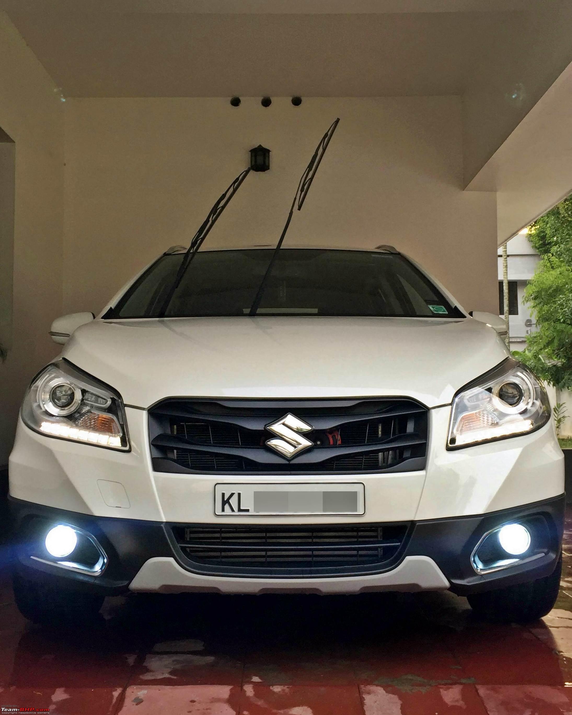

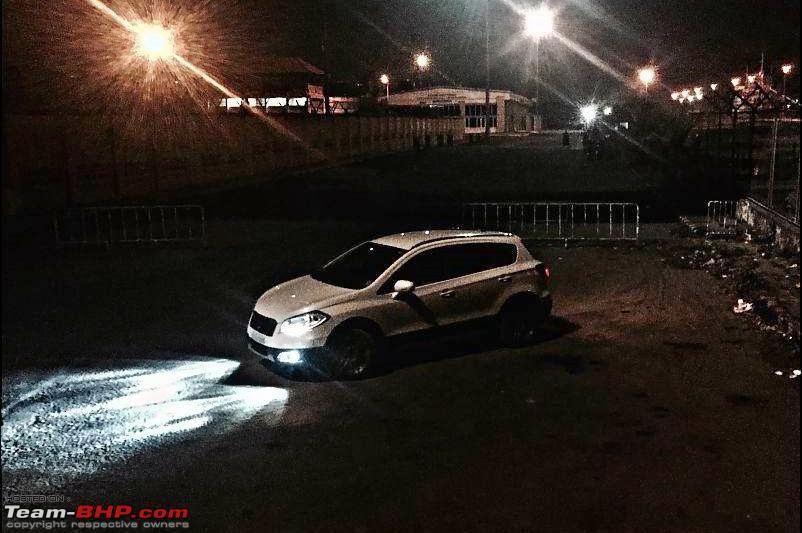

Mod 5 : Lights
The output of the stock headlights is a joke. It's fine on narrow roads, but once you get on the high-ways, it's almost as if there are no lights. S-Cross uses D5S bulbs. They're quite hard to get and the only direct replacement is Morimoto D5S bulbs which are quite expensive and has to imported from U.S.
Spending so much wasn't an option, so I got HID foglights. Some Chinese brand. I'm not sure about the colour temperature. Well, it didn't make much difference, to be honest. At least, it looks good!
Pandamonium : My modified S-Cross 1.6-front-only-fog.jpg

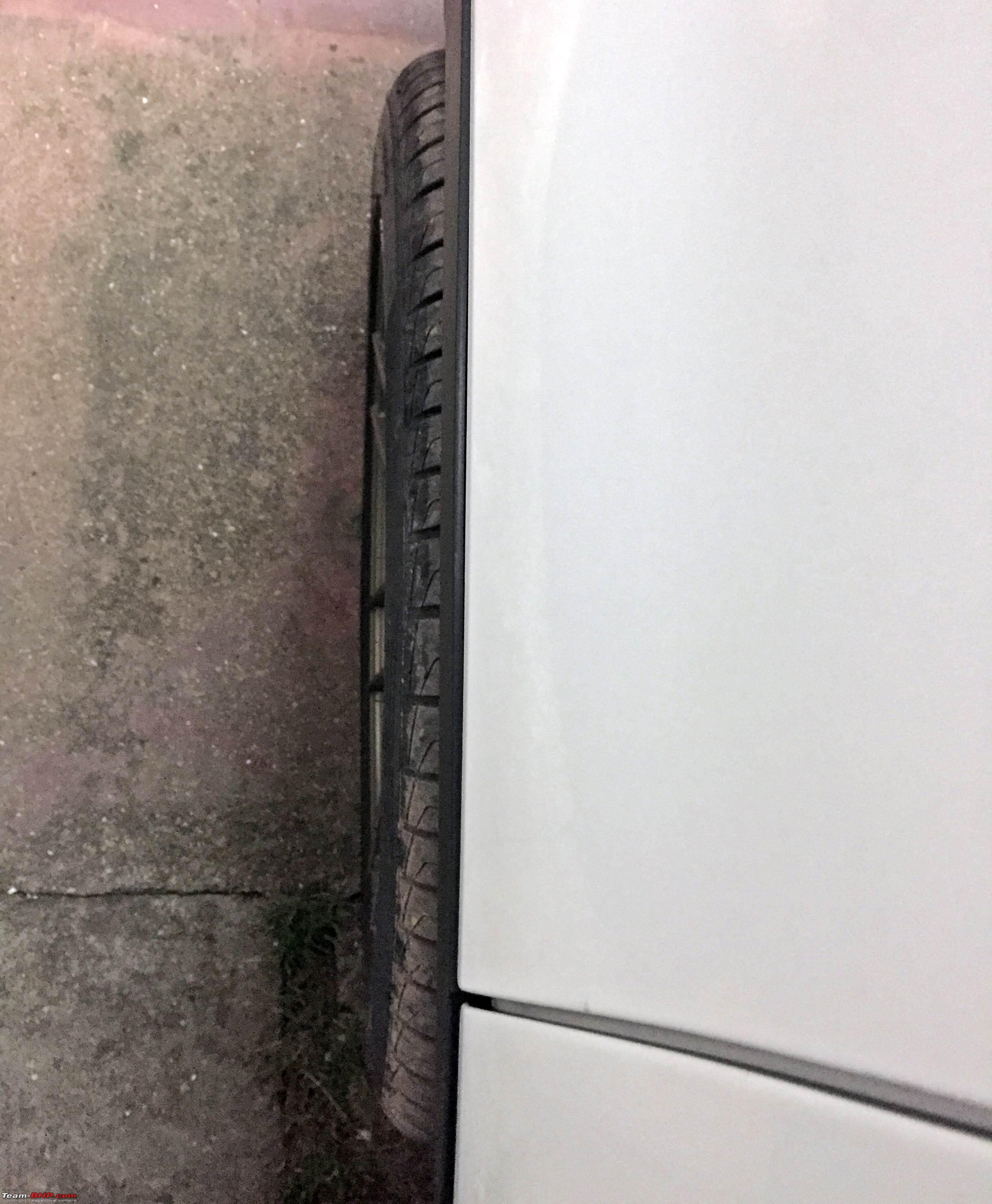

Mod 9 : Wheel Spacers
The upgraded wheels were tucked in the rear fender and looked puny. So got 20mm spacers, with studs, for the rear wheels. Hub centric rings were required for the setup.
Pandamonium : My modified S-Cross 1.6-rear-track.jpg
Without spacer
Pandamonium : My modified S-Cross 1.6-spacer.jpg
Spacer along with the painted caliper
Pandamonium : My modified S-Cross 1.6-rear-track-spacer.jpg
With spacer
The stance has improved, but everything comes at a price. The rear wheels now rub the plastic cladding on the wheelarch, on full load.

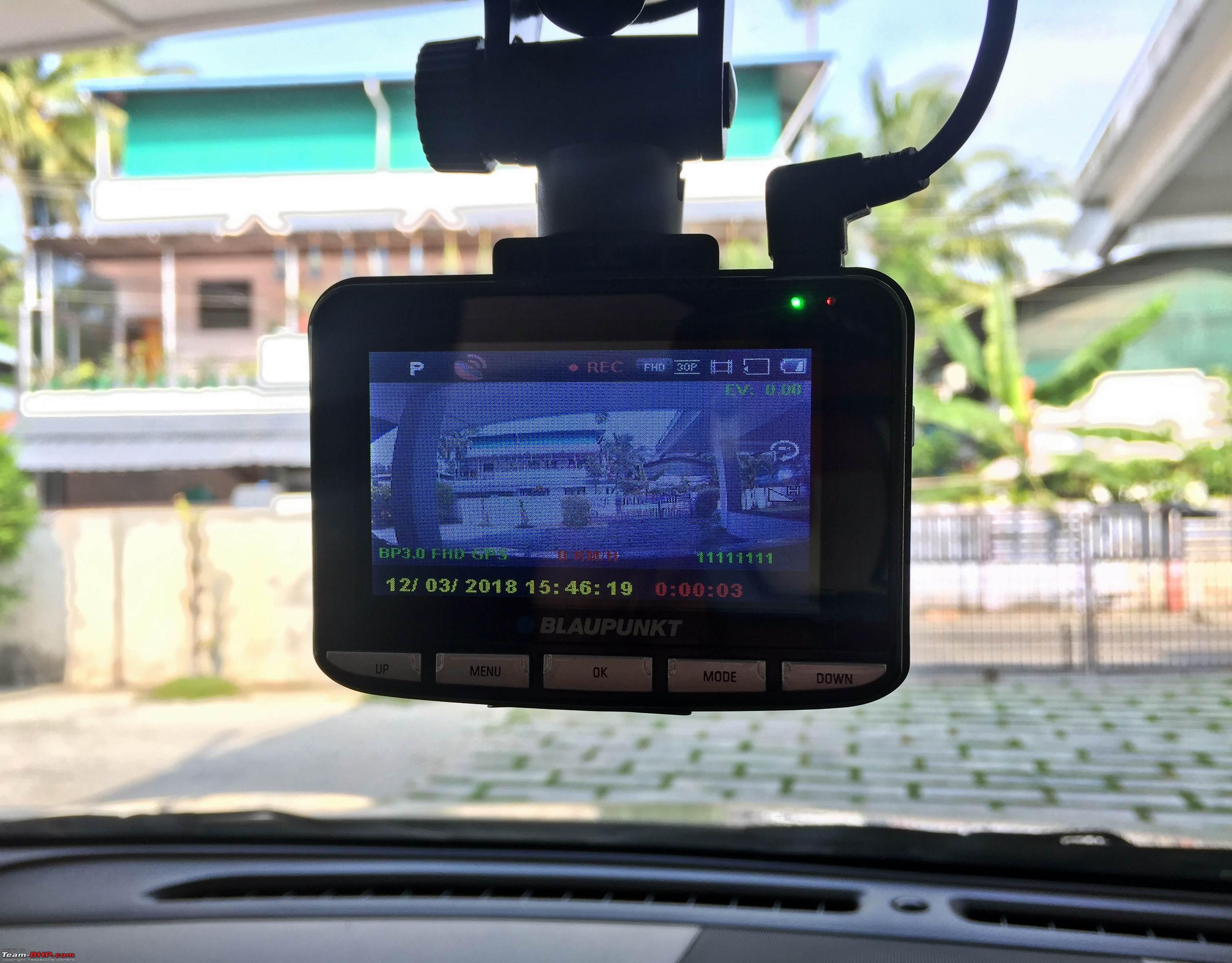

Mod 11 : Dashcam
I travel quite a lot and have had a few close calls too. Hence, I decided to get a dashcam. Got Blaupunkt BP 3.0 cam.
Pandamonium : My modified S-Cross 1.6-cam.jpg

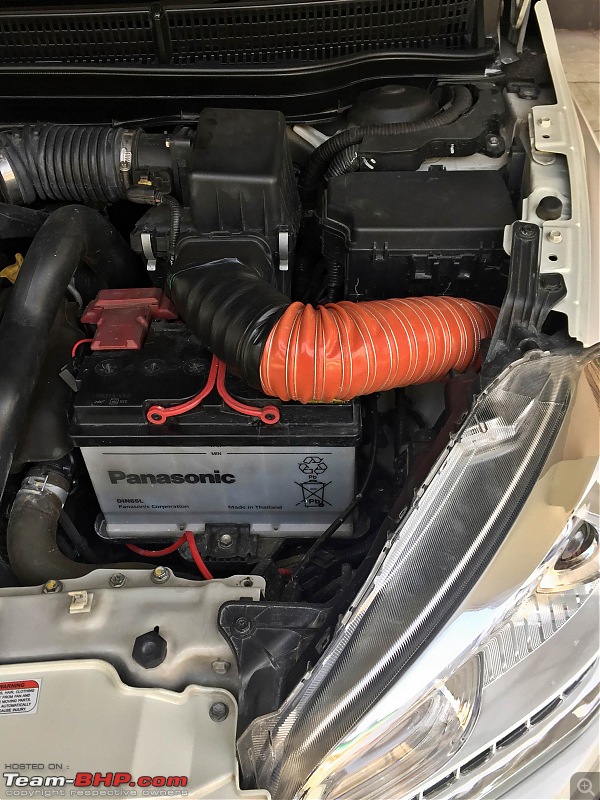

Mod 13 : Re-Routed Air Intake System
I've been trying to source replacement filter for the car, for a while now. Sadly, no brand has replacement filter for S-Cross. Although, CAIs are available. CAIs are expensive and I don't think they make any noticeable difference, apart from the suction noise.
I've switched to S-Cross 1.3 air filter as well. The dimensions of both the, 1.6 and 1.3, filters are the same. Just that the 1.6 filter has an extra layer of cotton at the bottom. 1.3 filters costs only a fraction of the imported 1.6 filter too.
Pandamonium : My modified S-Cross 1.6-images.jpg
Venkat, at Blackworks, re-routed the air intake system. Apparently, the stock intake pipe is set just behind the radiator, from the factory, sucking in hot air. The stock pipe was altered and a silicon hose was attached to it and directed to a vacant spot behind the headlight. The hose isn't placed low, so there wouldn't be any problems during monsoon.
Pandamonium : My modified S-Cross 1.6-intake.jpg

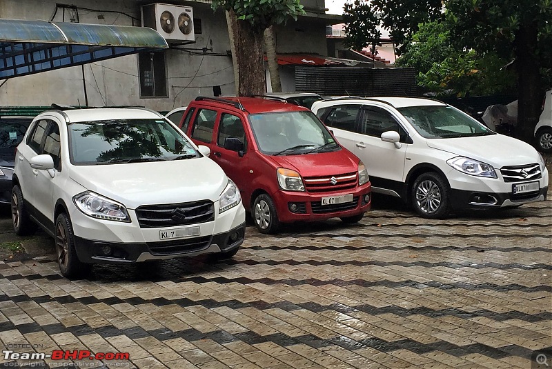

Pandamonium : My modified S-Cross 1.6-comparison.jpg
Stock Vs Panda Vs Wagon R?

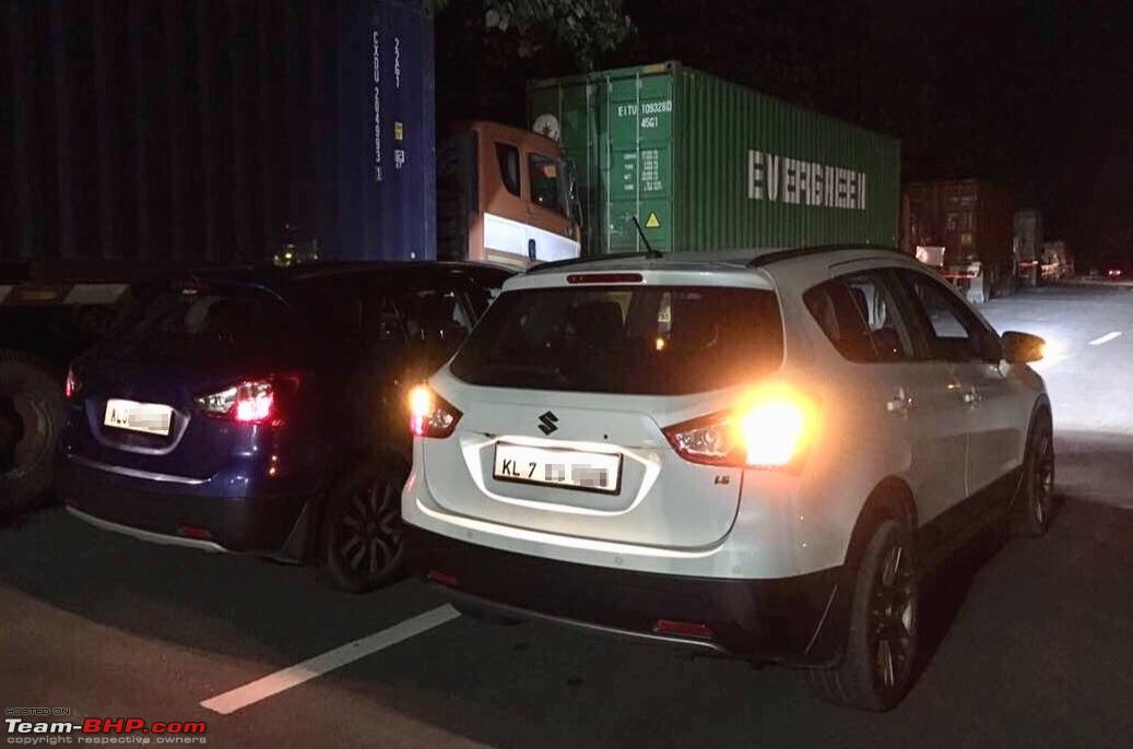

Pandamonium : My modified S-Cross 1.6-coorg.jpg
Mile Muncher
Panda trying to fit in with the Big Boy

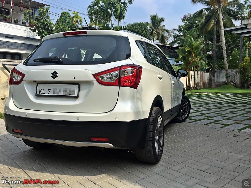

Pandamonium : My modified S-Cross 1.6-claen-back.jpg
Super clean A**
