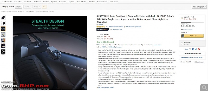

Surfed a little over the internet. Amazon India shows the price as Rs. 9500. I just randomly thought of looking it up on Amazon US and got a Lightning deal. Ended up with this same dashcam of less than Rs. 4000.
The downside of this Dashcam is 'No WiFi'.

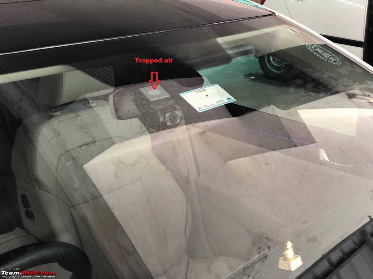

Yeah, going good so far. Last month I drove to Coorg (from Bangalore) when the Sun was really hot. Even parked the car in uncovered parking a few times for the whole day. You might be facing issue because of the trapped air between the DST(Double Sided Tape) and the windscreen.
Review: Aukey DR02 1080p Dash Cam-withbubble.jpg
The expansion of trapped air with the rise in temperature will decrease the area of contact between the DST and windscreen and camera will eventually fall because of its weight.
Check my setup without any trapped air.
Review: Aukey DR02 1080p Dash Cam-nobubbles.jpg

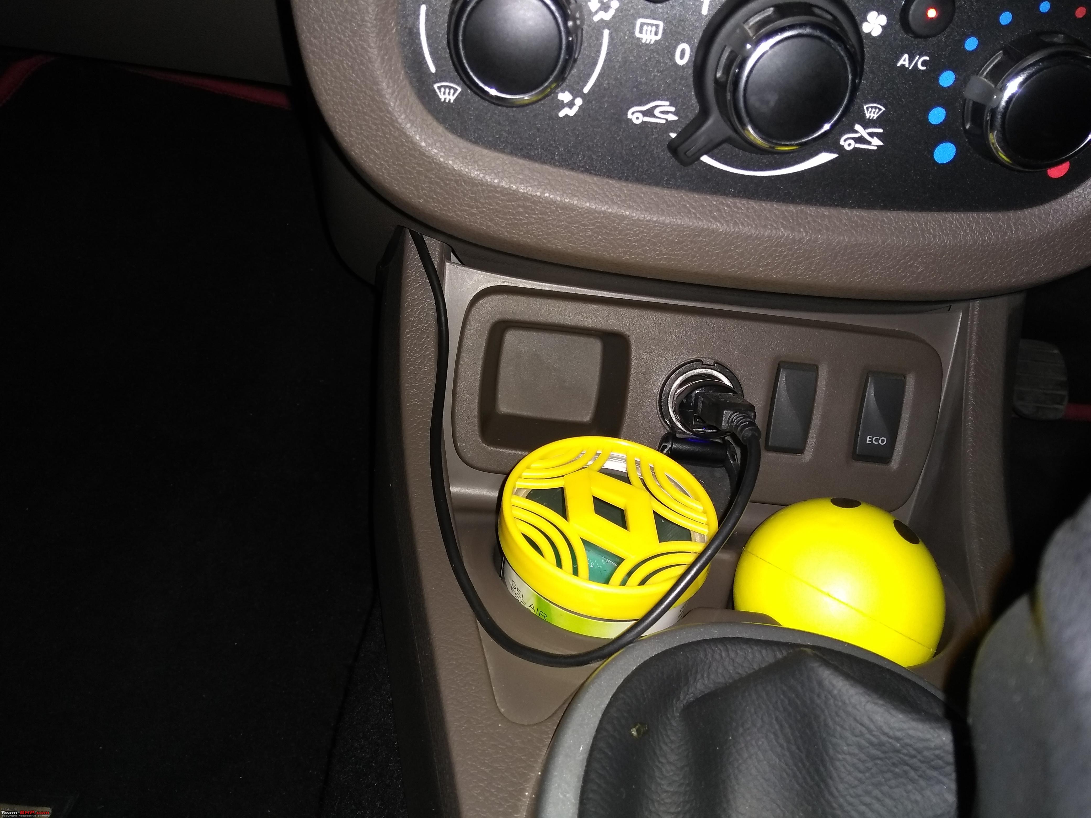

As this is not hardwired, you can try doing yourself. But if you are not confident enough, you can get it done by some guy with expertise. Here are the few photos of my setup that can be useful.
Routing part 1: No, its not hardwired. I am using it this way.
