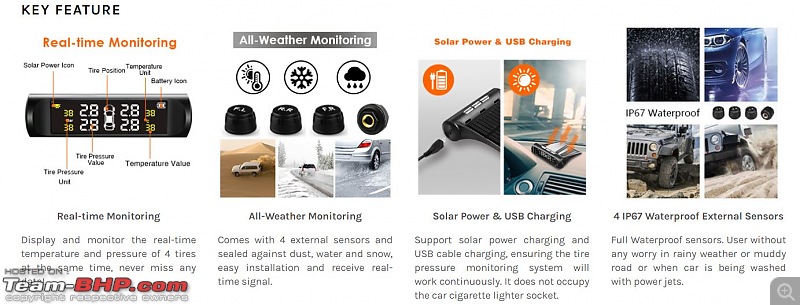

Some Photos from Supplier Website https://www.nexdigitron.com/collecti.../tpms-external
They claim to be the only suppliers of 7Mai & DDPAI Dashcams which is going to be my next purchase very soon.
The Aftermarket TPMS Thread & Review of my Visture Solar TPMS-website-photo.jpgThe Aftermarket TPMS Thread & Review of my Visture Solar TPMS-website-photo-1.jpg

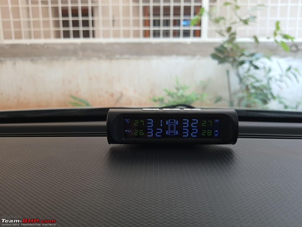

This is the Closeup view of the Display. As soon as Installation was completed. Notice the temperature variation in Rear Right Tire. It is due to direct sunlight hitting the Wheel.
The Aftermarket TPMS Thread & Review of my Visture Solar TPMS-inside-view.jpg

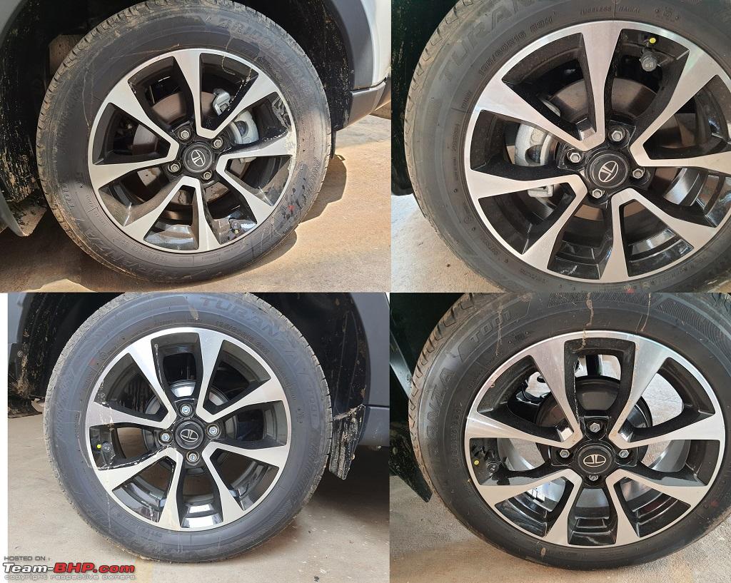

External Sensors installed on each Tire. I validated thrice if the tires were loosing Air. Readings remained same. No visible Air loss as well.
