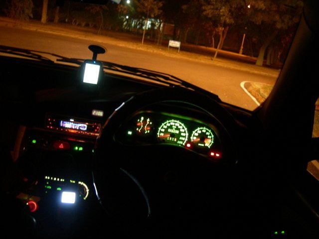

Originally Posted by SRK View Post
Why dont you got for something like a portable gps..That can be taken out any time you want..Or a pocket pc..
I already have a pocket PC with a GPS SIRF II Chip . This is what my cockpit looks like with GPS Navigation and my Ipod connected to my jvc head unit through aux in:
and this is how the cockpit lights up
This is a very expensive option man. out of qustion and my pocket reach
But I seriously want to go for the car PC so I really want to put a 7" touch screen in my dash
