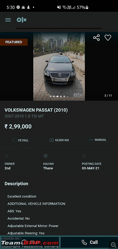

Okay. That's an option I didn't think about. But instead of the laura tsi , how about a passat 1.8tsi from 2010? Are they modifiable just like the laura?

You'd, be better off in a Jetta! The Passat has a more complex electrical system and is prone to issues!
My 2 cents!
