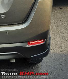

Starting from Hyundai Creta and presently Maruti Wagon R, many many car owners are installing this accessory.
The rear bumper-mounted reflector is replaced by an LED lamp.
The reflector on the rear bumper is a regulatory requirement and is an important safety feature of vehicles. By removing it and installing in its place LED type, car owner's think it's a fancy item but this is a risky and illegal thing, when the car is parked in dark, it is the reflector that indicates the presence of the vehicle to oncoming drivers.
Because of unawareness, our car owners are installing this unnecessary and unlawful accessory in big numbers.
And also these LED lamp accessories are imported from China, we can easily save this drain of our money to China.
Name:  Reflector Replacement Acc.JPG

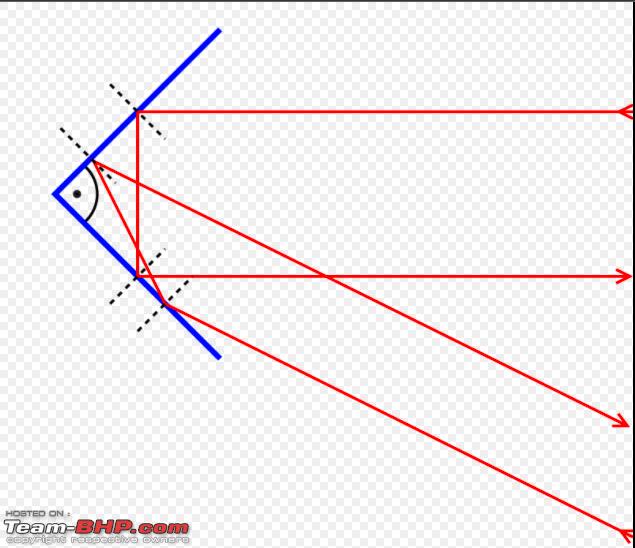

Now a noob question : How difficult it might be to retain the reflector (plastic lens) and put the light/ LED inside it. Or if a red reflector tape can be pasted at strategic points.
Reflector has a surface of micro-prisms at back, which reflect the light back to the source by using principal of critical angle.
By replacing the micro-prism surface with LEDs, one cannot imitate the action of micro-prisms.
This reflection can also be achieved by using Cats Eyes.
Plastic reflectors are more durable and throws back light brighter and at greater distance, hence they are preferred over tape reflectors.

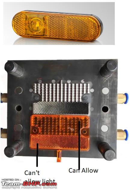

Sorry, following with another noob question : Can't the LED be placed behind the micro-prism surface and back surface be masked to depict the design ? That way, if technically possible, both functions can be retained.
I have tried to edit your diagram to explain my query :
Orange Circles = LEDs/ light source
Black Lines = Masking for design
Attachment 2233026
No, part of the light might come out, but most will be scattered or reflected back. The tool for making this mold has 100s of pin like structures to create this prisms, so the backside is just a mirror image of front structure hence mostly it reflects than allowing the light to pass through.
Also the prisms are so small, your picture will be exactly opposite. One LED will cover 10s of prisms instead. Lights are incorporated in reflex reflectors but they need a separate lens area. Infact, the tool is super complex to produce due to the accuracy and finish requirements, I had never seen this tool being made in India (I mean the machining of mold) till 2015. Even super budget vehicle companies like Hero gets it done from Korea.
