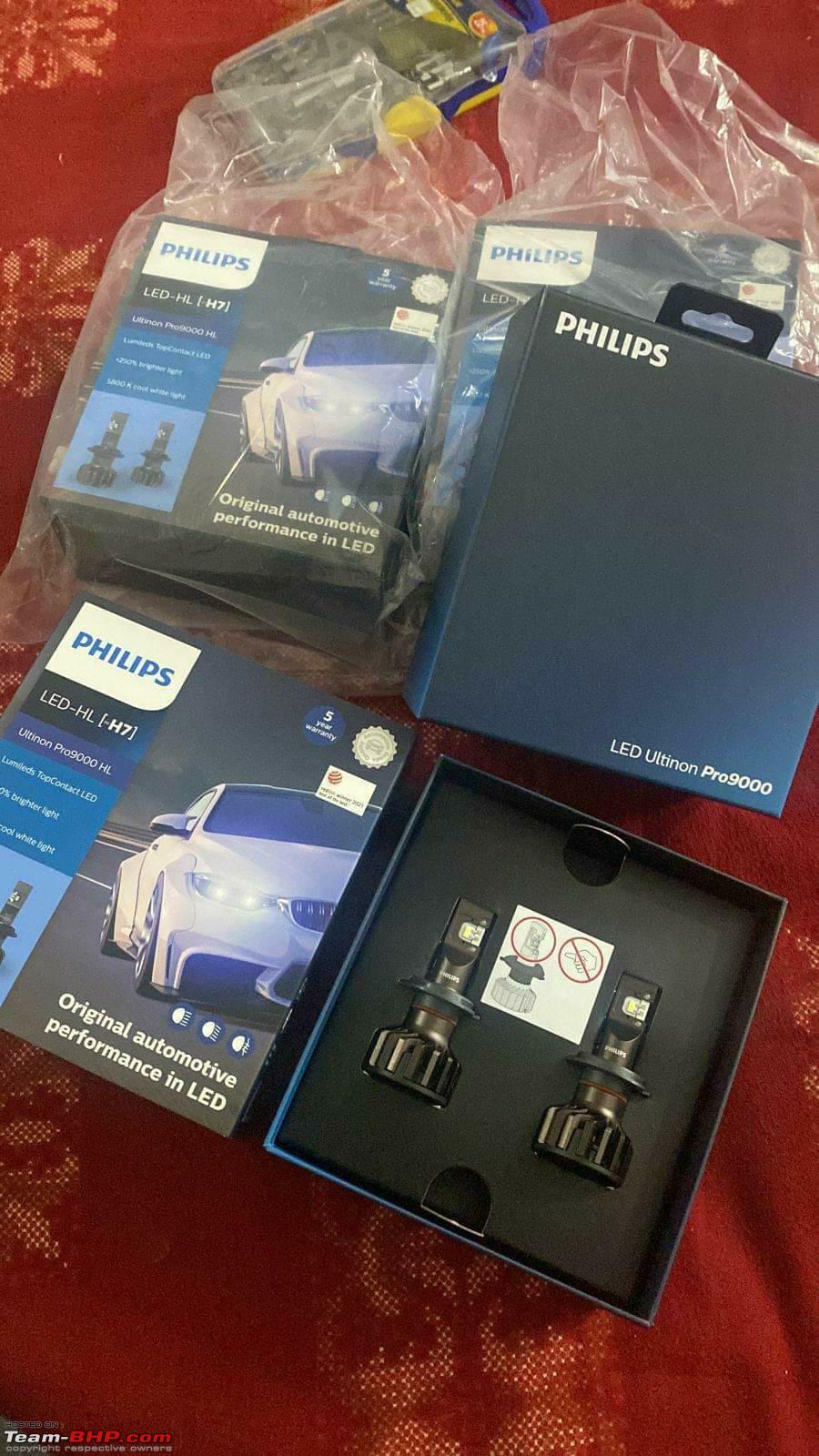

Purchase Experience
I purchased these bulbs and a few other interior LEDs from PowerBulbs and I found a few coupons with a 40% off which I applied on my purchase. The site itself is always giving out fair discounts, so do keep an eye on that if you’re looking for an upgrade. The shipping on most orders about 50GBP should be free, but we do need to account for the custom duty since this is coming all the way from UK, and it naturally is not going to be undervalued.
I had to pay 6000 rupees worth of duty for the entire package, which translated to 45% of the invoice value. This nearly made me cry, since I was scrambling for paper money in what has been a digital lockdown.

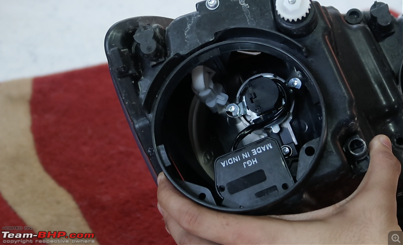

3. Take the dust cap off.
4. Slightly loosen the Headlight Connector ring held by Torx Screws.
5. Pull the old bulb out and then release the headlight connector ring.

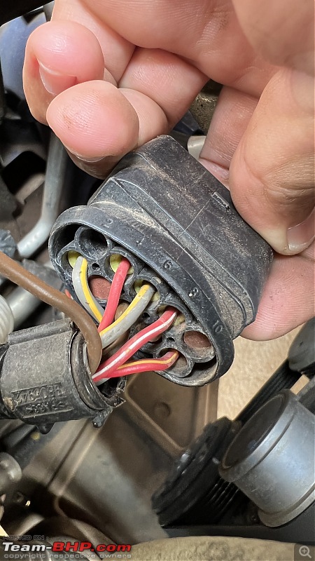

7. Reconnect the LED power adapter to the headlight connector. (2 Wire terminal goes to Negative).

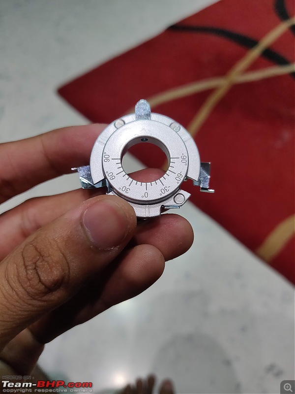

To get the sharpest beam pattern possible in a reflector, the LED bulb to be used should have a filament orientation and design which sits along the original orientation of the best.
As you can see, there is a small stem at the bottom of both rings. This stem should match during the final fitment and tightening. If there is some play, or if this is installed inverted, you will get a glare and a scattered beam, which is neither useful to you nor pleasing to pedestrians. The stem should be aligned along the natural direction of the reflector bowl, marking with this small line. This feedback was received from executives at Philips and from a few popular Automotive channels who specialise in Automotive bulbs and I'll like them below.
The bulb connector connects to the 2 pin socket on the stock headlight. The pin with one wire joined to it is the positive terminal on the LED.

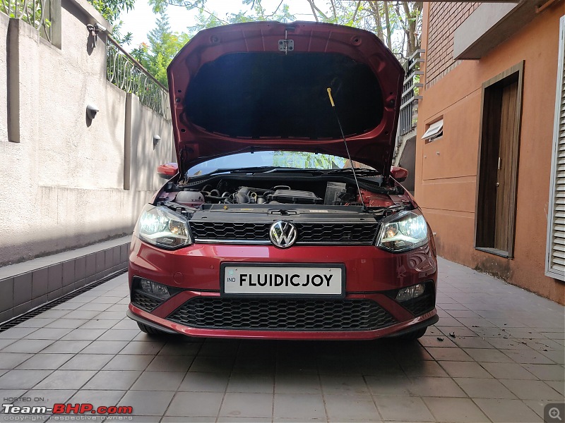

I’ve tested these bulbs thoroughly in quite a few scenarios, and during my testing I did not find these to cause a glare to other passengers and drivers, once they were perfectly aligned. Now sometimes on camera, even a proper genuine headlight assembly can appear to cause a glare from a particular set of angles, but once these were properly aligned, they exhibited a fairly sharp and controlled cut-off.

After beam alignment, I noticed the headlights were not causing any glare to on-going cars and pedestrians. If you have a look at some of the driving sample footage or even experience this bulb yourself, you’ll notice the low beam cutting in below the window-line of most parked and on-coming vehicles. No pedestrian was reacting adversely to the incoming car since the light was cutting sharply below the waistlines of most average height pedestrians. Here's a picture in a dark parking lot to see the cut-off line.
I wanted to test this aspect thoroughly since I absolutely hate the LED Retrofit that my neighbour’s GT TSI has, and the beams cause a terrible glare that makes me swear. Wow that even rhymes!

Originally Posted by premc44 View Post
Thank you for the link to the product on Amazon India. Do we need to buy an adapter ring also.? Is it available in amazon. My car is a Vento TSI AT 2016 model. Thank you
Yes Adaptor ring is needed for LED Bulbs.
Sharing link for you
https://durvient.com/automotive/h7-l...benz-bmw-audi/

Yes, this was the case in even a friend's car here in Pune who installed the LEDs without a BCM Max. Can you check your T10 to T14 headlight adapter? Maybe that will help assess the present wiring scenario.
Perfect functioning of Vento LEDs or even OEM Bixenons requires a BCM 89+ capable of powering lights. That makes DRLs and everything else work as expected. I have used a Bixenon Emulator for Non-BCM 89+ vehicles, so maybe that can be tweaked for LED Headlights as well. I will try and find more details and get in touch if I get more details.
What exactly do i need to check on my adapter? Let me know if theres any fix for this please. Its a pain to flash lights
Please check how it is wired. That way, maybe we can see if there's any wiring which can be moved from the T10 to T14, to any other location e.g Parking Light position so DRLs might not be permanently on. I wonder how you don't miss Headlight Levelling, because I have been missing it ever since I temporarily wired my Bi-Xenon Headlights. Without proper Headlight Levelling, I feel even the world's best headlights can't do justice on dark roads in bad weather.
Ok will check and post a photo here. I adjusted my headlights once and post that since its always just the 2 of us travelling i dont have to adjust them. I used the manual adjuster. Any way to enable the motors?
