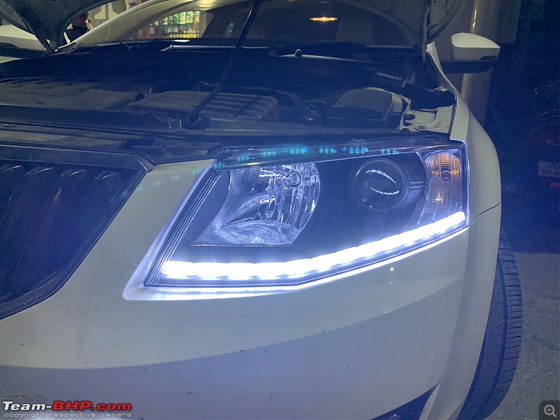

I see you have upgraded the headlight to Bi-Xenon ones. Could you please confirm if this is an OEM retrofit or a modification in your existing reflector setup headlight?
Also, could you please tell us the place you got it done? More details on your headlight setup would be much appreciated as I'm planning to do the OEM Bi-Xenon retrofit. Please post more pictures of your headlight setup too.
Thanks in advance!
Good to see more MT owners
I got a projector set up. So blackened out the reflectors (through painting to give smoked look) and put the projector bi-xenon in place of low beam. OEM has no option for this.
The challenge with our headlight set up is, it’s a dual barrel headlight design and the high beam is H15 which has halogen DRL and high beam. Getting a replacement for this is difficult. So I still have that stock. Good thing is I have 2 high beams, so that stock halogen works better in heavy rains, fog etc. Bad part is that unit is the only yellow light and looks out of place whenever the lights are on and there is no way to turn it off (atleast that DRL). If I get a good LED replacement will change that too. It’s a slightly complex set up, so being careful here. Suggestions welcomed.
Got it done from EVO Bangalore. Been 2.5 years and no complaints. The visibility has definitely improved.
Sorry, don’t have better pictures.
