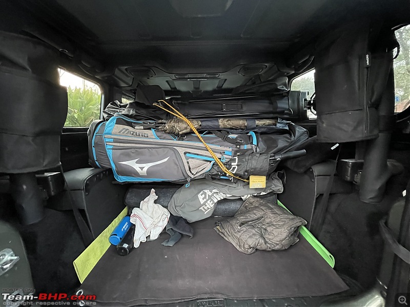

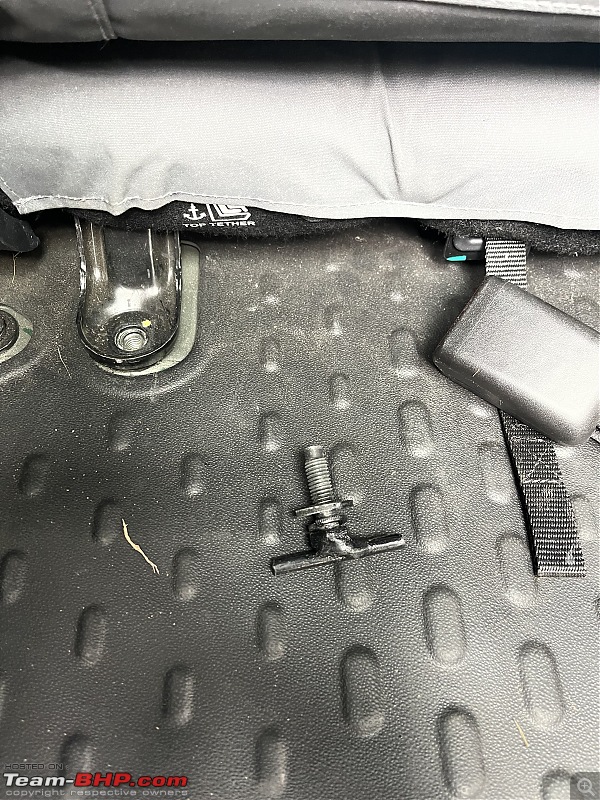

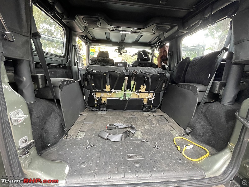

I did this with Azad 4x4 in Bangalore. In my book they are better than the Bimbra one. Because Bimbra uses two support rods and those use up space.
Azad solution uses the weight of the folded seat itself plus the luggage behind shores it up. As additional security they use luggage elastic stays.
See the pictures attached. This is a huge help. I have been using this since Nov 2022 and have loafed around multiple places with all sorts of luggage including two golf bags and all and am very happy with this.
They simply introduce a hinged flange and this causes the tumble fold to happen. And use those T bolts to secure the seats if the seats are put back into their original position.
Ideally this tumble fold feature ought to have been provided by Mahindra as a factory spec.
Anyway Saksham Kaul of Azad in Bangalore will be able to get this done. It is a 2 hour job and is done at their facility in Hosakote. The contact number is +91 99801 37004.
