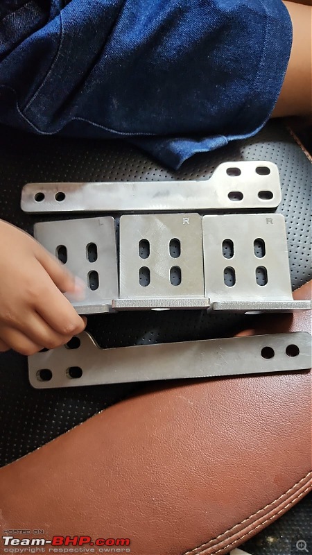

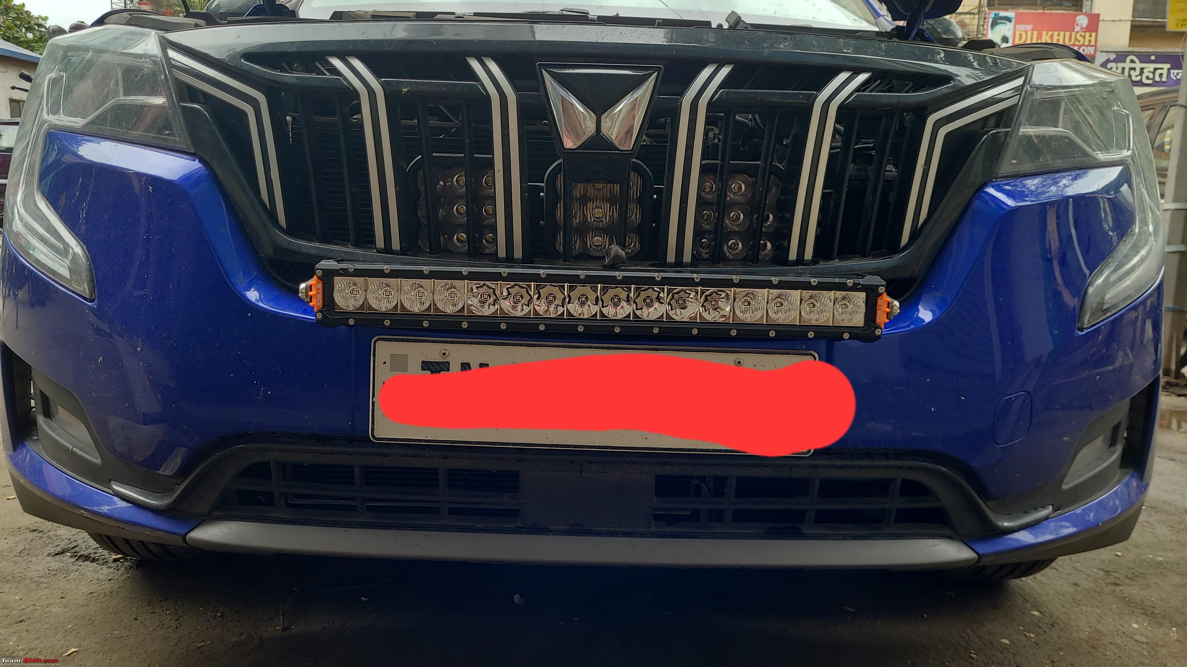

Hello
I have fitted the lights, here is the image below.
I had to deviate from my original plan of fitting all the lights behind the grill.
The light bar was mounted outside with the help of brackets,
I do not have a good camera which could replicate the actual light output so haven't posted any output images.
The light output from the Lightbar is good, but overall I haven't achieved my goal of replicating the light output same as projector in terms of light spread and uniformity.
The 3 Pods are really under performing, as most of the light output is getting blocked and I'm unable to adjust the vertical angle as well to adjust the throw.
Next steps-
1. Will be leaving 1 single driving beam pod in the center and will move the other 2spot beam pods near my orvms.
2. I have made up my mind to do projector retrofit in my headlights.- Currently in planning phase.
