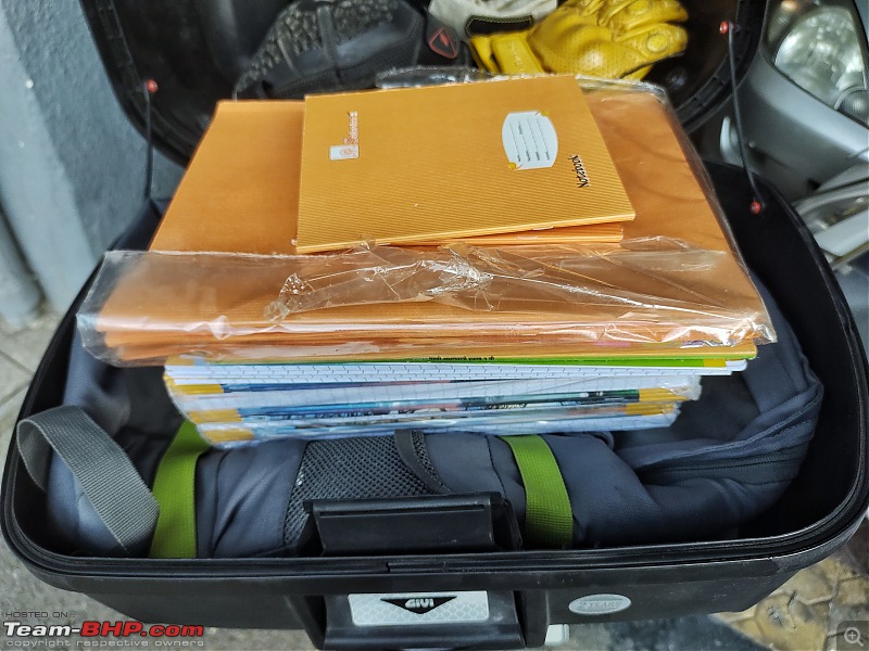

Just to experiment, I carried school notebooks in my Givi 43L top box on V-strom SX 250. Distance was less than 5 kms and also tried removing hands from handle bar for a short distance as well, bike continued in straight line without any wobble.
Handle wobbling due to loaded top box on my motorcycle-img_loaded_top_box.jpeg
Load of notebooks (6 Kgs) showed its presence while taking turns, although being heavy it didn't move much. Below notebooks lies my empty backpack, it might add up some more weight. Plus weight of knee guards and gloves.
In summary, loading up top box didn't lead to wobble for me.
