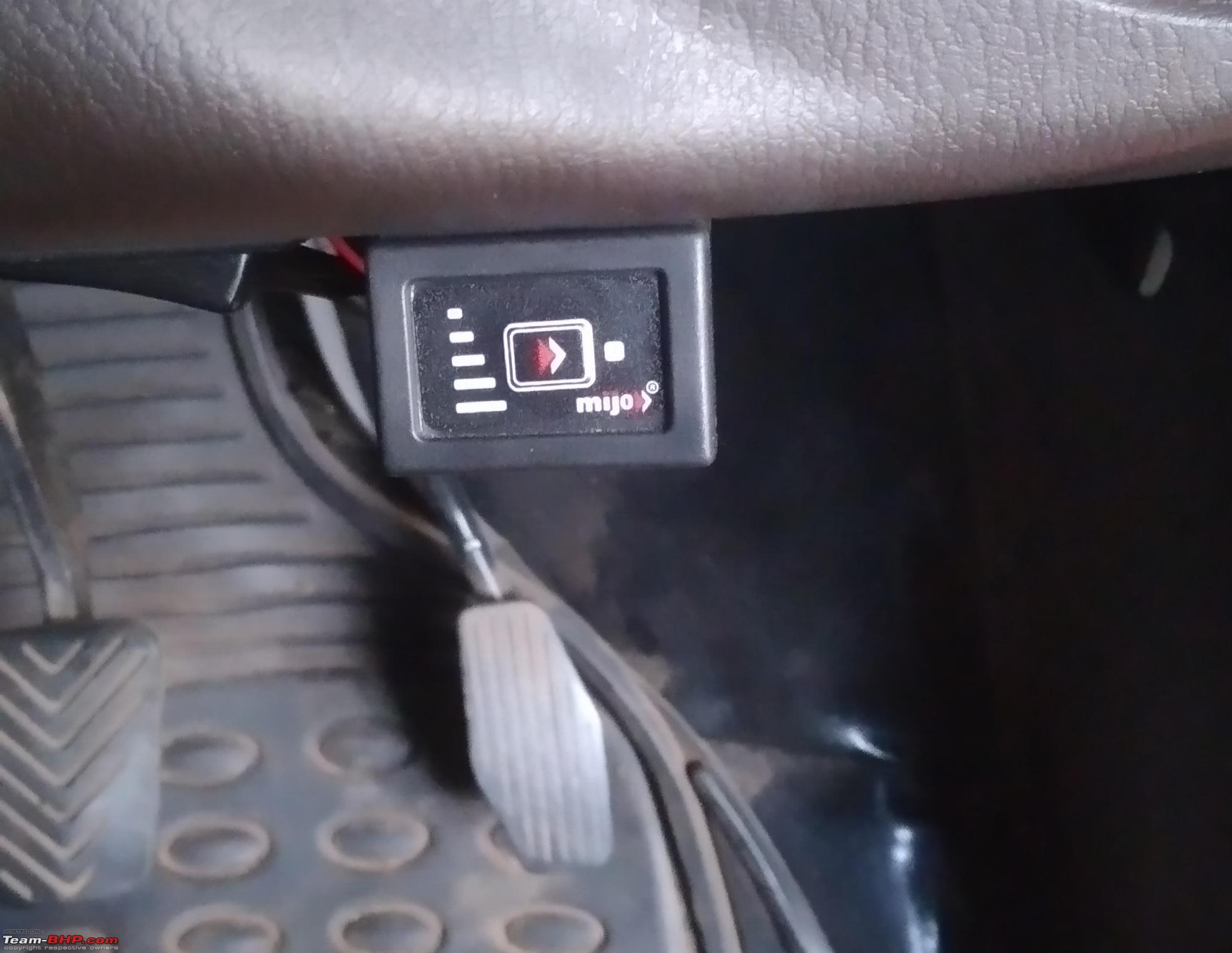

Usually here on teamBHP and generally , ive seen people reporting issues 5000, 10,000km after retrofitting.However, i had the luck to get issues a lot earlier, earlier as in literally 5 kilometers after getting off the compound of the fitment center. After driving for a couple of kilometers, i stopped to take a phone call and shut down the engine, when i restarted the engine after a couple of minutes, it wouldnt idle correctly on petrol and the engine shakes violently, and the only way the engine stays works is if im on full throttle, if i let it go, the engine shudders, accelerate irregularly, the time was almost 10PM, i called the guy who fitted it and i sent him the location, he came to where i stalled and tweaked around under the hood and got it started it again. But after some time, it stalled again, and i was stuck in a bad part of the town, in a stalled car. It wouldn't start no matter what i did, i begged the car and it finally started after multiple attempts, and i had to drive the 4 or 5km home on full throttle and eating through 1/2 of my clutch's life and burning lots of petrol. The next day was sunday, and i was stuck at home, on Monday, the cng guys came to my home and tweaked around,replaced the Emulator, yet the issue didnt go away.
At this time, i got in touch with TeamBHPian @HimanshuKenshin who has posts regarding CNG conversion and his own experiences with CNG, and we came to a conclusion it was either the wiring issue or the reducer is faulty and leaking gas while the engine is running and messing up the AFR.
Now, the engine runs smoothly on CNG, but on Petrol, it was acting really bad, always stalling, long cranks to start, and refusing to stay working unless im on full throttle, and the CNG guys started coming up with absurd diagnosis to shuttle me between the petrol mechanic and CNG mechanics, like the Fuel Pump is faulty and i need to replace it, and that made me loose my cool, and i demanded them to fix my car that was running fine on Petrol before they laid their hands on the car, and they told me to bring the car on the next working day, i had to take the entire day off and lost my college attendance, however they managed to fix the issue and tried to blame that the engine was overheating and i needed to clean my radiator and flush out the cooling system, and although i knew that wasn't the issue, i was tired by all this running around and the coolant system is already due for a cleaning, got it cleaned by our family mechanic and started driving around.
Now, on CNG, i found the car was quiet and had sufficient power, but when you apply full throttle suddenly, the car seems to bog down a bit, and i was getting a measly 10km/kg. I took it to the cng guys to get it tuned, and they just adjusted the gas flow to a point that its running way too lean and the engine is shuddering and feels like its about to fall apart, i asked them if thats supposed to be normal and they told me they cant do anything about it since its an open loop and its normal. I realized its pointless to talk to them, i followed guides from TeamBHP to tune the CNG system myself to a point i think its acceptable.
500 KM on CNG:
At the moment, the car is running fine on both petrol and CNG, i procured a cheap bluetooth obd2 scanner to scan the ECU since i had an engine warning light, it was a P0130 code for a Faulty Oxygen Sensor, and after checking the real time data, i realized on CNG, the o2 sensor gets cut off and on Petrol, its back online, this causes the cars ecu to think that the O2 sensor is faulty and throws the code, i cleared it and it comes back often, it dosent affect the cars performance in any way.
As for Performance, i tuned the CNG System to a leaner setting, it idles ok with/without AC on, the pickup is slower than petrol, but its acceptable, and you need to downshift a lot more often unlike in Petrol
Mileage:
20-22km on mixed driving conditions with AC always on
Conclusion:
So far, its alright, yeah, if i went for a Sequential kit, but ive noticed a trend between CNG installers that one vendor wont touch the kit installed by another vendor,and if your vendor is bad and you have a sequential kit, you are stuck with him since you need the specific software to tune the CNG system on sequential, but since i had a manual system, but if fitted by a reputed good quality installer who knows what he is doing, Sequential Kit is the way to go, also most cars these days uses a Drive-By-Wire throttle, so sequential is the only choice you have, either way, ill update my experience on this thread. ill post the pics below.
