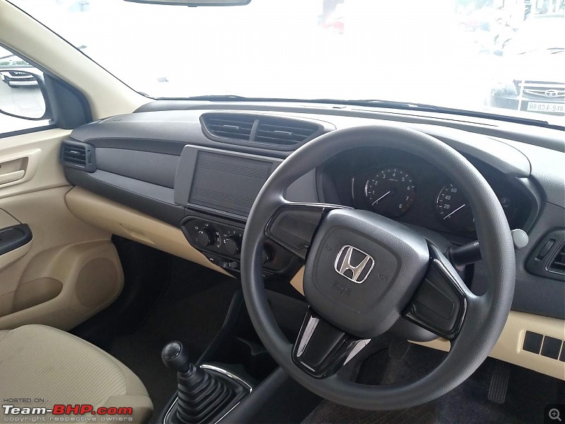

When I bought the car, I asked the dealer to provide me with the Honda Genuine 2 DIN Infotainment System which was preinstalled in the Amaze SMT Variant. He told me that he would try to get this for some other customer who would opt to get the stock system removed for a touchscreen. He did arrange the system and the fitment looked good too since it was built for this dashboard. However, since it was paired with Sony speakers and not the stock speakers, the sound output wasn't really great. Moreover, I also wanted a reverse parking camera and Apple Carplay (mainly for Navigation, Calls, and Siri).

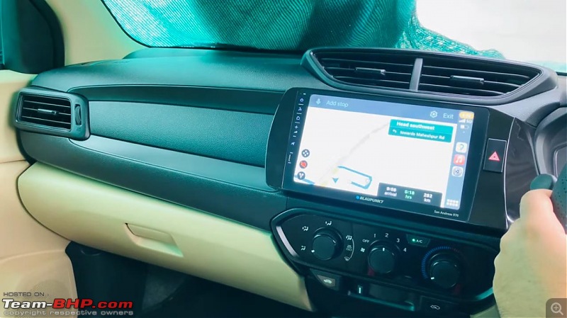

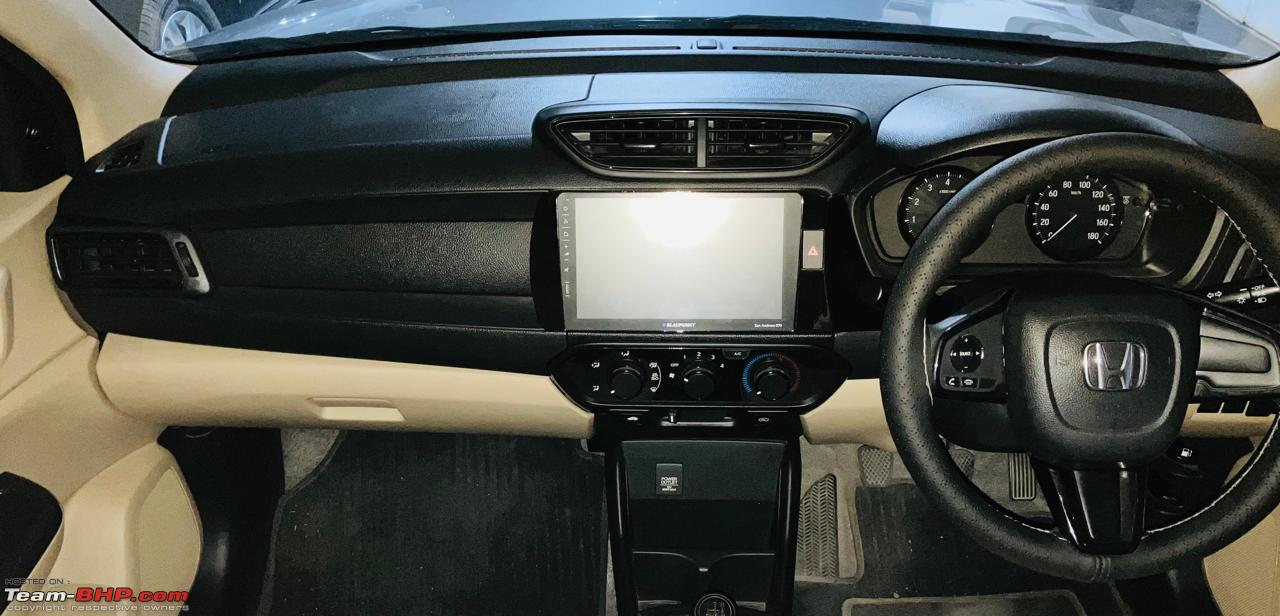

So, I did some research and shortlisted two Infotainment Systems - Blaupunkt San Andreas 970 and Honda Digipad 2.0. The Honda Digipad was my first choice, but I had a major problem with it. The Amaze EMT Variant did not have a built-in stereo, so it also didn't have a USB port on the center console. The solution was to pull out the USB cable into the glove box. Since the Digipad 2.0 only supported Wired Carplay, it would have been very inconvenient to plug the USB Cable from the Glove Box and keep the phone in the same at all times while driving.
Therefore, I resorted to Blaupunkt San Andreas 970. This is a 9-inch touchscreen system which is a non-Android system. I wanted a non-android system to ensure that it does not slow down over time. Since it had Apple Carplay for my Music and Navigation, I won't require the Android system anyway. The system is fast, Apple Carplay runs smooth and the audio output is good too. It even has a USB C port on the front of the player, so I didn't have to pull out cables in the glove box. Bonus feature - The Apple Carplay runs on both wired and wireless connectivity! I also installed a Blaupunkt rear camera which was mounted above the number plate for the OEM look.

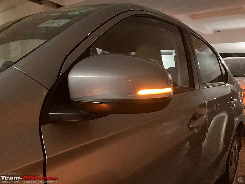

One last major upgrade that was left was the Auto Foldable and Adjustable ORVMs. These didn't just look good but were also quite useful while parking or taking sharp cuts as I could adjust them according to the view.
I found someone who had all the original parts and was ready to install these without cutting or splicing any wires.
He installed the mirrors and mounted the Maruti Suzuki ORVM control switch next to the Power Window controls on the driver-side door.
Neatly converting my Honda Amaze EMT variant to VX-MT (Sort of)-whatsapp-image-20240516-8.13.25-pm-3.jpeg

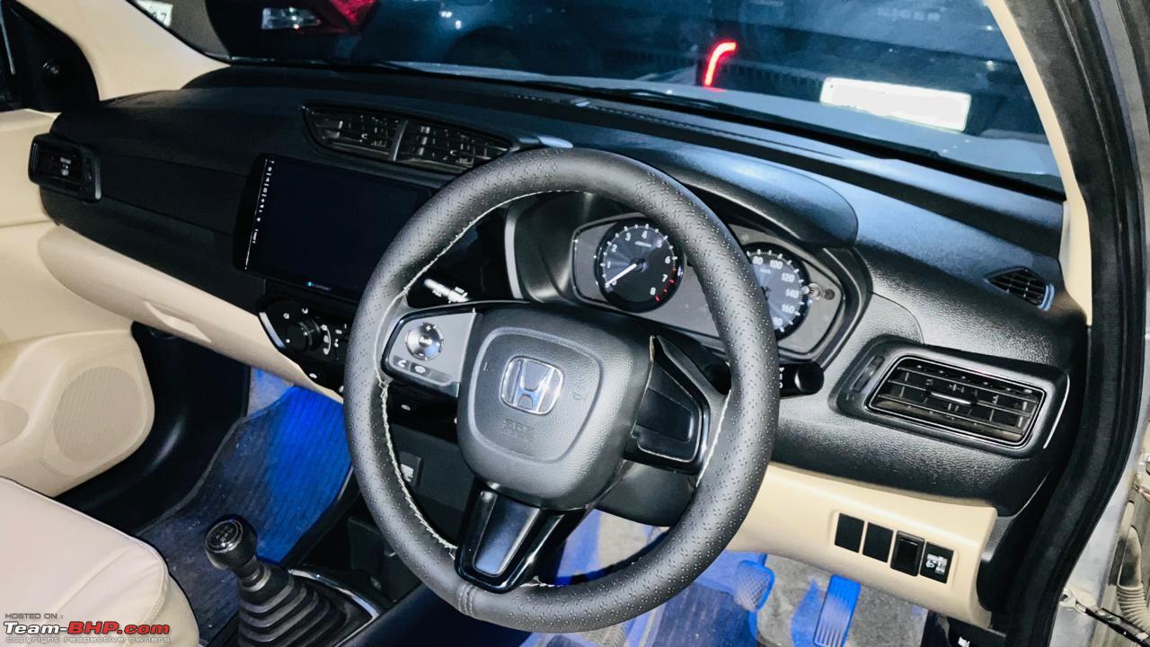

All the above modifications did not just enhance the car's look and feel but also made the car's driving experience better. If I had an option to go back in time, I would have chosen the SMT Variant for sure. But at the time, the EMT Variant felt more VFM.

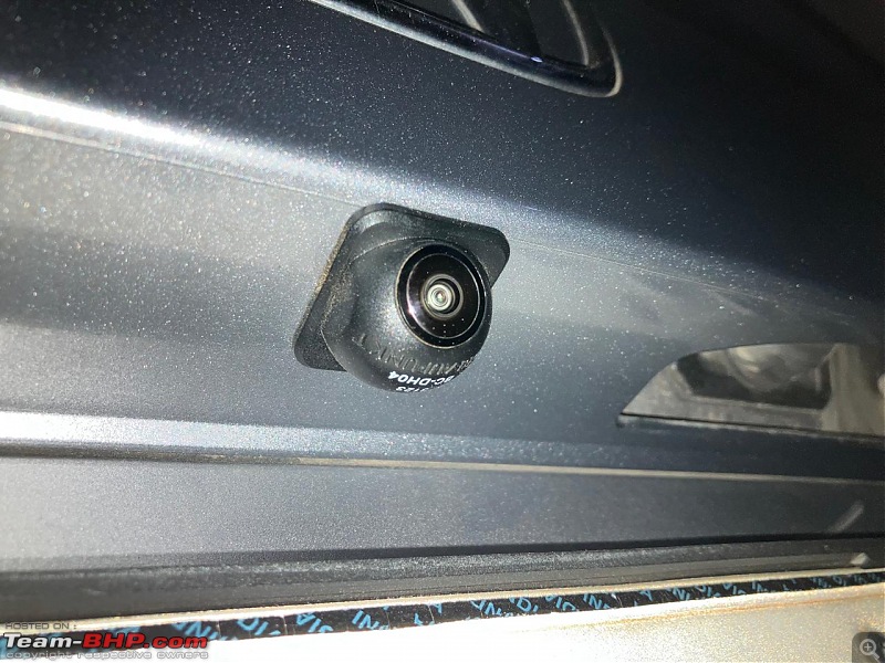

The Blaupunkt Systema along with the frame and Blaupunkt camera cost me around INR 30,000. Auto foldable and adjustable mirrors cost me around 9000, the wheel covers from Honda cost me around 900 per piece (so 3600 for 4 units), the paint job on the steel rims were done at a local shop for INR 600, The black sash tape on B Pillars from Honda cost me around 2000 including labor charges (labor charges are high around INR 1000 since the weather strip has to be removed for installation which requires the door trims to be removed, takes some time). Door Handles and ORVM Mirror paint was done at Honda Workshop and the cost was around INR 3000. Steering wheel controls cost me around 6000 including the clock spring. The ambient foot lights were also from Honda Accessories and cost me around INR 2000.
So, total cost would be around INR 56,000. But the car now has way more features than the VX variant
