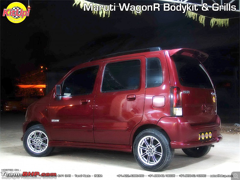

@mnhegde:
a minor performance boost - You can go for a K&N conical filter with custom plumbing to place it in a minimal heat area in the engine bay OR a K&N apollo CAI.
A FFE with 4x2x1 header(for low & midrange boost) OR 4x1 header(for top end boost). you can retain the stock muffler if you dont want it to be loud.(please keep your stock airbox and stock exhaust setup safely with you)
Use fully synthetic engine oil.
a neat exterior modification - Go for a subtle bodykit and alloys(the ones that contain a little black in it, since your car is pearl silver)
here is an idea regarding the bodykit and alloys:

@badboy :Great mod pic (pics) posted by you badboy. I think spacers have been added to heighten the car. I heard adding spacers can cause handling problems , dont know to what extent it is true. I have a stock replacement filter and not Cold air intake. Yes your suggestions are good. But I need a clear picture. See modifying the stock to FFE definitely provides better performance as have done almost the same (not free flow but sort of) for my previous car (M800). It was good . But here the problem is The present vehicle is tall. Say if there is a boost in performance, Is the vehicle capable of accepting it (handling wise) .??. Also If FFE is installed Does torque increase?? Whats the role played by synthetic oil???

@mnhegde:AFAIK, spacers are added to push the wheel a little outside the body, height of the car may be increased only by tweaking the suspension (the car in the pics is not heightened).
