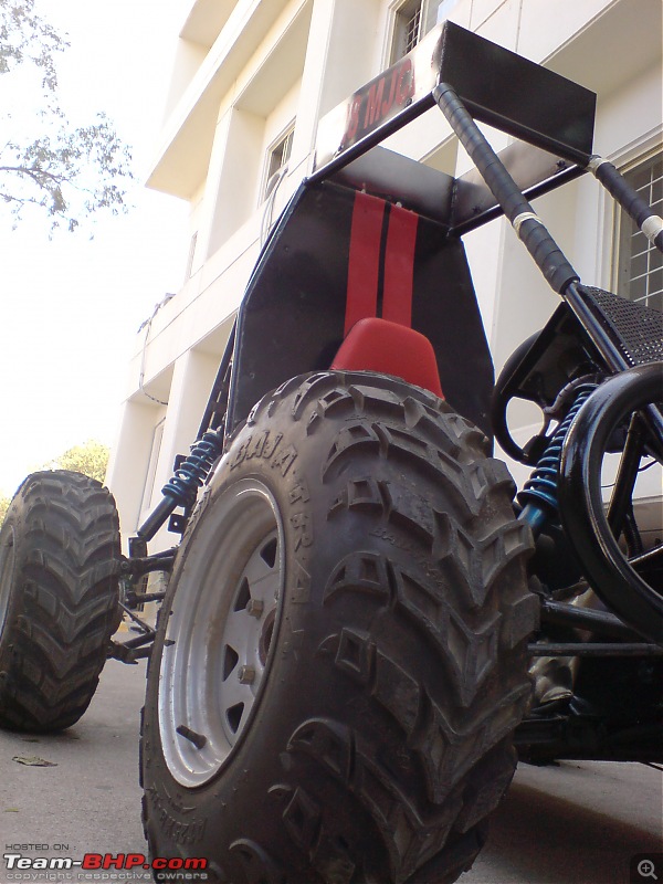

Hey guys just want to share something which many don't know about.
The below pics which you are going to see is an ATV which my college team made for an event/race known as BAJA. This is the second time our college is participating in the event.Last year only our college managed to get into this event from all over AP, but this time more two colleges managed to get into this event from AP.
The Baja event is an international event which is held in US every year.
Since last year BAJA has organized its sub event in BAJA-SAE INDIA in Pithampur MP.SAE stands for Society of Automotive Engineers.
Many engineering colleges from all over India participate in this event and build their own ATV according to the Rule book provided by the Baja itself.
The engine for this event is provided by them and this year they have provided with 340cc and 11 hp engine.
Now coming for the selection of the teams, the teams who are willing to participate shall be facing interviews then they will be selected.
I dont know whether there is any specific number of members to be present in team. Last year our college team has 23 members and this year only 16 members.
This year 58 teams are selected for the event.
The vehicle is made by the student itself and they have to see that the vehicle is made strong so that it can survive the track.as the track will be bouncy,hilly and all kinds of hurdles to check the strength,speed,braking power etc of the vehicle
My college team has completed its vehicle and ready for the event.
here you go with some pics of TEAM MJCET's vehicle of this year.

well here's a pic of the track for this year and also the width and lenght of the road.
syedhafeez is offline   (1) Thanks

lenght 3.5km and width 4.5 meter
We have not tested its top speed as we cant run it on the roads but in the college campus we drived it at 50kmph.
Its an RWD.
The cost we came around was 1.5 lakhs.
we faced many issues during the fabrication like we could'nt find the material specified and tyres were also a problem as he have placed disc brakes and also drum brakes.disc for all the 4 tyres and drum for rear.
@ mnhegde: the height is 1.5m and lenght is 1.8m. the engine brand they provided was LOMBARDINI.
