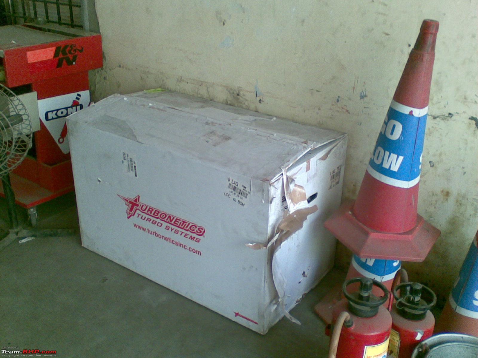

Hello,
These are the photos of the nissan.Although I got a turbo kit made for the Nissan,we had to remake a lot pipes.We had to relocate the battery,starter,power steering cooler and some a/c pipes.After we were done,there was not even space to look inside below the first layer of pipes.
The list is
1)Turbonetics turbo
2)Spearco Intercooler
3)560 cc injectors
4)Dual warbros(no fuel starvation under hard conering)
5)Turbosmart waste gate
6)Raptor BOV
7)Haltech 350z ems
Boost is set at a 5psi because of too much wheel spin,even with the traction on....a little yellow indicator saying "SLIP" flashes every time to use 80% throttle.
Once the tires are changed,we will "up" the boost to 9-11 psi
Thanks
Karan

Yes,I did get it from a co.that sells bolt on kits.But it wasnt bolt on to my surprise.
JDM cars seems to be different from the USDm market where the kit came from.Freight and duty extra.Total came to 5.5 lacs
Any turbo kit will give u 30% increase,which we got and are quite happy.But like I said,one the tires are changed,40 hp more for sure.
