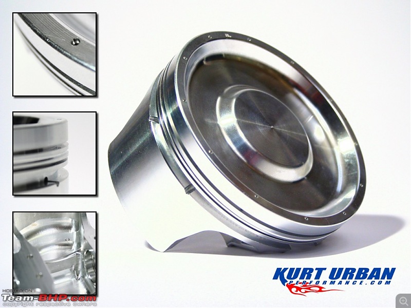

What about getting a piston having a hollow type crown ,like a depression.Though the CR lowered will need to be calculated ,but along with a thicker gasket ,
Subaru Forester Head Gasket | Always In Stock - Replacement, Felpro, Ishino, 00-05
check this out

I would not alter stroke or rod length to reduce C.R, doing that changes the entire characteristic/geometry of engine, A simple more straight forward would be to get aftermarket low comp pistons for the application.

Turbo specific (Cu?) thicker head gasket willnot only reduce CR but also hold boost better. Dished pistons if you want more.
