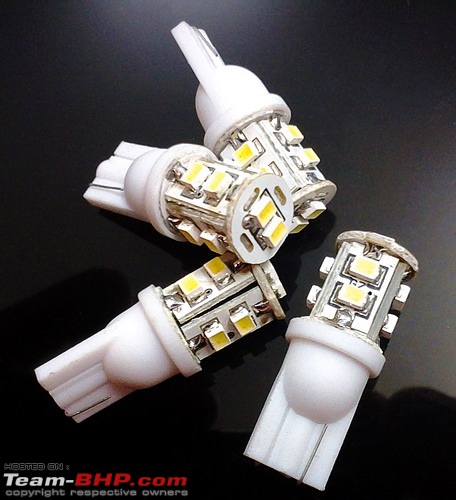

Hi there,
Just got delivery of the T10 LEDs. Look great and well built. Will post a hoto once I install them tomorrow.
Auto Lighting thread : Post all queries about automobile lighting here-t10-leds.jpg
