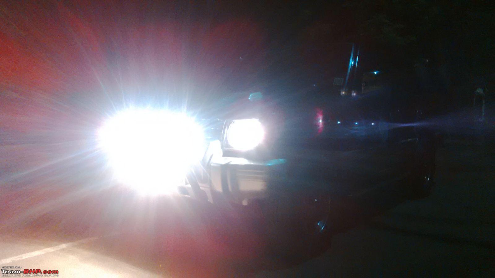

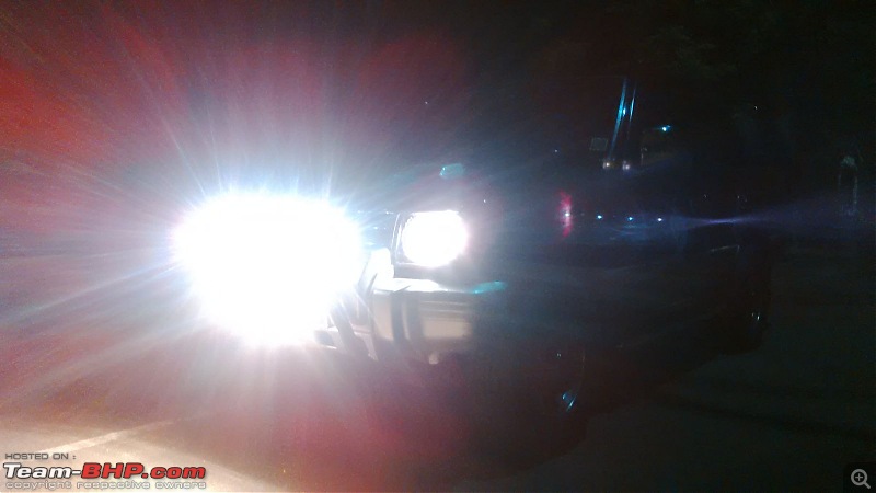

People, attaching some pics of lighting with Philips Premium Vision 100/90W Bulbs. Also included are 4x100W H3 Hella Comet 500FF aux lamps (2xPhilips Rallye and 2xOsram Bilux), and 2x100W Hella Rallye bulbs on Fog Lamps.
Output: Exhilarating with a fantastic Cut-Off even with the High-Beam that keeps up its promise of never leaving you in the lurch even under extreme bad visibility conditions!
:Shockked:The alternator must be working overtime for this set up.Have you kept a tab on the battery?
Yup, the alternator will be put under heavy load. Check the max output of the alternator and upgrade if necessary. Else your battery will go for a toss and you will be stranded
Alternator and battery doing great. Moreover, I use all the lights at one time rarely. My headlights are more than enough for most times. Use one of the two pairs of aux lamps alternatively one pair at a time on highway night-drives only when required. Fog lamps only when situation demands. So no load. Further, I just returned from a 3-week long 7200 km trip over 11 states, and had to drive a lot in the nights with both pairs working simultaneously for long durations. Still, I'm doing just fine!!!
