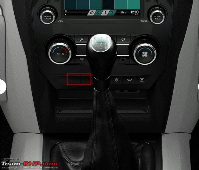

Secondly, while aliexpress can send me the radio control switch , however , I am wondering if one can have a better OEM experience by using one of these.
Auto Lighting thread : Post all queries about automobile lighting here-switch.jpg
Thus my project continues to be on hold.
P.S. Instead of the wiring shown in my earlier post, I have (almost) decided on an original Hella harness, to which I would only add the shunt wire from Alternator to Battery as BD sir has recommended somewhere.
Source of images: Hella and Mahindra
