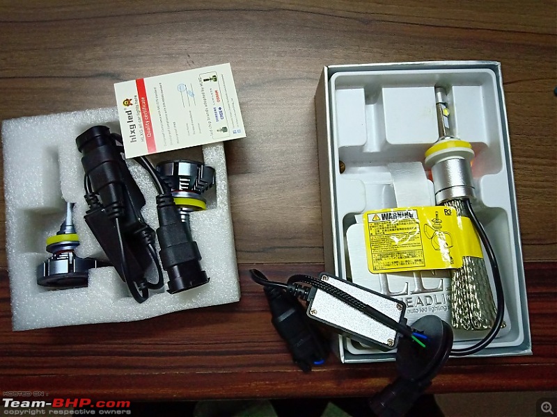

Couldn't get the GTR bulbs but tried with another bulb which is best of the 3 types I tried. This is a regular CSP bulb from HLXG. Much smaller and compact compared of the other LED bulbs I tried and these supposedly use Phillips Lumiled's.
Packaging not as premium as the XHP50 bulb
Auto Lighting thread : Post all queries about automobile lighting here-led-v37.jpg
Auto Lighting thread : Post all queries about automobile lighting here-led-v35.jpg

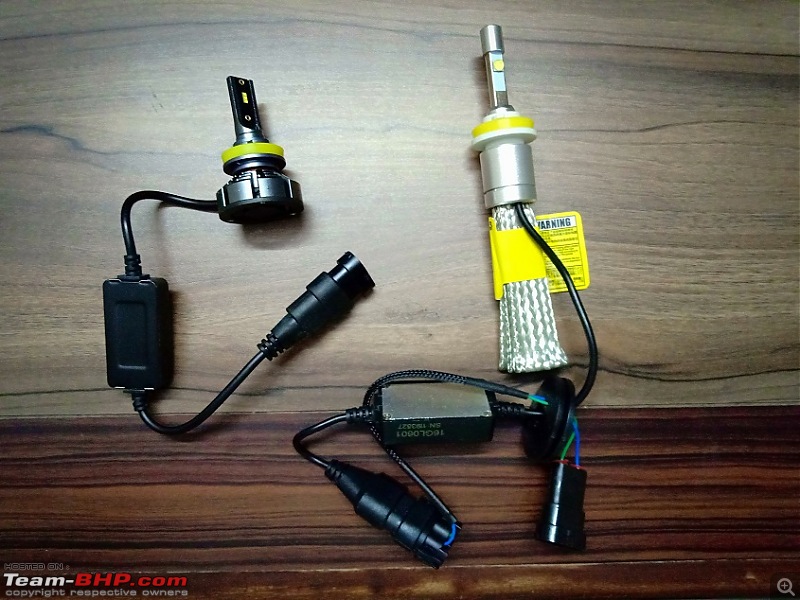

Very compact compared to XHP50 so those who have space constraint can consider these
Auto Lighting thread : Post all queries about automobile lighting here-led-v36.jpg

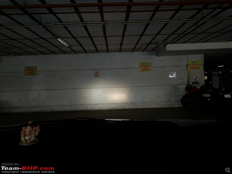

Size comparison - CSP vs XHP50 vs Halogen. The diode position is quite close to the halogen filament. The dust ring is bigger in the LED and if I push the bulb forward, the focus improves. I will try swapping the ring with the halogen bulb's ring and try again.
Auto Lighting thread : Post all queries about automobile lighting here-led-v34.jpg
Low beam + High beam. CSP LED on the left, Halogen right. There is a decent hot spot comparable to Halogen, though there is some undesirable spread as well.
Auto Lighting thread : Post all queries about automobile lighting here-led-v31.jpg
Low + high beam - Only LED (Left). Best of the lot I have tried though still not as good as Halogen. I have angled the beam down so lot more light on the road.
Auto Lighting thread : Post all queries about automobile lighting here-led-v33.jpg
Low + high beam - Only Halogen (right)
Auto Lighting thread : Post all queries about automobile lighting here-led-v32.jpg
Attachment 1820522
ATTACH]
You may need to play with the LED's position in the holder to get that hotspot a bit smaller and produce a sharper cut off. looking at the pictures it seem to produce excessive glare as it is now , i hope you succeed in getting this adjusted properly.
I looked at the specs of what Philips is selling, the lumens rating is similar or less than halogen output. Probably something to do with ECE regulations. So anyone looking for more light has to rely on a bit of trial and error now. Good luck.

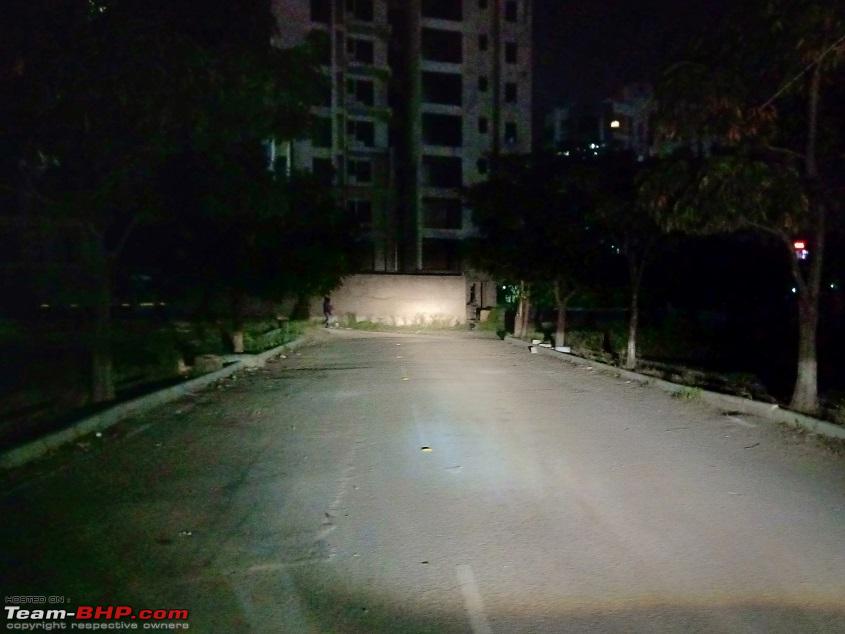

After the HID fiasco (severe shadow problem), I upgraded my XUV projector bulbs to Philips Xtreme vision plus. But they too were OK and not that great. The only option that I could now think of was Auxiliary lights, and what better than 'Lightforce'. Here is my beast with the new toy - Let there be LIGHT!!!

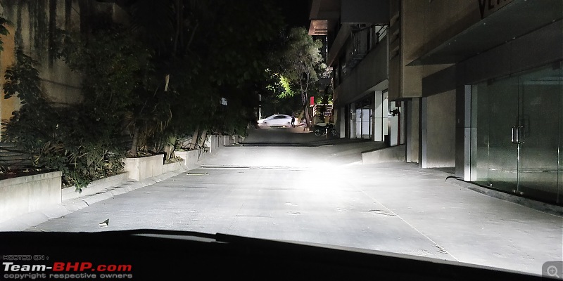

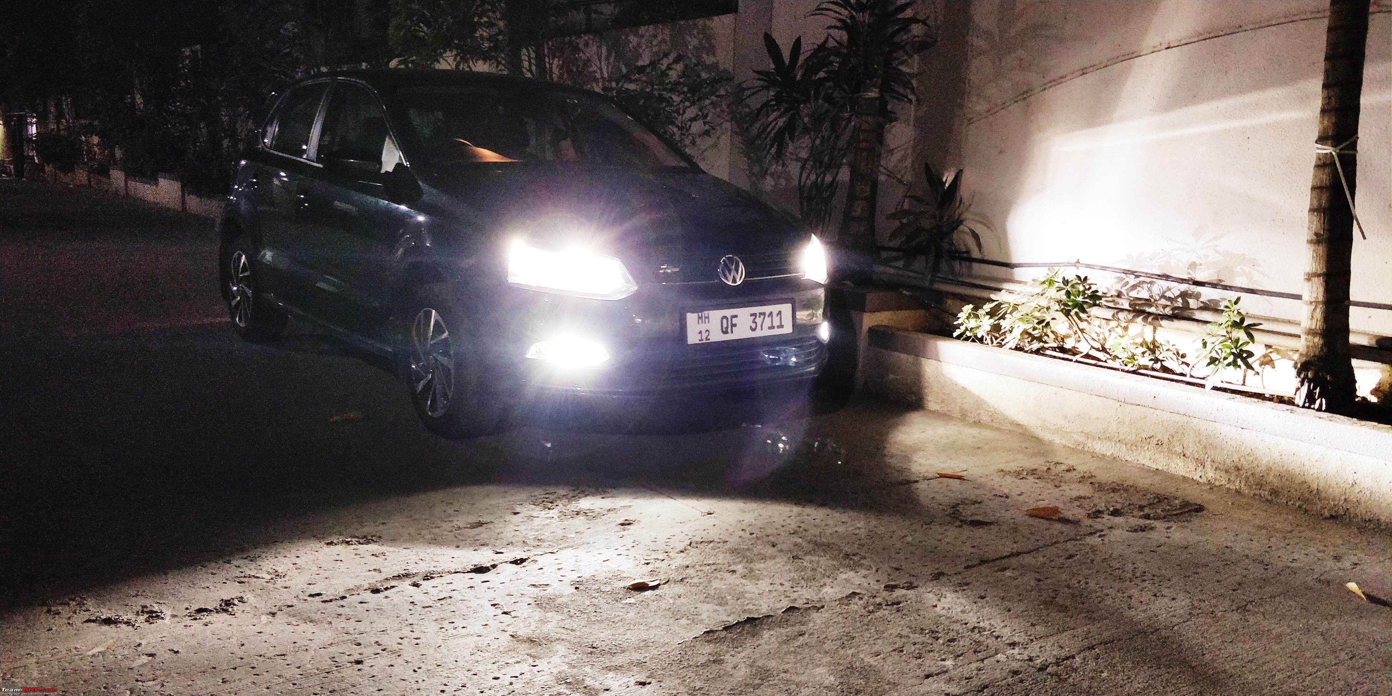

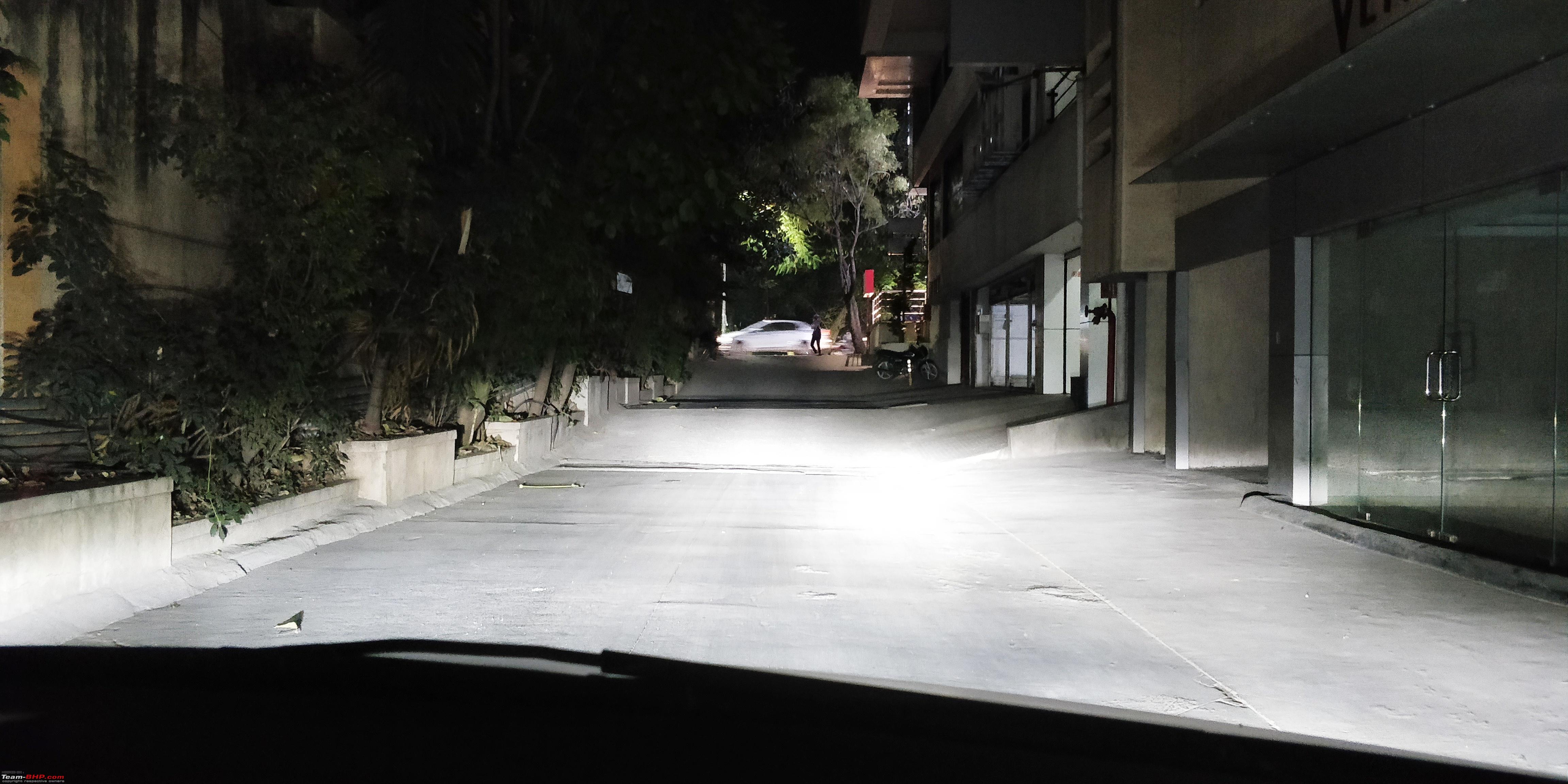

The Result
Thanking those fine gentlemen who guided me with this, below are the results and i will speak after you all have seen the images.
Auto Lighting thread : Post all queries about automobile lighting here-img_20181208_191410__01.jpg
Auto Lighting thread : Post all queries about automobile lighting here-img_20181208_191556__02.jpg
Auto Lighting thread : Post all queries about automobile lighting here-img_20181209_210551__01.jpg
Auto Lighting thread : Post all queries about automobile lighting here-img_20181209_210605__02.jpg
The lights look absolutely amazing and definitely makes head turn as well!
As you can see, the color blend of the APX LEDs & Philips LEDs are 99.9% visibly blending.
The road illumination is much better than halogens & the corners too are well illuminated.
