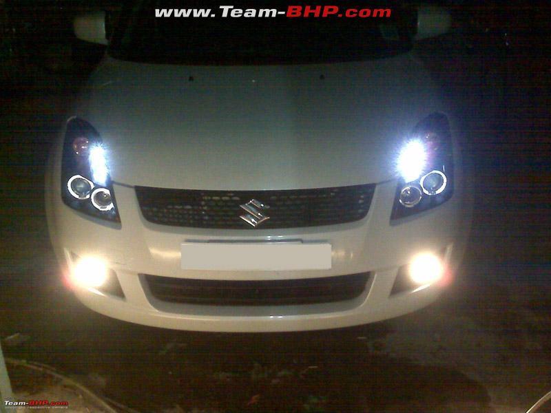

I would like to know if Hyundai i10's have projector headlamp kits? I asked so because I have seen umpteen no. of Swifts with such headlamps (like the ones in a Beamer 7 series)! Could you guys get me more info on this and this is the look I want. Got it from the BHP Garage!
Also are there any aftermarket tail lamp kits for i10 that give it the look of an Audi tail lamp, I meant the ones that have LEDs in them?
Also could anyone tell me if I'll have cop trouble if I change the stock head lamp & tail lamp assembly?
And as I said earlier I won't be upgrading the stock lamps for an year or so!! Pockets have holes in them!! lol: This is just to satisfy my curiosity!!
There's a thread here already ullal .
