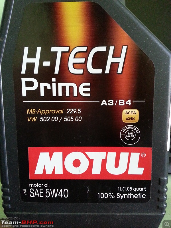

Here anyone had any expereince with Motul HTech Prime 5W40 synthetic oil?
I filled it in my Swift K12 for its third service, and the engine became very sluggish! It was surprising. It cost me Rs2800/- for 3 liters (in 1 liter cans). The condition didn't improve even after couple of long drives and so i drained the oil and since i didn't want to spend on another synthetic so soon again i got the engine filled with regular mineral oil (AC Delco) and all was back to normal, it wasn't sluggish anymore.
I'm not the only one with this problem with this particular oil. A friend put Motul HTech Prime 5W40 in his 2007 Esteem with the car showing same sluggishness. He's still running on this oil and hasn't changed it yet.
Motul makes good oils but what could be the reason here?
With Shell Helix Ultra 5W40 or Mobil 1 0W40 that we have used between us we never had a sluggish engine or anything to complain about.

Hey Sankar,
It could be a case of spurious oil since this oil isn't supposedly available in India. In terms of a car oil with viscosity rating of 5W40, the best bet from Motul is X-cess on the Indian website.
Secondly, a look at the spec-sheets & there are slight differences between the viscosities of the 3 oils mentioned in your post, namely H-Tech, Helix Ultra & Mobil 1.
I believe that the slightly higher viscosity of H-Tech as compared to the other two oils is to blame here, since my personal experience with engines recommending 5W30 oils is that they work best with thin/light oils.
As for your friend's Esteem, is the sluggishness in his car also in terms of a comparison being drawn with Helix Ultra & Mobil 1? If yes, then the same reasoning could apply there.

Hi Guys, i bought this oil from a well reputed oil shop in Tvm, i have bought other mineral and synthetic oils from them in the past and have had no complaints. This shop is frequented by other bhpians too and have not heard anything bad about the shop from them either. I don't think they sell spurious oils and moreover Motul isn't a fast moving brand like castrol and may not be a favourite of the fake industry.
This oil isn't listed in the India website, i wonder why, but the label shows that its imported and sold through the proper channel. Pics:

Blackfire, Yes the sluggishness in the Esteem is being compared with Mobil1 which got replaced with Motul. Before Mobil1 the Esteem was running on Helix Ultra. The viscosity part you have mentioned is also correct, comparing the data sheet of Mobil1 0W40 and HTech Prime 5W40 the latter is slightly more viscous but only marginally. I didn't get the spec sheet of Helix Ultra.
