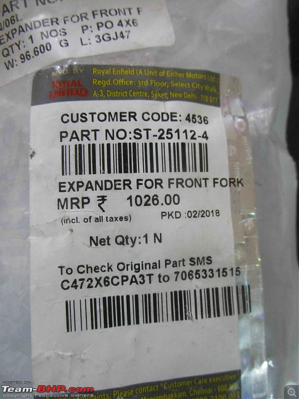

Thank you Alok. Actually it is not only the T-Spanner that matters, the fork seal extractor is equally important to remove the oil seals without damaging the fork down tube. I brought all the necessary special tools for fork service from Royal Enfield part store, the details as below (including part number and price).

Expander for oil seal - Used while inserting the fork rod into the down tube - again not a must
DIY Service: Royal Enfield-expander-front-fork.jpg
DIY Service: Royal Enfield-expander-front-fork1.jpg
regards adrian
