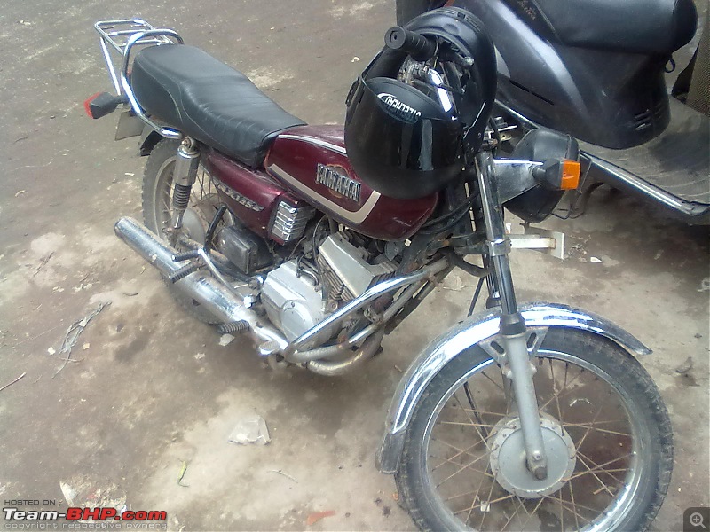

Pics of before and work in progress

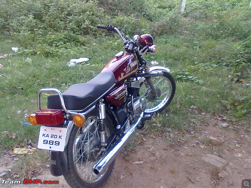

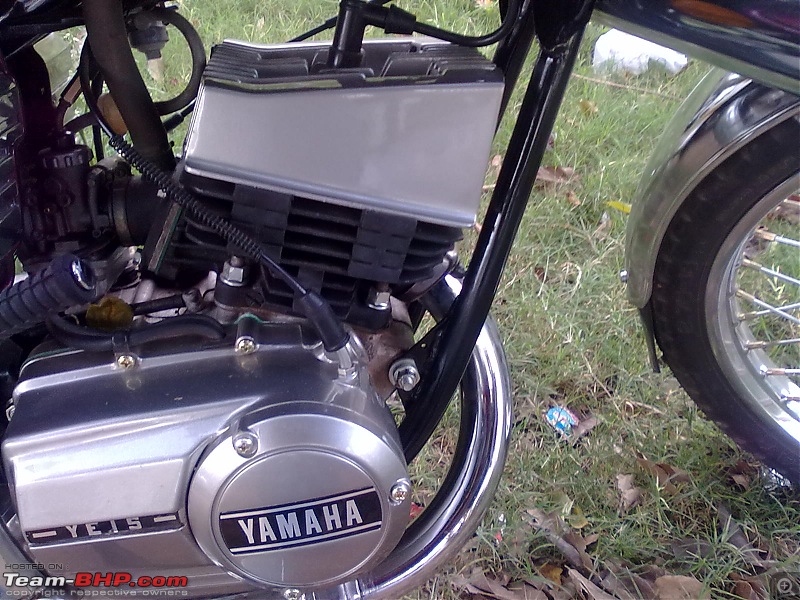

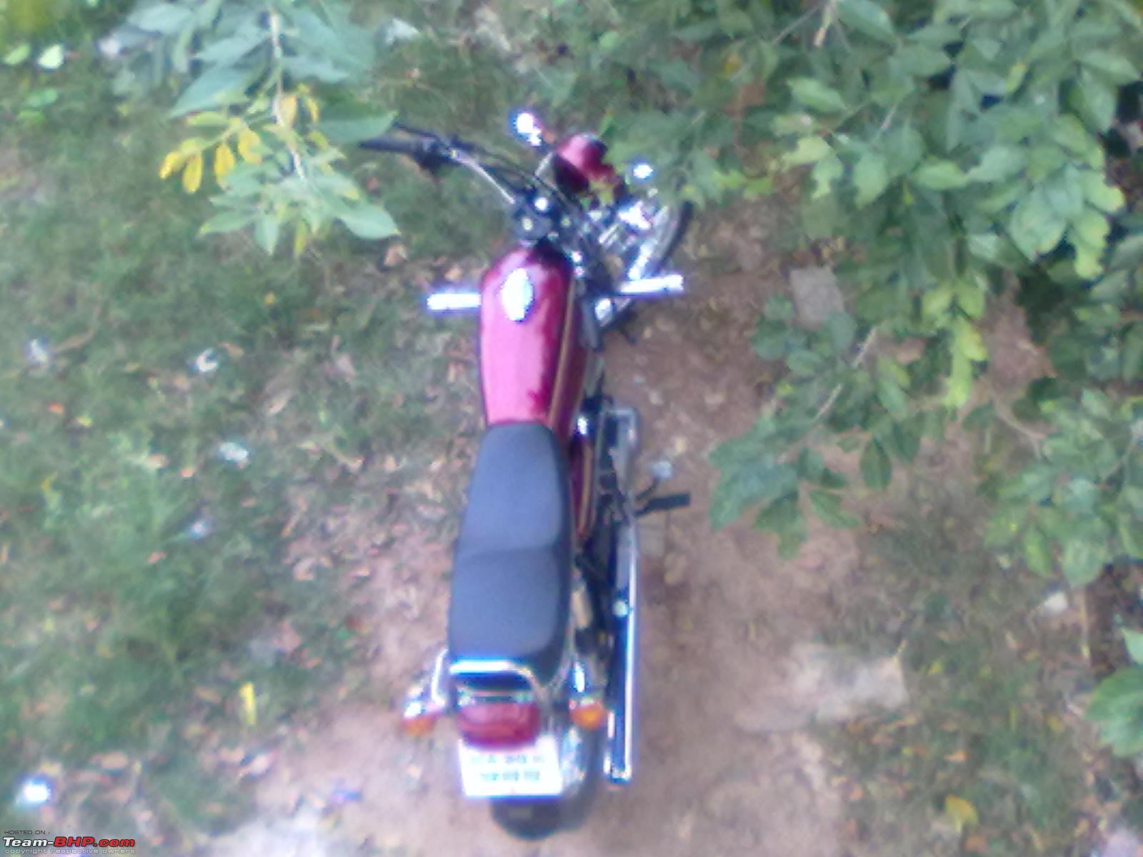

Finally found time to click some pics, would expect you all to comment one the final outcome, also some suggestion will be of great help.

Nice colour on the machine. The typical red!

Nice restoration, painting looks good. Any reason why you have taken off the speedometer console? Appears a bit gross in that area coupled with the non standard head light stays
Job seems to be well done and congrats for your ride.
