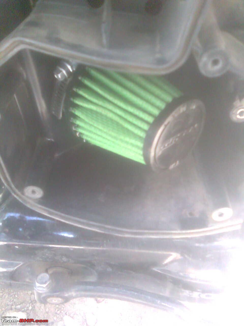

I have a Green Hi performance Air Filter installed on my 2010 Dio and the carb has been tuned to Rich AFR.So far so good
