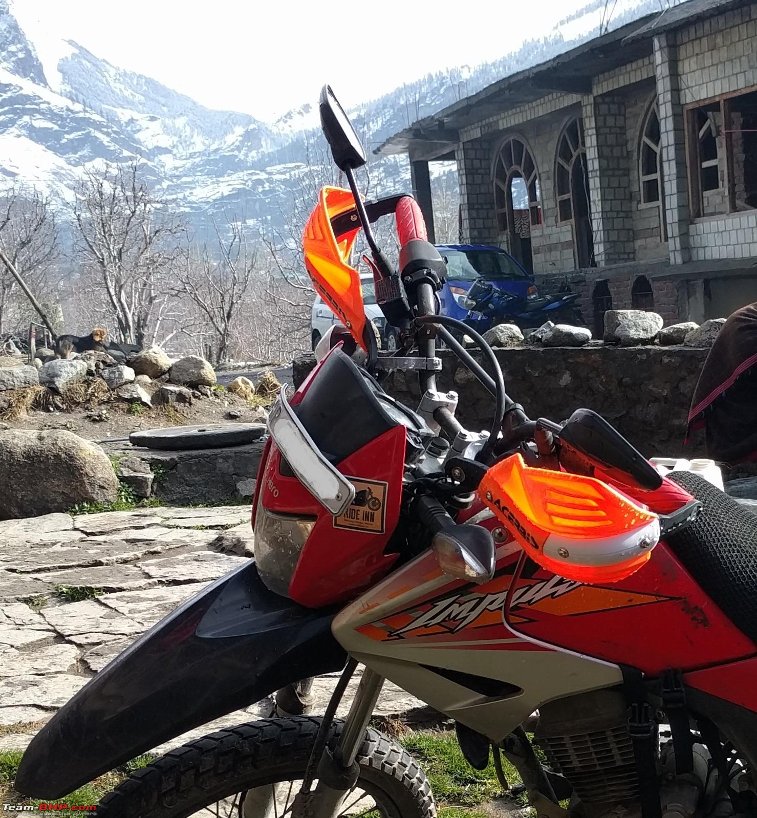

The latest addition...
Replacing the KB-RTZ offroad specials - My Hero Impulse-img_20170317_08544501.jpeg
Picked these up over the winter in Mizoram... where there are a LOT of excellent bike accessories shops...
Bolted right on with no adjustments / interference issues.
The handguards have plastic spines vs. the aluminum-framed Acerbis of otherwise identical design I found online from suppliers abroad (which cost many thousands)...
But the quality is nice, and if they're fakes, they seem to be good ones. Rs1,300 seems a reasonable price to pay for warmer / drier hands, some protection from brush (yes, useful for entering my parking daily) and some added visibility.
I'd kind of been searching for red ones to match the bike, but as it turns out, these match my new hi-viz AFX helmet perfectly... I get a lot of compliments on both, and they actually seem to complement the red bodywork.
Replacing the KB-RTZ offroad specials - My Hero Impulse-img_20170617_220822.jpg
The retina-burning colors certainly can't hurt safety-wise; there is no doubt that people can see me coming down the road now.
Since 2017-onward bikes are full-time headlight on, we have a lot of additional help with two-wheeler visibility (and happily I can ride with mine on all the time, as I have for years, in the confidence that before long I won't have every third person along the road signaling me that my light is on... (yes, I know, thank you very much, I am just some idiot who's a bit ahead of my time).
So speaking of that, I've swapped in a 55/65W OSRAM halogen recently (that I'd taken out of the Marshal at some point and which shares an identical mount), which really is a HUGE improvement at night - about the best bang-for-the-buck I've spent on this bike. Flash-to-pass still functions as it should, so stator is apparently of sufficient capacity for both filaments to be lit simultaneously. And so far no melting of my reflector. I also have a 40W LED unit brought from abroad that I'll probably install when I have time, which should be simply brilliant.
-Eric

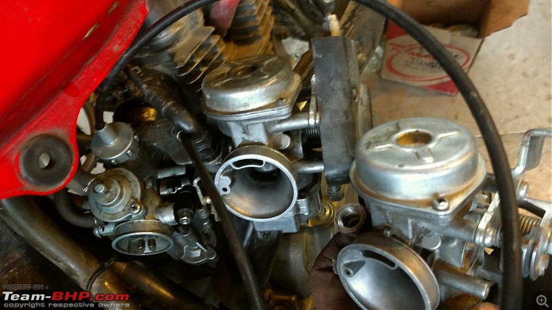

Secondly, a little Impulse tech:
Replacing the KB-RTZ offroad specials - My Hero Impulse-img_20170628_184945.jpg
(Right to left: The original 28mm Keihin CV, the Honda Unicorn Keihin 25/6mm, and the old-model CBZ Keihin, with accelerator pump)
The bike had always been a bit of a fair-weather friend:
1. First, vs. the old KB (which would fire on the first kick after sitting for months), the Impulse never wanted to start after being left anything more than a few weeks in the cold weather; and it wasn't the battery... the carb just wouldn't fuel the engine for some odd reason, and I'd either have to pour some petrol in the sparkplug hole or push-start it down a long hill to get it running. Serious PITA, to say the least.
2. In the rain, the rear brake shoes get extremely sticky and lock suddenly on light application... and they don't unlock when releasing the pedal, either, or until the bike is rolled backwards a few inches - very dangerous, a good way to get rear-ended out on the road, or to loose control on slippery/loose surfaces. Springs and linkage fine - it seems to be an issue of lining material.
3. The ceaseless splashing of mud/water onto pantlegs on wet roads (due to high mudguard).
4. And lastly (and most infuriatingly / irritatingly), the apparently common issue of the carb slide sticking in the closed position in any kind of damp weather (monsoon, clouds at Rohtang, sometimes even just cold temps that cause condensation, etc.
I'll just be addressing the last one here, and will start by saying that only solutions on-road were either a swift-kick to the side cover to knock it loose again, or else opening the intake pipe and physically pushing it up. Either of these "solutions" was effective for as little as ten seconds, so suffice it to say, a one-hour trip in the rain could be a real pain. Polishing the slide / installing a new slide didn't fix it, and warranty ran out last month (showroom an hour away, and didn't feel like running there in the rain when it was manifesting, nor spending days down there watching them try and resolve it in dry weather, only to see it re-appear.
Two things here:
1) the original 28mm Keihin CV carb seems to be oversized for a mildly tuned 150cc (foreign-market CRF150F's use only a 24mm non-CV, and Pulsars/FZ's, etc, are using 26mm CV's and have more hp than the Impulse),
2) I think Keihin was pushing their design limits towards cost-cutting, and being that both their 28mm and 25/6mm carbs use almost the same exact carb body and same sized piston, it's evident that there's a lot less material supporting the piston when used in the bigger-venturi 28mm carb... What I can ascertain is that in high-vacuum, off-throttle conditions (coasting / decelerating), the lower half of the piston, being so ill-supported in its bore, gets pulled forward and "cock-ed" slightly, jamming it against the leading upper edge of the venturi. Hope this makes some sense...
To be cont'd...

The bike had, moreover, run terribly at altitude in stock form. I'd managed to get it tuned to where it ran pretty well, but it still had its hiccups - occasionally backfiring through the carb, or manifesting weird effects on full-throttle roll-offs. Power also tended to go completely flat under about 3,500 to 4,000rpm, requiring downshifts on gradients.
They say that CV's are more tolerant of over-sizing than non-CV carbs (since the slide itself can't be snapped open, causing bogging - it's controlled by vacuum, and won't open till the pressure differential on either side is "right"). But I figured the 28mm was probably running the slide only very slightly open much of the time, which is not really where it's probably designed to operate best.
I'd picked up an old-model CBZ carb at the scrapyard a couple years ago, just kind of waiting for my warranty to expire so I could play around a little... he, he Think I paid around Rs100 for it...
Replacing the KB-RTZ offroad specials - My Hero Impulse-img_20170622_174337.jpg
I remember riding one of those bikes several years ago, and taking note of its better-than-average performance and responsiveness. This despite its having a half-horsepower less than the Impulse at about the same weight. People have attributed this to the accelerator-equipped carb, and I've been wanting to test the theory.
Note in the photos that the venturi is considerably smaller, though on the engine side the opening measures 26mm.
Replacing the KB-RTZ offroad specials - My Hero Impulse-img_20170628_184937.jpg
I spent a couple hours yesterday making an adapter that would allow me to bolt it up directly to the original connector:
Replacing the KB-RTZ offroad specials - My Hero Impulse-img_20170628_192918.jpg
Carb was cleaned up fully inside and out (fully disassembled):
Replacing the KB-RTZ offroad specials - My Hero Impulse-img_20170622_181225.jpg
And upon installation I gave it a try. I'm going to have to order the double accelerator cable, and maybe a 40mm cone/pod type filter, which should fit okay under the side cover. Managed some jugaad with my old KB cable just for stationary testing and it seems to run (idle/respond/rev) well, but let's see how it does out on the road.
And let's see how my fuel economy is affected (not a strong point of early CBZ's). I'd have to give up the throttle position sensor in the process, unless I can find a way to activate it using the existing linkages... which will be tricky as in the absence of a throttle-shaft, there's nothing turning on the left-side of the carb where it would have to be (on the right side, it would send its signals reversed).
Most likely its main purpose is to cut the ignition advance a bit under certain throttle conditions (to prevent detonation, to improve emissions under certain conditions, etc). I've run the bike with it disconnected earlier and could tell no difference in performance, but let's see.
Meanwhile, I'm running the Unicorn carb on its stock jetting, with the Impulse slide-spring and piston (which has bigger vacuum ports in the bottom, probably lending itself to quicker responsiveness).
Preliminarily, I can say that the bike runs better at low revs now - even as low as 2,500rpm it'll pull and transition smoothly. It's equally (or more) responsive, and seems to rev a little less happily to 8,000rpm (I think the 28mm could pull pretty well to 8,500 or more) - all of which I guess is what one would expect. Best thing being that it doesn't stick in the rain anymore (have done plenty of wet riding the past two days).
More later,
