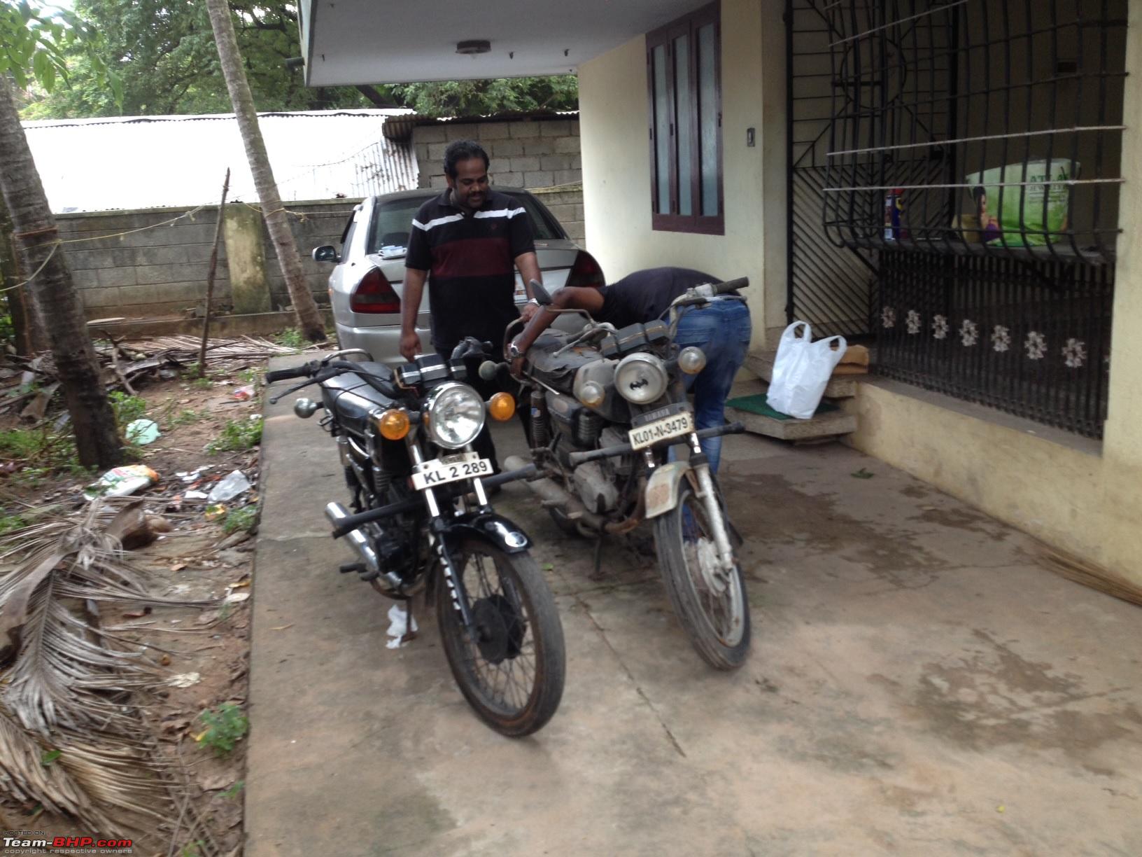

A closer look to see what i got myself into
It was all crazy, the other RX is mine, which is before the build.

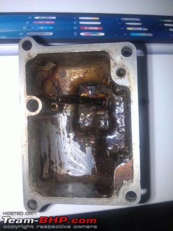

But got stuck when opened the carburator(we started the bike with my rx 100 carburator)
there was 7 years of gunk. Then tinu swang in to action and cleaned the entire carburator

One of the latest pics of the tiger.
Another Yamaha RX build...wait, this time it’s different-10552475_10202901070433380_8071663908532877956_n.jpg
We are yet to do a proper photoshoot of both the bikes.
Pramod
