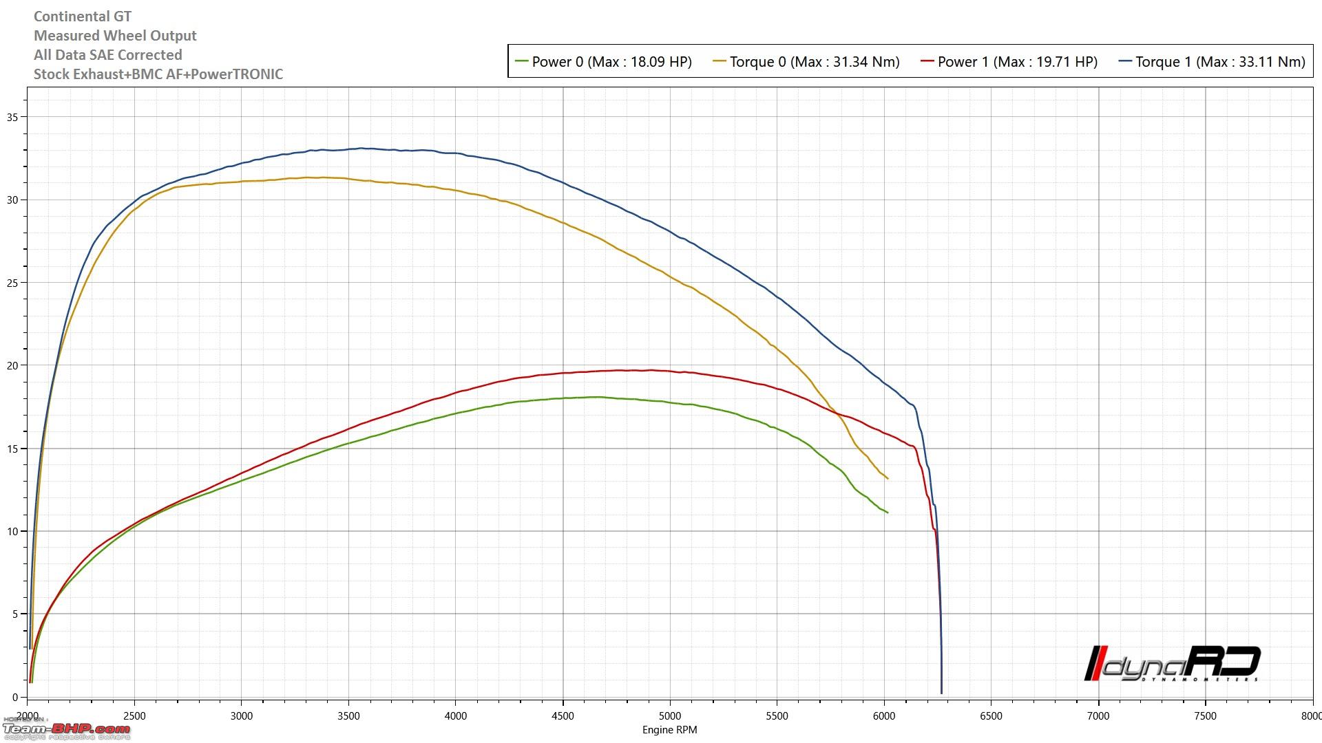

I reached out to the Race Dynamics team and they told me that there are two versions of the PowerTRONICS ECU that are available right now. The older one is the regular one for Rs 15,000 and the newer one comes with the addition of Traction Control and costs Rs 18,000. Also they are willing to dyno test each customer’s bike before and after the PowerTRONICS installation to show real world benefits as compared to other tuners who require you to imagine actual gains without really showing it to you scientifically.
They have also shared dyno graphs for three different combinations to show the gains that their ECU brings to the table
1. Stock bike vs Stock bike with PowerTRONICS
2. Stock bike vs Stock bike with a BMC air filter and PowerTRONICS
3. Stock bike vs Stock bike with a BMC air filter and PowerTRONICS and a Red Rooster Performance exhaust
I am sharing these dyno graphs with their permission.

Neil, can you help interpret the graphs, to me the gains seem minimal, couple of NM of torque and about a BHP.
I have two of the tuning boxes for my diesel vehicles and I am happy with them. I have been using for more than three years now.
But my riding style of GT results in typical RPM of 2000-2500 in the city and 2500-3200 or so in the highways. I find from the graphs that the increase in the torque or power at those highways are not considerable, not even 10%. For someone who rides upwards of 3500 rpm the box should make a difference. But for me I am not sure if it will be helpful.

Sumithb, Im no expert but to me the key things to keep in mind are
1. How much do you gain – In absolute numbers, the PowerTRONICS unit gives you a 4% bump in power on a stock bike, almost 9% if you have a BMC air filter added and 4.7% if you have the filter and a RRP exhaust. Your torque gains are highest with the third option.
2. Where are you seeing the gains - Arulpeem has explained it very well. I tend to to use the bike between 2000 – 3750 RPM in the city and on the highways the rev range goes up (trying to keep up with these darn fleet footed TBHP riders on quicker bikes!). But the maximum gains are between 5500 – 6000 RPM so the question is how often are you going to be riding in that range to make full use of the peak benefits?
That said, the combination of the PowerTRONICS and BMC air filter seems to offer more usable output but many riders are not comfortable with adding an after market filter due to the long term effects especially in a country like ours.
Don’t forget that Race Dynamics will help custom tune your map as per your requirements so a left shift in the benefits is easily possible and that is their trump card.

Those were my same impressions arulpeem. As a direct fit, the PowerTRONICS unit may not suit my needs exactly. But with a little time spent in getting the map tailor made for my usage, it should prove to be a VFM investment.
