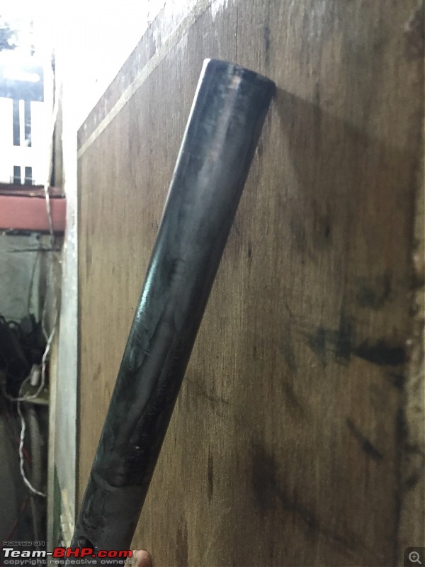

Despite the last KTM handlebar angle correction (which definitely made things better), I still had a niggling doubt in my mind that it was off ever so slightly. So I took it to Raymond's garage to see if it was just my mind playing tricks on me or if something was actually wrong. After removing the KTM handlebar and checking it thoroughly, he found that the bar actually wasnt perfect with the two bends in the middle certainly not matching each other. Add the slight adjustments done to the left side to set the alignment (detailed in post 341) and the end result was that when the handlebar was placed against a flat wooden board with one end falling on the board correctly, the other end stuck out by more than the width of my thumb! So it turned out that I wasnt imagining the issue after all.
Royal Enfield Continental GT 535 : Ownership Review (32,000 km and 9 years)-1.jpg
One end placed flat ....
Royal Enfield Continental GT 535 : Ownership Review (32,000 km and 9 years)-2.jpg
.... and the other end sticking out by more than a sore thumb!
Royal Enfield Continental GT 535 : Ownership Review (32,000 km and 9 years)-3.jpg
Royal Enfield Continental GT 535 : Ownership Review (32,000 km and 9 years)-4.jpg
I wonder how such a part passed the KTM QC check! Anyways we dumped the faulty handlebar and got a new KTM one instead hoping that this would sort things out once and for all. While picking up the bike though, Raymond mentioned that there seemed to be a slight alignment issue between the tires which hinted at a potential rear swing arm bend. The new handlebar was a welcome relief and a short ride to Vijayapura the following weekend with the group of Team BHP bikers was a good opportunity for me to check for this potential wheel alignment issue that I hadn’t noticed earlier.

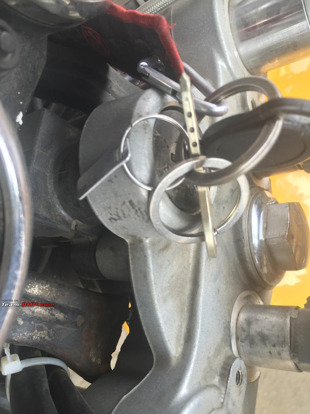

With the handlebar and alignment issues sorted out, it finally looked as though everything was set for smooth sailing but there was one little twist in the tale that took its time to reveal itself. After a few days of commuting to work, I realised that there was a rattling sound coming from the twin pods and after a little poking and prodding behind the visor I found that the left side of the clamp which held the speedo console was actually rusted and had broken. Sigh! All part of the Royal Enfield ownership experience... :Frustrati
Royal Enfield Continental GT 535 : Ownership Review (32,000 km and 9 years)-img_3409-large.jpg
Royal Enfield Continental GT 535 : Ownership Review (32,000 km and 9 years)-img_3412-large.jpg
Notice the paint peeling and the crack
Anyways, I had suggested to Raymond that we knock off a couple of millimeters from both sides of the clamp to keep a gap between the console and the Givi windscreen which touch at the base of the speedo. Over time this has left a bit of a sore spot on the visor. Thanks to some good old fashioned human laziness, it took a couple of days for the welder to get round to actually starting the work but I wanted to sort everything out (tightening, rerouting of the wiring and the welding) before the planned weekend breakfast ride and so I got all the pending work finished by Friday.

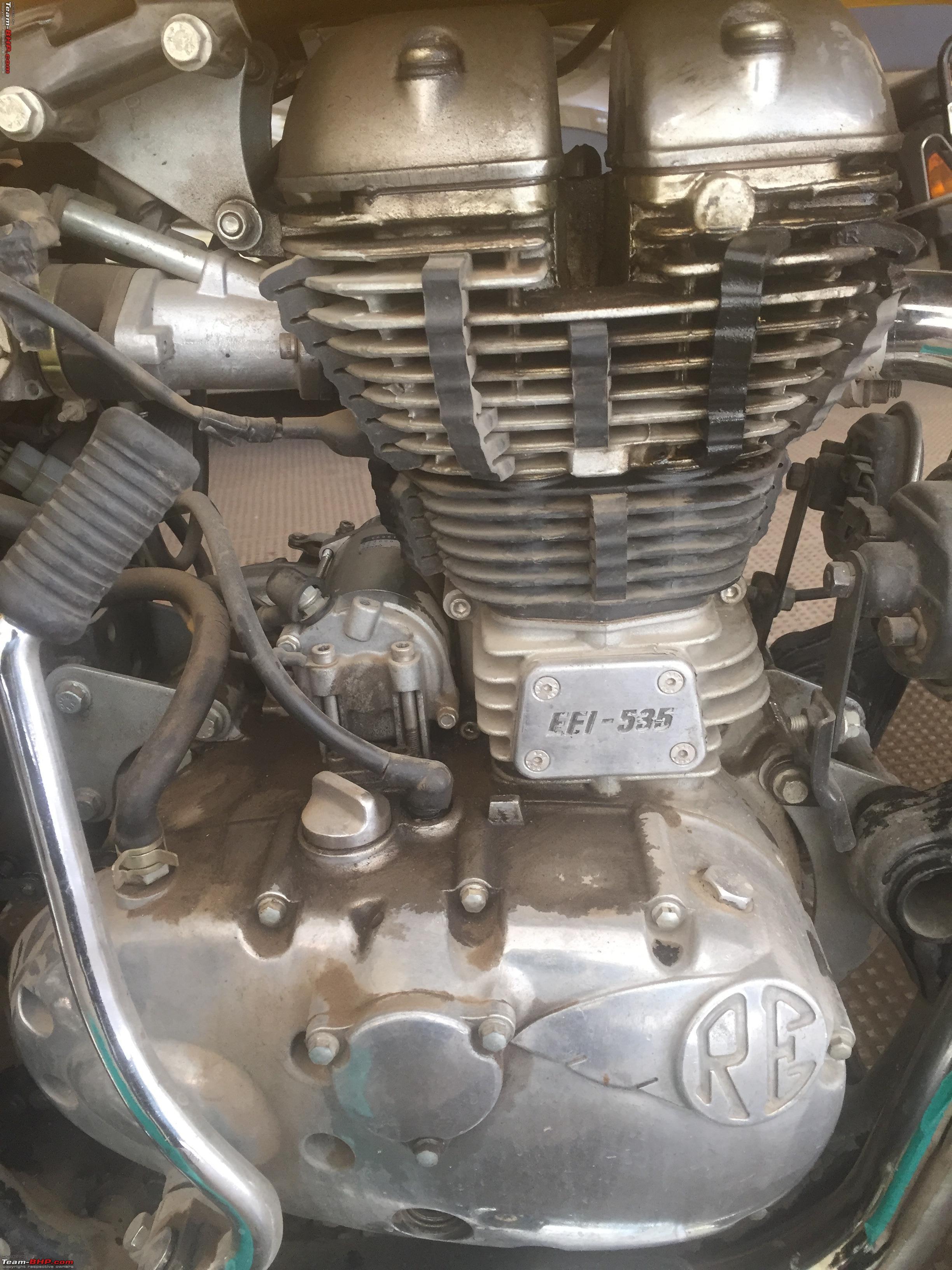

With a shade of 13,600 on the odometer, the bike is starting to feel like it needs a service to get a couple of things sorted out and be in tip top shape. In no particular order
- The brakes : Despite getting them bled recently, the front braking has gone back to feeling 'spongy' at best. It does it's job no doubt but that ability to stop on a dime has gone missing somewhere along the way. Ive again started using a lot more of the rear brake, especially in my city commute, over the last couple of months and they like to gently coax the bike to a stop rather than instructing it to halt immediately. I strongly suspect the pads at the rear might have to be changed at the next service.
- The engine : I just emptied 400 ml of engine oil into the bike after seeing how much it was leaking while being unused. There's a bit of investigating to be done as this seems to be quite abnormal. And to think I used to give my Pulsar 150 (the original one) flak for its build quality!
- The gearbox : Finding neutral these days is becoming tougher than finding a manager in an IT company who will guarantee you a good year end bonus. Even with my A* boots I just cant shift from 1st to neutral unless I switch off my bike. I'm not sure if anything can be done about it though but it's worth checking with the service centre.
As I mentioned in my last post, when I do use the bike for the office commute, the terrible traffic is a major buzzkill. Recently I spent a total of 3 hours just commuting to and from work and while returning in the late evening, I was switching off the bike at Bangalore's infamously long signals. The bike had some trouble starting a couple of times and then finally refused to start which I think could be because of the overheating (cant think of another scientific explanation). I pushed it to the side and after a few minutes tried my luck and fortunately it started without a hitch. The problem hasn't reappeared since. Any ideas on what could have been the issue?
As far as the riding experience goes though, other than the minor flaws listed earlier and the one instance of refusing to start up, the Continental GT is proving to be a really good package. Our recent ride to Krishnagiri was testament to this with the bike behaving just perfectly. Here are more pictures cause well we all need a little more Continental GT in our lives.

I'm not sure why you needed to add 400 ml of oil to the engine.
I must have missed it but, are there any major leaks causing oil to accumulate under the motorcycle or covering large areas of the engine? If so, have your mechanic address the leak.
If there is no visible leak, you should not need to add any oil assuming the oil was filled to the proper level at the last oil change.
Thanks for that informative post ArizonaJim. The oil leak on the right side of the engine is quite noticeable. Im not sure how much the Motul fully synthetic engine oil has to do with it though, the 300V is not reputed to be the best choice for such motorcycles. I finally got around to taking a few pictures last weekend while giving the bike a proper wash.
Royal Enfield Continental GT 535 : Ownership Review (32,000 km and 9 years)-img_3925.jpg
I was dismayed to find that the rubber pipes are again cracking and will most certainly have to be replaced immediately. There is no real excuse for such poor quality components on a motorcycle priced at this level. Today I realized that the breather pipe (which has been replaced once before) had almost completely broken off at the end.
