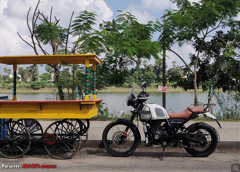

An update after ages:
My bike has ran 15k so far in the past 1.5 years. Life is keeping me busy, and priorities have changed a bit, so bike is used only for office runs, and weekly late night short rides in and around city. Construction of metro rail, and rainwater drain by corporation have made Chennai roads a nightmare. Thankfully the suspension of Himalayan is proving to be a boon on non existent roads. There are no issues with bike so far, and am consistently getting around 30kmpl during office commutes.
It was time for rear tyre change, so went ahead with MRF Meteors this time based on various reviews for my use case, and suggestion by @shyamg28.
Changed tyres and did a general checkup at my trusty FNG.
Cheers!
