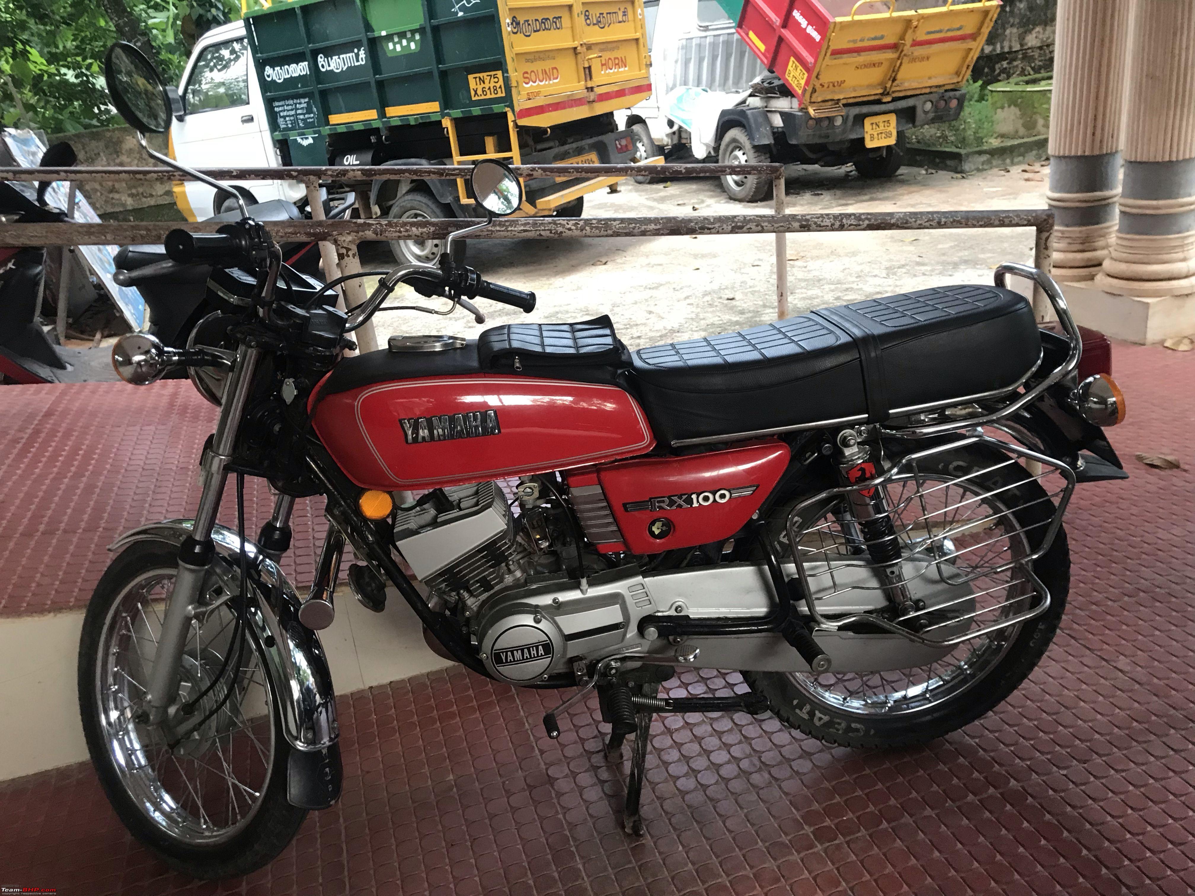

Originally Posted by Mr.Boss (Post 5187529)
You missed the missing black ring & YEIS in engine case, later gen chain guard, different colored RVMs
You're right, I didn't post on the rings & YEIS as I had my own doubts. RVM were always Black Alfa Toyo from my observation
Congrats, Drool worthy stuff :thumbs up
Do post some day light snaps,
You missed the missing black ring & YEIS in engine case, later gen chain guard, different colored RVMs, missing fuel filter :D
Any specific reason? Or something bigger and better is on the way?
You have an eye for detail Boss :thumbs up I never realised the black ring and YEIS stickers are missing. will get them added on the weekend. Do you have a pis of the original chain guard? The mirror's yes - So the chrome mirrors I ordered were both sent for the RHS. So the old mirrors were titled on the LHS.
Will post day time pics tomorrow.
The black ring is missing, but there's a plain black sticker on the crankcase & you've it as YEIS. The Rx100 came with black plain sticker & Rx135 had YEIS on it
The original one had the inspection window on the top; from my experience it's extremely difficult to source the original chain guard.
Here you go...
Yamaha RX100: Retro-Modern modifications (back to stock)-c46dd791b6eb9dc1c5d104ab46ec2c89.jpg
And you could be missing a fuel filter + neutral rubber cover as well :D
Seriously you guys have a sharp eye for details. These are sone of the things that I would not have and didn't notice at all.
Please do let me know what else is missing and will order them.
Thank you very much guys!! From the heart!
