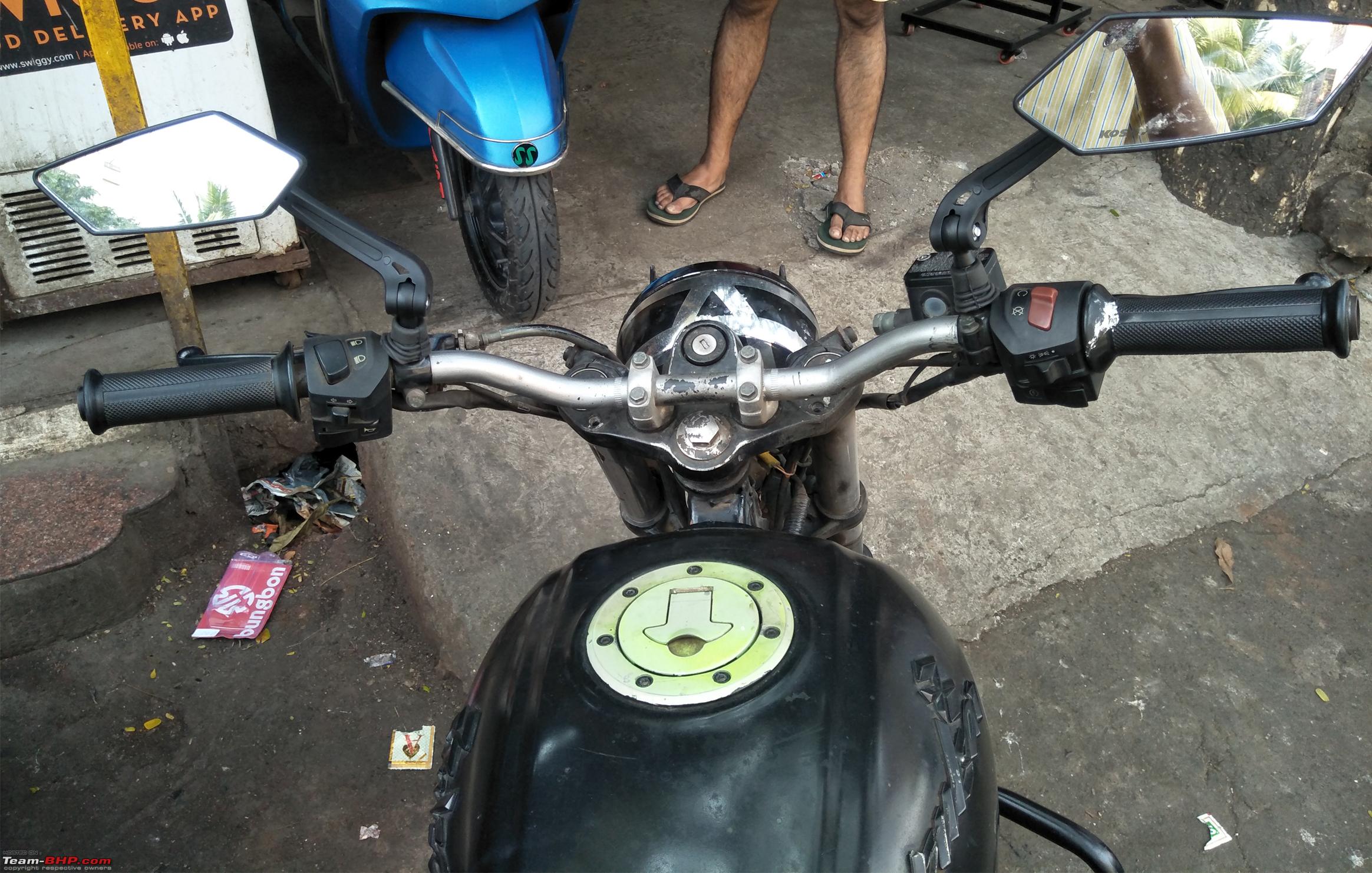

Koso Mirrors and Activa mirror boot rubber (cut), temporary fitment since they vibrate more than I expected.

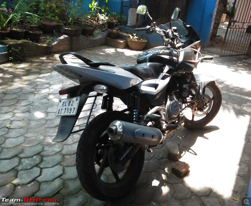

My Bajaj Pulsar 220 DTS-i : 7 years of ownership, experiments & ride-break-fix-repeat-old-ceats.jpg

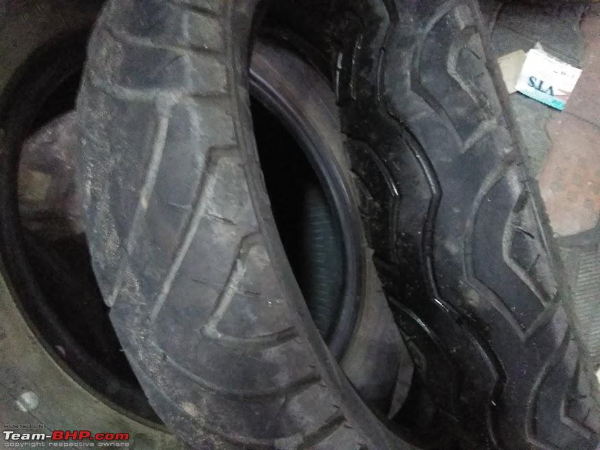

So I've got a pair of MRF Masseter's in stock size a couple of hours ago and that's all good.
My Bajaj Pulsar 220 DTS-i : 7 years of ownership, experiments & ride-break-fix-repeat-img20190417wa0098.jpg
My Bajaj Pulsar 220 DTS-i : 7 years of ownership, experiments & ride-break-fix-repeat-img20190417wa0099.jpg
My Bajaj Pulsar 220 DTS-i : 7 years of ownership, experiments & ride-break-fix-repeat-img20190417wa0100.jpg
Now even with the weight removed from the rear, day before yesterday while riding back home after dark, I hit a deep jagged edged rut which resulted in the front end being bashed in pretty hard, as a result the front did wobble a bit before regaining composure, though both alloys were fine my rear panel has cracked a bit,
My Bajaj Pulsar 220 DTS-i : 7 years of ownership, experiments & ride-break-fix-repeat-img20190417wa0009.jpg
I've bashed the motorcycle pretty bad in the past and have experienced minor cracks at the mount points but this a first as the part in question is not under stress(with the exception of aftershock), which leads me to believe that the shocks have run their course and needs to be replaced.
As we've discussed in the past I'm contemplating opting for P135 shocks as I believe it would compliment my already raised front and would also transfer weight to the front enabling me to take advantage of the grip'ier tires.
My remaining concern is whether I'd be able to retain using the stock stands in stock form, both kick and main as I'm set out to travel about 2k km's during the coming weekend and carrying a block of wood everywhere I go seems a bit inconvenient.

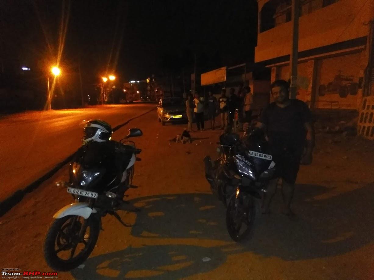

So much so that my first break was after 256 km's of non-stop riding when I crossed over at Thirumangalam from Ghats to Interstate highways.
My Bajaj Pulsar 220 DTS-i : 7 years of ownership, experiments & ride-break-fix-repeat-img_20190420_095841.jpg
But that's where the disappointment started she was hitting the brick wall at 110~115 kmph similar to how a ZMA would perform, I presumed she was running rich but the issue turned out to be the RTR Plug's I'd been using which were crazy hot at 6 heat range, a friend and fellow enthusiast(Parvez) was the one who diagnosed the issue via WhatsApp and he immediately asked me to meet him when the time was past 1:00 AM at night.
This was our first meeting ever but even before I could finish with the greetings he got down to business and swapped both the Bosch dual electrode RTR plugs with the NGK CR9E's, which is 3 steps colder than the Bosch.
My Bajaj Pulsar 220 DTS-i : 7 years of ownership, experiments & ride-break-fix-repeat-img_20190421_022352.jpg
The willingness of a fellow enthusiast to help out in the middle of the night really did fill me with pride knowing that the 'Biker/Motorcycling' spirit is still alive and well and has not succumbed to the ways of the social-media-influencers and breakfast-riders alike.
Fun fact is that the R15 owned by Parvez seen in the pic has 1,60,000+ km's on the odo and the motorcycle is still running on factory internals, courtesy of his strict 1.5k oil changes.
Back to topic, the P220 tore up the highways after the plug swap and was doing 130Kmph without breaking a sweat, hence do keep an eye out for the NGK CR9E's, they're hard to source but works wonders on the P220, R15 and R3 all the while costing Rs.67/- per piece.

The Masseter's performed brilliantly, the grip and handling was like something I've never expected from this motorcycle, the pictures would speak for themselves,
My Bajaj Pulsar 220 DTS-i : 7 years of ownership, experiments & ride-break-fix-repeat-img_20190422_163439.jpg
My Bajaj Pulsar 220 DTS-i : 7 years of ownership, experiments & ride-break-fix-repeat-img_20190422_163450.jpg
The only thing holding me back was the usual main-stand which pivoted the rear off a couple of times before I dropped pace;
My Bajaj Pulsar 220 DTS-i : 7 years of ownership, experiments & ride-break-fix-repeat-img_20190422_164008.jpg
Unlike other tires even if you manage to break traction you don't slip to a slide, the tire zaps back even before you realize it.

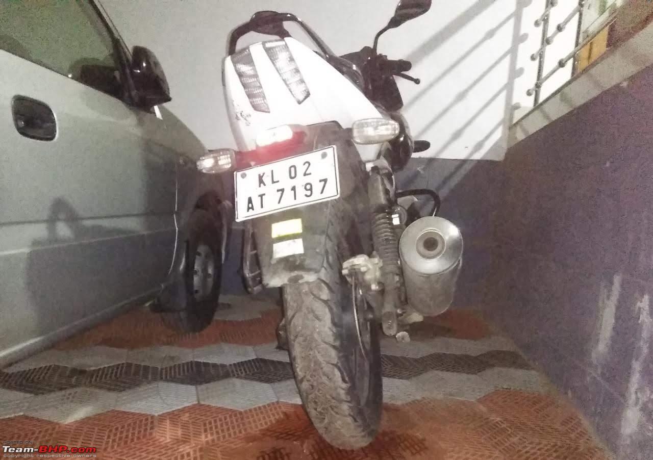

Now, once I got back my hands were twitching and I tried my luck at the Kollam ASC and succeeded.
My Bajaj Pulsar 220 DTS-i : 7 years of ownership, experiments & ride-break-fix-repeat-img20190424wa0013.jpg
Here's a comparo of Stock vs P135 shocks for the benefit of others;
My Bajaj Pulsar 220 DTS-i : 7 years of ownership, experiments & ride-break-fix-repeat-img20190424wa0017.jpg
This is what the motorcycle looks like after the ordeal,
My Bajaj Pulsar 220 DTS-i : 7 years of ownership, experiments & ride-break-fix-repeat-img_20190424_170413.jpg
The severity of the mod is only noticeable from the rear;
My Bajaj Pulsar 220 DTS-i : 7 years of ownership, experiments & ride-break-fix-repeat-img20190424wa0045.jpg
The difference in handling is welcome, even without much effort I can make use of the softer edges of the MCT tire.
Though I do miss the main-stand which was absolutely useless after the mod as it wasn't even touching the ground, the kick-stand didn't need any alteration and worked well for me.
And yeah, the motorcycle does feel like a big bike.

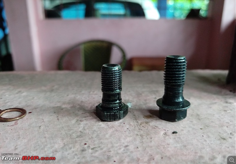

BTW, while changing do notice that the Banjo of the RTR and Pulsar is of different thread design;
My Bajaj Pulsar 220 DTS-i : 7 years of ownership, experiments & ride-break-fix-repeat-imag0010.jpg
On the Left you see Pulsar Banjo and on the Right you see RTR Banjo.
Braking has improved manyfold!
Attachment 1911913
A.P.
